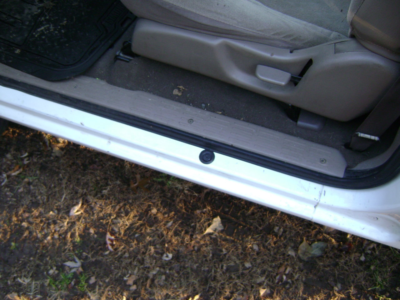

    I dont think first gen tacos have as much of a problem with rocker/cab corner rot out as other trucks. But one of the most common area for body rot is rockers so i drilled 3/4" holes in my rocker to run a 32" wand all the way to the end. I coat the insides so if salt spray does get up in the rocker it cant start rusting from the inside out. There are a series of drain holes in the bottom of the rocker pinch seam to let water out. If i remember right the front gutter drains for third gen 4runner sun roof routs rain water into the rockers. I dont know if extended cab tacos had a sun roof or not but they are probably routed into the rocker too.
    I used a 3/4" hole saw and it was double wall where i drilled in the pic. After drilling the holes i used a small rat tail file and knocked the sharp edge off the holes so it didn't shave plastic off the wand as i pushed and pulled it through. Then get some 3/4" body plugs to stick in the holes to make it look clean and keep dirt from getting in. I filled my rockers up more than i released and it dripped for days it has stopped now though but you can see the marks it left on my driveway.

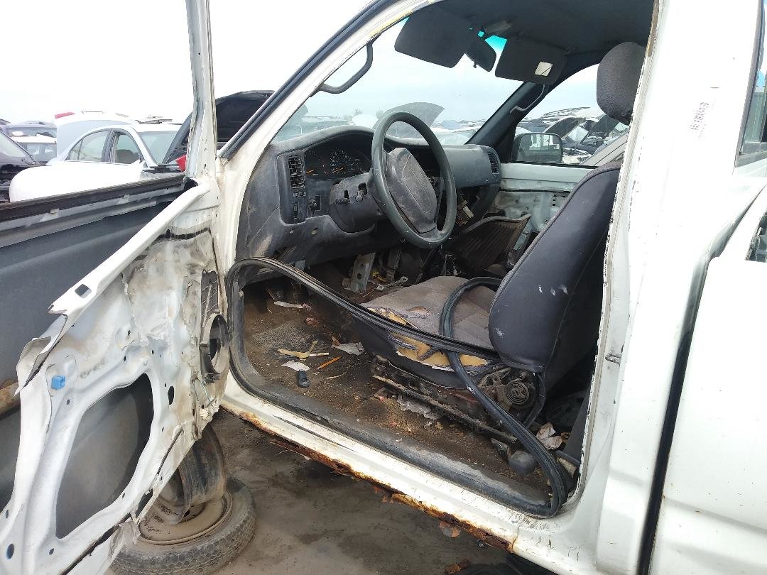

    rockers are the areas on the sides under the cab
    the ones in this pic had seen better days
