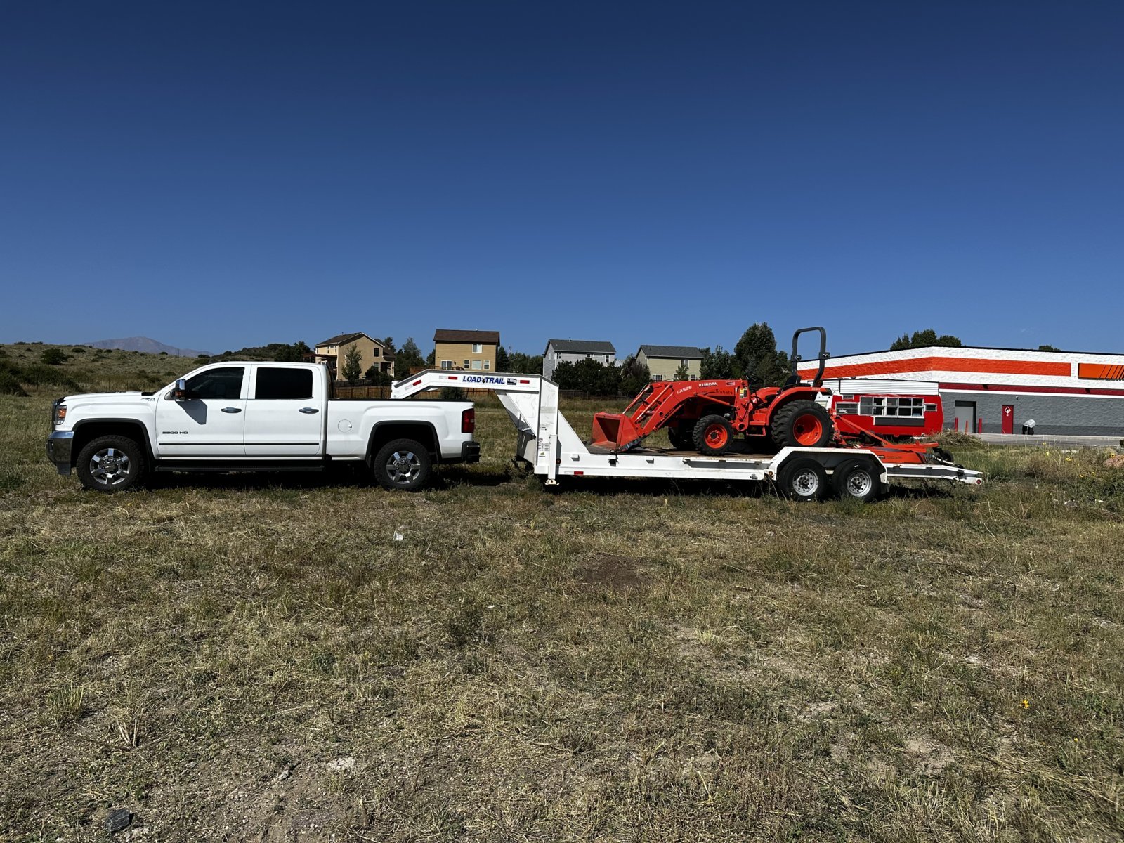

    This is just not a good idea even on private property. Your 1st Gen taco is not designed for any kind of weight like that.
    For instance, the pin weight on my trailer is 1050 empty. When I put my chains, straps, battery/hydraulics in the bins it jumps up another 100 lbs. pretty light for a 24' trailer. So call it 1150 lbs empty. Any kind of load and the pin weight goes up pretty quickly. IMG_2385.jpg
    The 5th wheel hitch you have needs to be on top of the frame rails, and I'm willing to bet it's not even close. This would have to be a total custom job.
    Another option is to cut up a GN hitch, install it between the frame rails, then get a 5th wheel hitch that connects to that. Not sure the bed sheet metal strength is up to the task.
    If I were you, and this is happening on a farm, use a 3 point hitch on a tractor. You will be money ahead.
    https://www.bellprecisiontool.com/product-page/3-point-fifth-wheel-trailer-mover-category-1

    Look at where my pin is in relation to my rear tire. You should be centered or 2" forward of the rear axle.
    The new GMs are doing some kind of voodoo and mounting the hitch 2" behind the rear axle.
