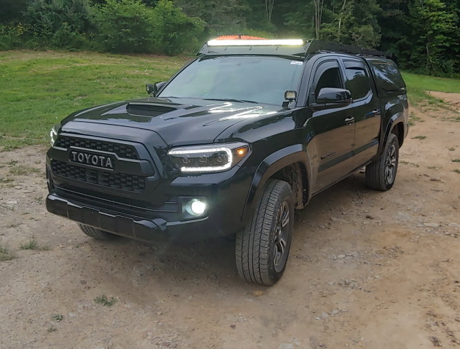

    Roof rack: https://prinsu.com/category/toyota/tacoma/
    There are other vendors that offer roof rack such as UpTop, etc.
    If you have double cab, no drill needed, since there are holes which waterproof tape covered them. So you can punch a hole on each tape.
    Similar to mine:
    There is track in each crossbar.. which means you can mount anything on there such as camera, tent, etc.
