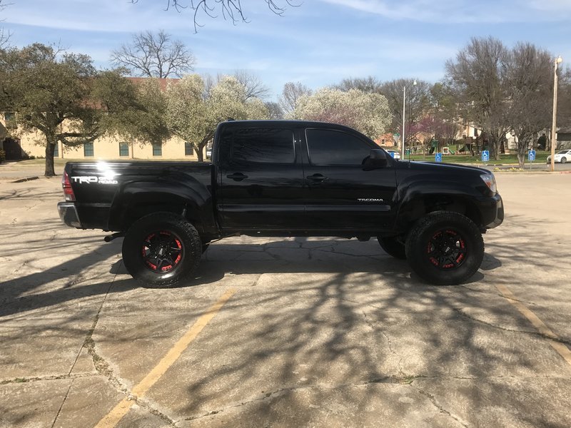

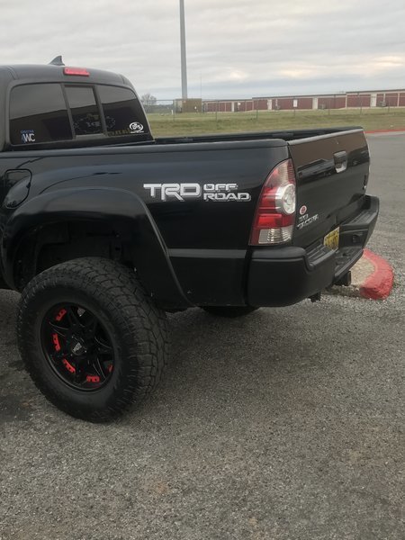

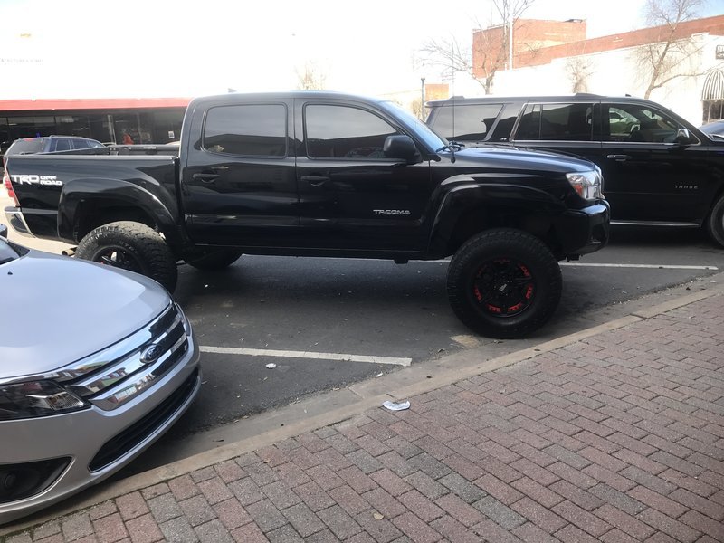

    Most places a 4" lift and a 6" lift run fairly close in price. Like with in $100 or so. I would not go with a cheap Suspension, because they don't have decent warranties or find a way out of them. I would suggest BDS, they are my favorite! This is how my truck sits with a 6" lift on 35sIMG_0654.jpg IMG_0797.jpg IMG_0653.jpg
