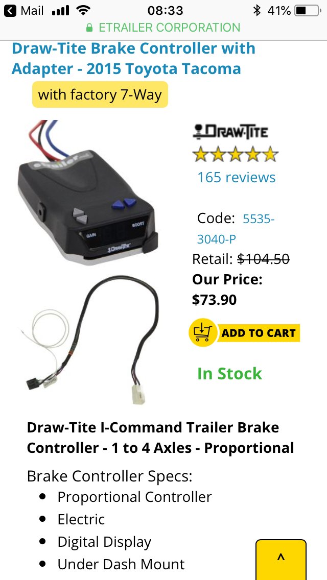

    Look at e trailer. That’s where I got mine. The harness was like $12. Worth it.

    This is what I went to. The one I had before had to be leveled and then the adjustment knobs were difficult to see. This is an awesome swap for me.
