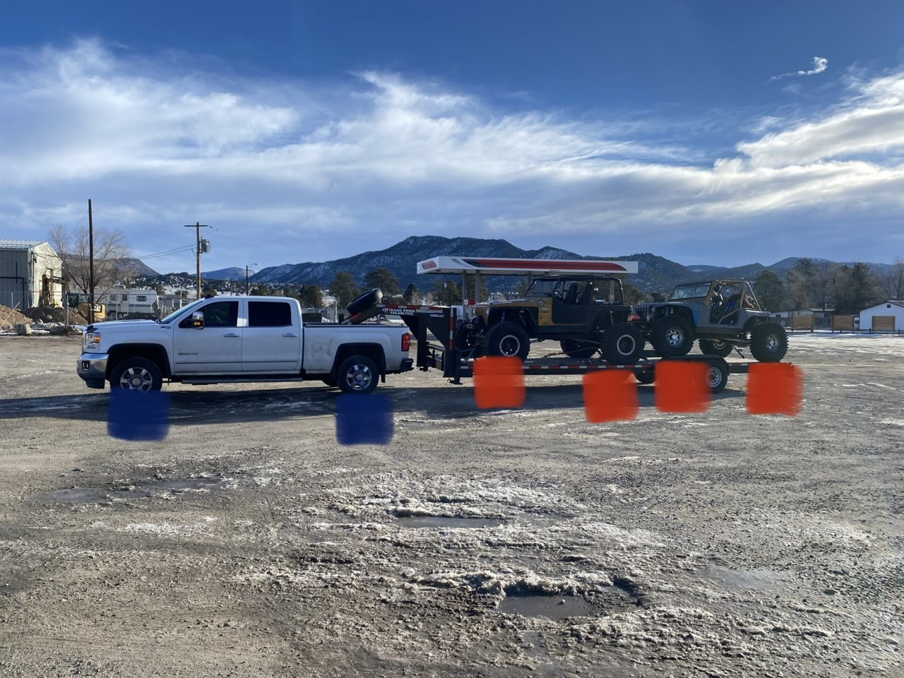

    Blue or LR E=heavy loading
    Red or LR C/D=off-road

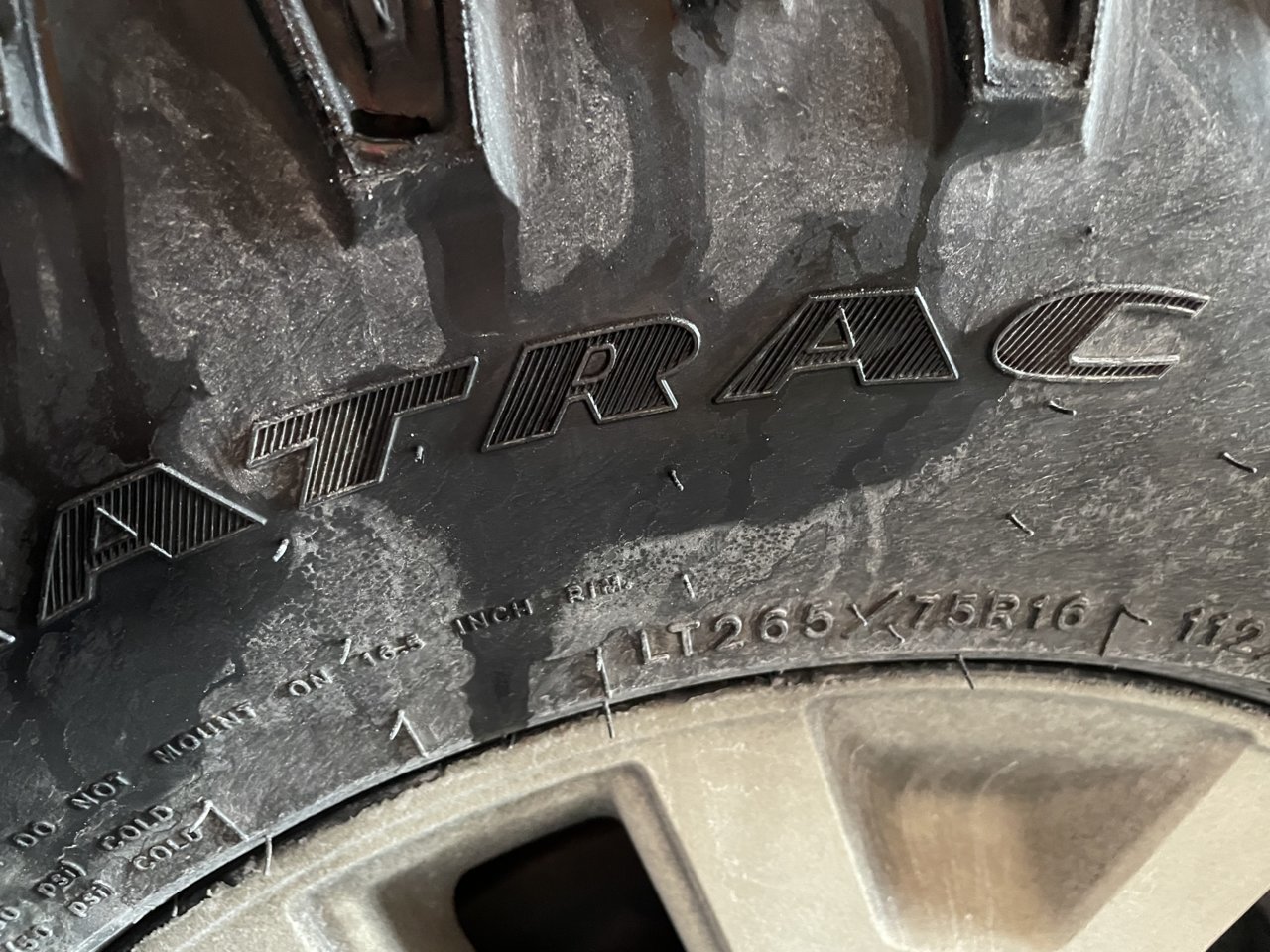

    Interestingly enough my (C Load) Duratracs are an LT tire.

    LT designation starts at C.
