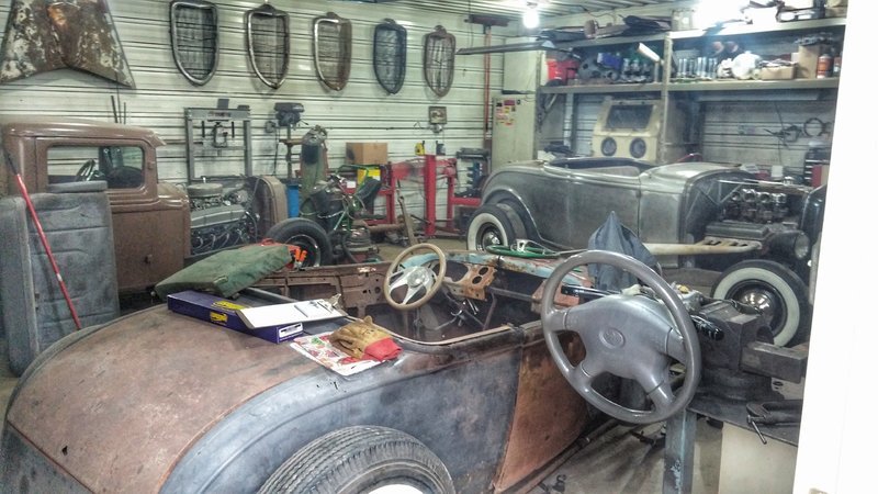

    20170222_105219.jpg After getting the frame swap done, I noticed my truck seemed to wander more than it did prior to the swap.
    I brought it in for alignment and the toe was way out. The dealer must not have taken the time to do it correctly.
    After getting the alignment done, the truck felt better but still wandered at highway speeds. I was constantly having to correct the wheel.
    I decided to pull the column out and tack weld the intermediate shaft assembly. The results were incredible, no more wandering and the steering feels tight.
    The hardest part was putting the tilt springs back. I didn't disconnect the shaft from the wheel and just welded it in place.
    I made sure the column didn't rotate and wreck the clock spring. All in this was about a 40 minute job. I'd encourage anyone who's steering rattles or wanders to do this tack weld mod.

    The 'intermediate shaft', is that the slip joint thats meant to collapse in an impact?
    ThunderOne and Logger[OP] like this.

    Yup that's the bugger. If the shit hits the fan where that shaft is collapsing I'll probably wish I was dead anyway.

    I just weld mine all the way around....

    You just wanted to show off your awesome car collection didn't you? :drool:

    On the serious though, when I modded my column, I much like @ckblum I welded it all the way around. That will ensure a failure free column for years to come.

    I thought people do the tack weld so that, god forbid, you get into a major collision, the tack welds on the slip joint (meant to collapse in an impact), can break free. Is this correct?

    That is the theory, and that is highly likely, but if your in that major of an accident to the point where your engine is pushed back and your steering column comes with it, you probably would be dead with that sort of impact anyways.

    yea I just think the Toyota engineers put the slip joint in for a reason, so it may be more than just a theory; but it certainly is a theory on here heh

    That shop looks way too congested for safe and effective work. I'll be a good friend and get one of those vehicles out of there for you. :burnrubber:
