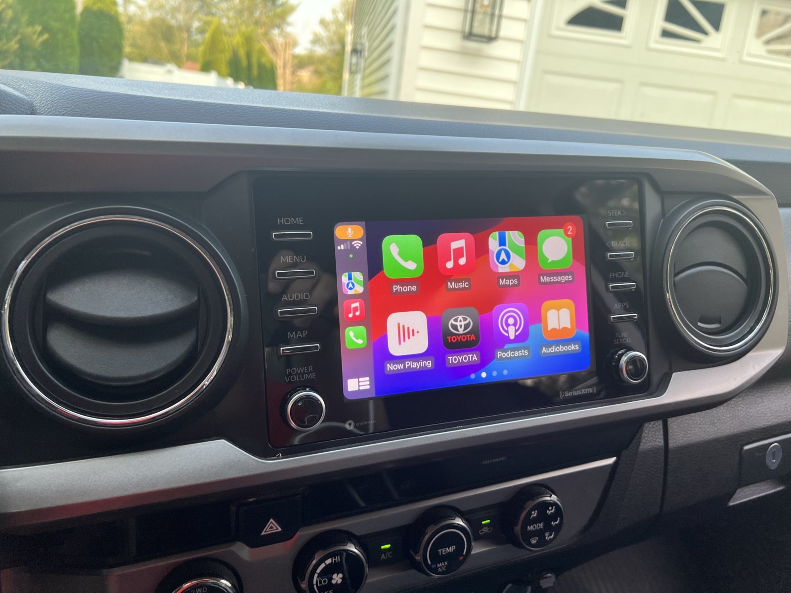

    Today I put a 2021 radio into a 2018 Tacoma. I just wanted seamless CarPlay. It works great so far.

    What was involved with the installation? I’m considering doing this myself.

    Just a harness, I did the same to my 2016, radio from a 2022. Whole process took less than 20min

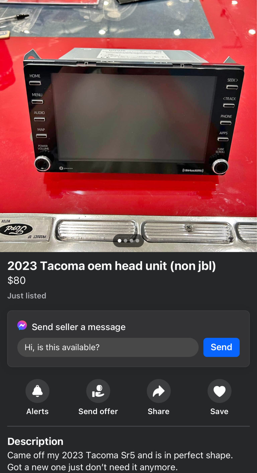

    If anyone in NC wants one $80 is stupid cheap seen on facebook marketplace IMG_3071.jpg

    So what's the diff between this one and a JBL unit?

    If you dont have JBL audio all around from factory, the JBL headunit will not function properly by itself if you try
