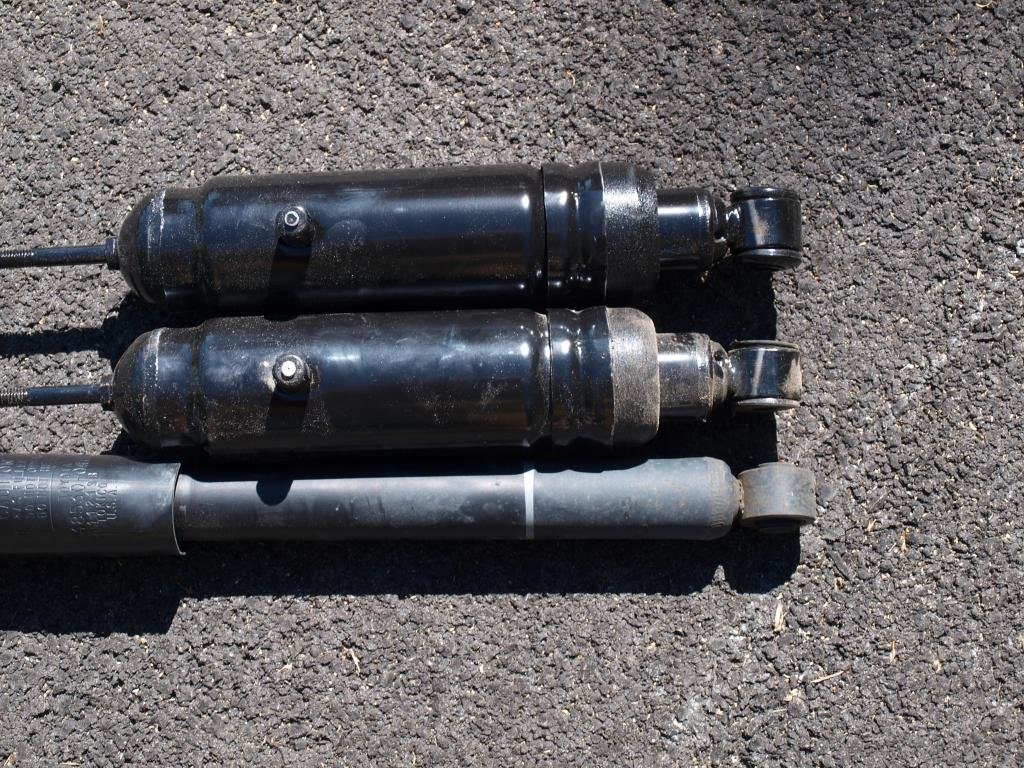

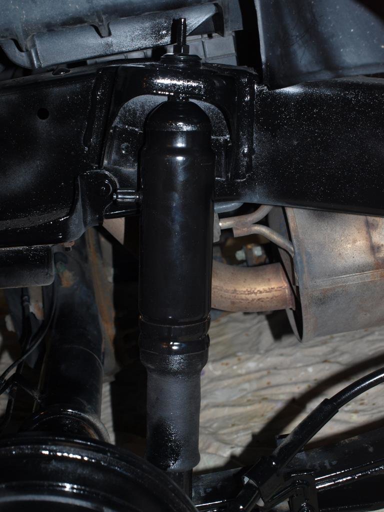

    As many of us know there are no air-shocks listed for recent Tacomas. I got a hold of the Monroe parts book and did some research. Monroe air shock model # MA777 ($55) has the same mounting and extension/ compression specs as a Tacoma rear shock with the exception that the center bushing on the Monroe's lower mount is 1/8" wider. 30 seconds with an angle grinder and a 40 grit disk on both ends of the bushings took care of the fit . 23psi of air gives the truck the correct ride height and best ride empty( better ride than the OEM shocks). With the 300# tongue weight of my boat trailer. 50 psi brings the truck up to level.

    Specs for 2012 Tacoma rear shock is 12.5" compressed, 20.5" extended. 12mm x 32mm eye lower mount. 10mm stud upper mount.
    Air shocks will hold air as long as the lines don't leak. I had them on my F150 for over 8 years and they never leaked.
    BTW I put the air fill valve in the passenger side storage box of the bed

    Yep 5 lug , I should have listed the full specs for my truck, 2012 base Tacoma reg cab, 2wd, 4 cylinder, auto
    I towed my 2800 lb loader and trailer 1600 miles round trip 2 weeks ago and having the truck at a level ride height made all the difference in the world for handling and comfort
