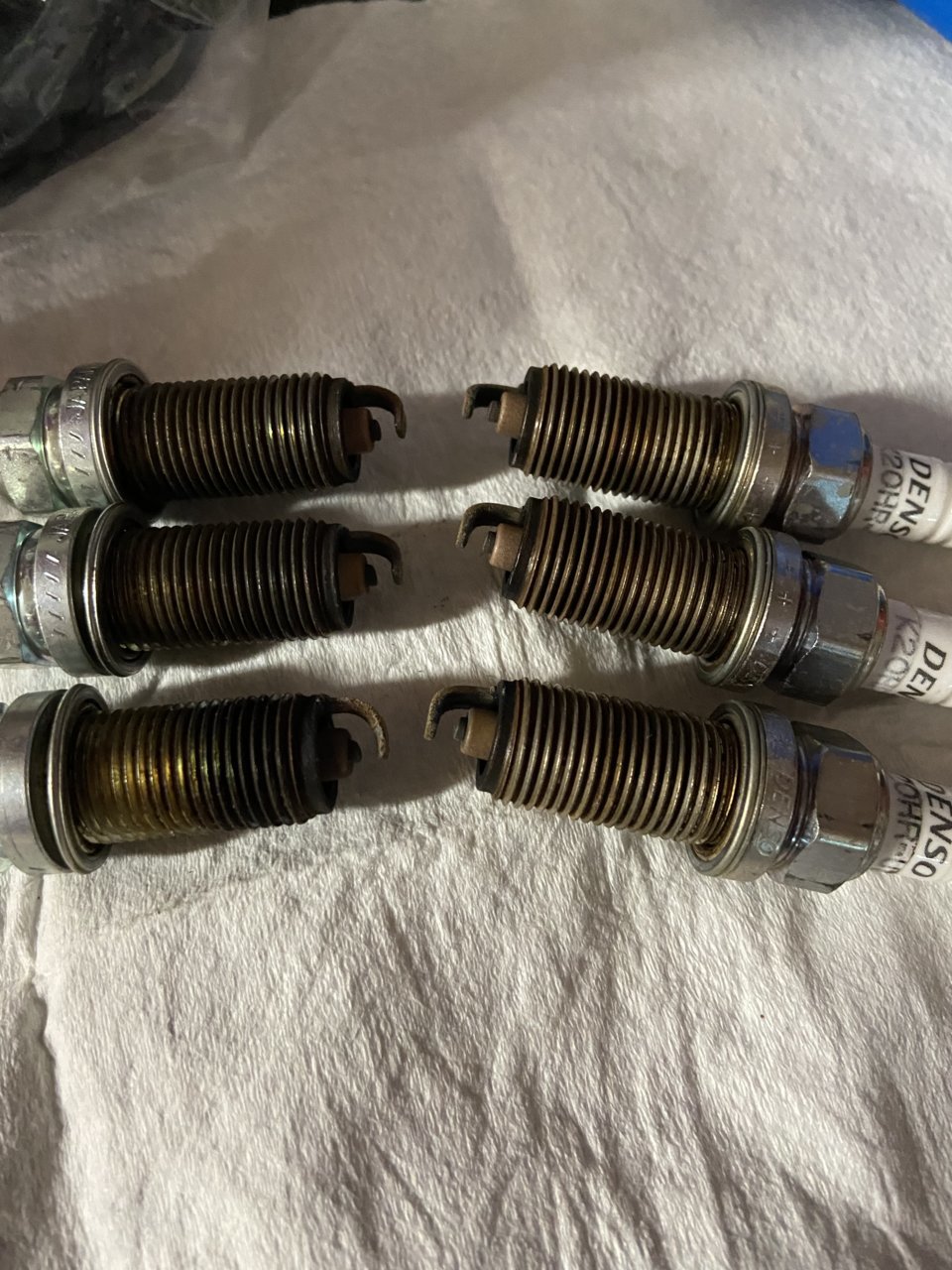

    I'm no expert here, just a shadetree mechanic who can hold his own, but looking your pics, I don't know what anyone wouldn't go with the Denso as a replacement: not even close. Even the threads and plating look higher quality.

    Replaced my plugs today. Had about 60K miles on the old ones. The old ones had a gap of about .050 or better. Installed the Denso plugs from Toyota parts.
    The driver's side is a pain for sure.

    Swapped mine out at 120k. Truck still had the factory plugs in it. Worst plugs gapped out at 0.066"
    https://www.tacomaworld.com/threads/how-to-spark-plug-change-1-gr-fe.30479/page-113#post-26672099
    I will say the passenger side plugs squeaked a little coming out haha. I haven't had a plug shoot out yet, so I'd call the swap a success.
    I will also agree with the folks who said the plug change on this motor is super easy. The only PITA was the front driver plug under the throttle body.
