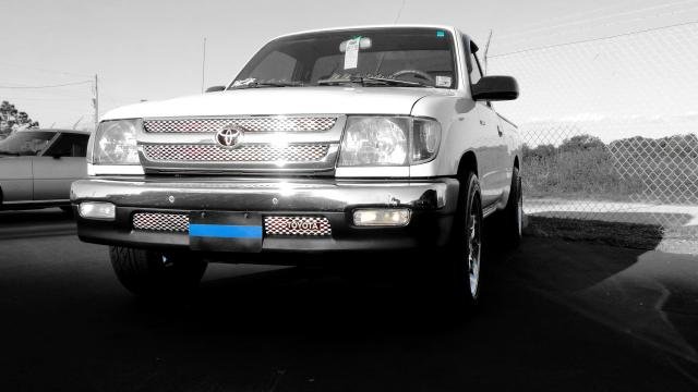

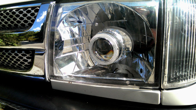

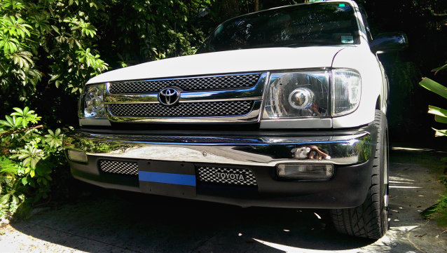

    I finally decided to do it right and not blind people using HID's in my halogen headlamps.
    I purchased this kit off ebay. Search for "G3 Bi-Xenon HID Headlight Projector Lens Kit Angel eyes+Devil Eyes H4,H1,H7,9005" on ebay to find them. They ran me $145 shipped.
    Then I decided to ditch my smoked JDM housings for some chrome crystal clear ones.
    I used this guide for doing the retrofit and it helped allot!
    http://www.tacomaworld.com/forum/li...-write-up-dummies-dummy.html?referrerid=16879
    And here's the results after working on them for 3 hours total!
    I am happy with the results and all together it ran me about $225 all together to do this!
    I will post night shots later :cool:

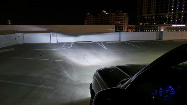

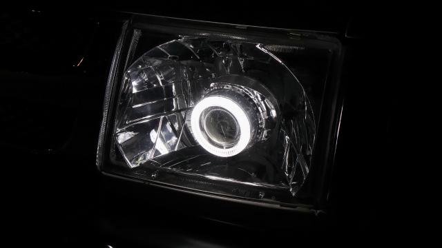

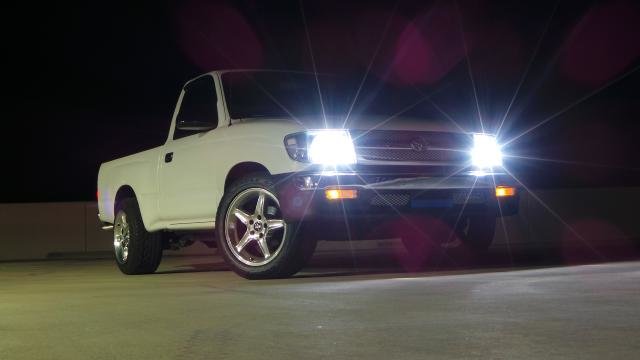

    Night time Pics

  4. Nov 6, 2013 at 5:49 PM
    Backinblack03
    Backinblack03 Well-Known Member
    Sep 4, 2012
    #86259
    247
    Brian
    VT
    2003 Xtra cab 4x4 2.7/5spd
    ABS sucks.

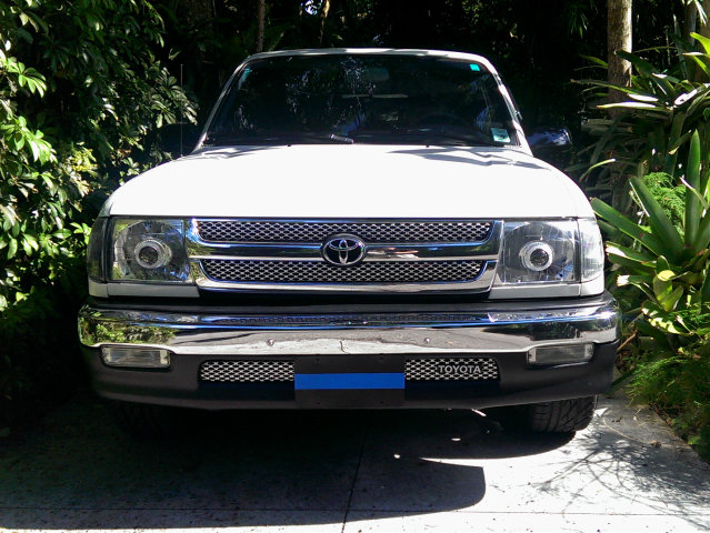

    Looks good, but your driver's side projector is rotationally out of alignment...

  6. Nov 7, 2013 at 5:10 AM
    taco47001
    taco47001 Newborn
    May 11, 2012
    #78644
    1,907
    Aurora, IN
    LX470
    Not sure if its out of alignment rotationally (look at the right side cutoff of the DS lens). It really just looks like the projectors themselves are very low quality and no not focus/ or cut off correctly. They are most certainly not adjusted equally along the horizontal plane.
    Other than that, Great job OP. A lot of ppl are too scared or very hesitant about tackleing something such as this. It looks great aesthetically.
  7. Nov 7, 2013 at 4:57 PM
    CliffordBRD
    CliffordBRD Well-Known Member
    Mar 29, 2012
    #75835
    210
    Cliff
    Tampa, FL
    09 DCLB 4x4 Pyrite Mica
    Looks good. Like others have said, the drivers side is a little off.
    Try grabbing it and twisting it to align it a little and then use the adjusting tabs to dial it in.

  9. Nov 13, 2013 at 9:06 AM
    SRQ TACO
    SRQ TACO [OP] Well-Known Member
    May 6, 2009
    #16879
    1,474
    Damon
    Sarasota, Florida
    2000 Tacoma 5lug Lowered & 2008 Tacoma 4x4 Lifted
    No it's not "off" It's how the cutoff is it's weird. I guess that's what you get for doing the budget friendly retrofit. The kit only costed me $145 with HID's.

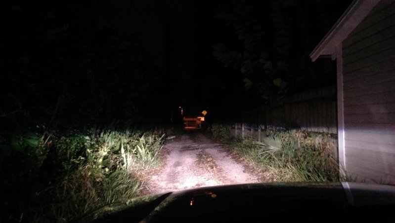

  10. Jan 19, 2014 at 2:52 PM
    SRQ TACO
    May 6, 2009
    #16879
    1,474
    Damon
    Sarasota, Florida
    A better shot at the cutoff. It seems pretty straight to me. Overall everything has been well and nobody has flashed me.

    Does the halo change color?
