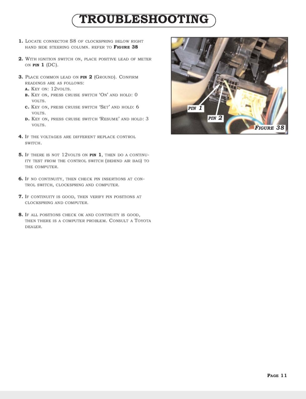

    Here's an install manual for a retro kit, I'd follow their troubleshooting section (pg 11) to start.
    http://www.rostra.com/manuals/250-1836_Form5188F.pdf
    Pretty sure this is going to end with you going through that full harness with a continuity tester.... tedious, but effective.
