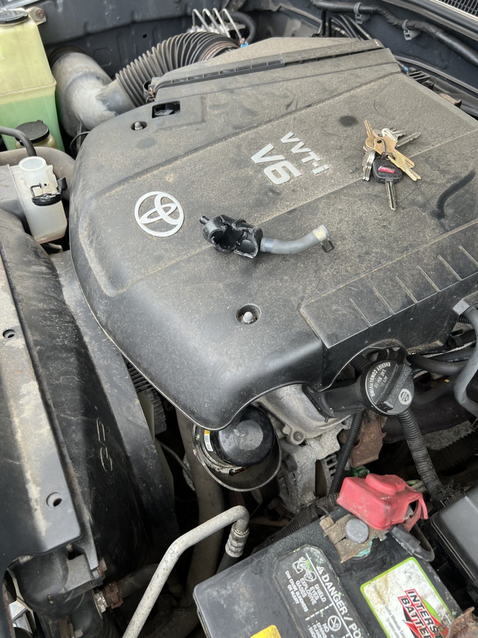

    Aloha anyone. My 09 pre runner got jacked and molested. Cost me a grand to get her from the tow yard here in Hawaii. I had a spare key ( they got the OG but I’ll cross that road later). She started up, so I shut her down. Coolant was empty. Front grill smashed and found some parts laying about the engine compartment. I had to put water from the hose in the radiator to drive the 30 miles home.
    Before I get into all the things, can anyone identify the part? ( I have a blue driver diagnostic tool, that led me to things that don’t look like what the pic of the thing is.
    this is my first victim situation, and I don’t know where to start, except the plates before the saftey check expires.

    I forget the actual name.
    It hooks to the intake.
    @Dm93 k owns the actual name.

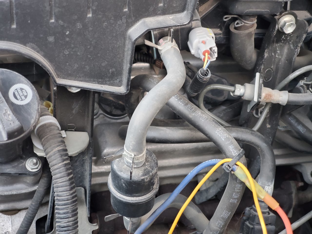

    Absolutely. Yup the part number it’s the correct one. If you give me some minutes I can post a picture of location.
    Dm93 likes this.

    :thumbsup:
    Ricardo13x[QUOTED] likes this.

    Thanks! I couldn’t figure out what’s missing.
    I’m sure to find more. I have a BlueDriver diagnostic set up. It gave me codes for the Mass air flow sensor. CH02 heater control.
    Vapor canister purge solenoid.
    I haven’t found a coolant leak and can’t figure out the lack of coolant. I can’t image the cooling system is just okay..I’ll find out later.
