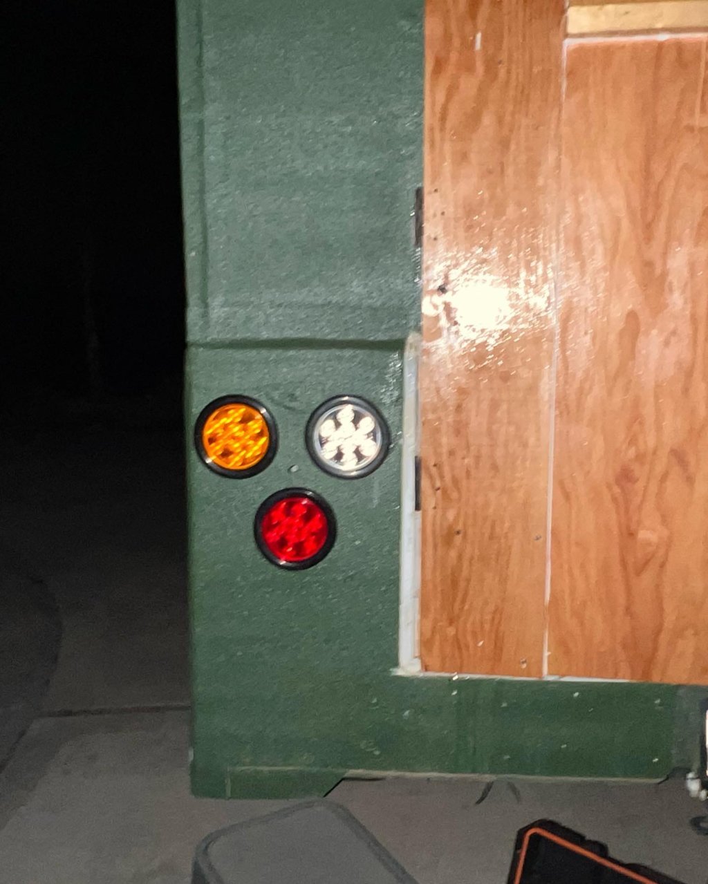

I swapped my stock tail lights for 4” LEDs
Discussion in '1st Gen. Tacomas (1995-2004)' started by wildmanmarck, Jan 2, 2023.
  1. Jan 2, 2023 at 12:19 AM
    wildmanmarck
    wildmanmarck [OP] Well-Known Member
    Aug 12, 2022
    #403434
    45
    Reno
    The ultimate adventure taco
    The problem I’m having is the now there is no sensor to control the blinking and it’s rate has gone as if there were a short. I know that it has something to do with the relay, but I have found anything concrete. I’m just trying to silence the ticking, the rate doesn’t bother me

    Yes. Pictures.

  7. Jan 2, 2023 at 6:31 PM
    wildmanmarck
    Aug 12, 2022
    #403434
    45
    Reno
    You can flip it if you wanna see the right.
  8. Jan 2, 2023 at 6:31 PM
    wildmanmarck
    Aug 12, 2022
    #403434
    45
    Reno
  9. Jan 2, 2023 at 6:32 PM
    wildmanmarck
    Aug 12, 2022
    #403434
    45
    Reno
    Here ya go
  10. Jan 2, 2023 at 6:33 PM
    wildmanmarck
    Aug 12, 2022
    #403434
    45
    Reno
    I like the speed, just not the noise
  11. Jan 2, 2023 at 6:33 PM
    wildmanmarck
    Aug 12, 2022
    #403434
    45
    Reno
