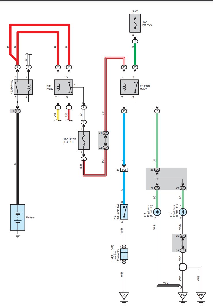

    high beams work, fogs work, low beams do not. took out bulbs that were in, replaced with new. still no lows.

    The only way the fog lights can work, is if the Right Hand LOW headlight fuse is getting power. The fog relay is powered off the Right Side- Low fuse.
    So.....You have to be getting power to at least the fuse.
    Do you have a voltage meter or a test light?
    We need to do some checks.

    Out of curiosity. Does the headlight indicator on the dash work?

    Given that it sounds like you have an 07 you may want to inform us of how the combination switch feels and works. If it's all worn out and loosely goosey, that might be your problem right there. By combination switch. I mean the turn signal stalk itself the one where you need to turn the switch counter clockwise in order for it to turn on the headlights.

    The Combination switch has to be working. The Low headlights have to be on for the fog lights to work.
    OP says the fog lights work.......?

    Unless someone did the fog anytime mod.

    Also, this is why I asked if the headlight indicator on the dash worked.
    It uses a different ground too.
    It's the little clues that point the direction.
