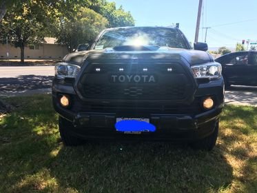

    I watched a video on how to install raptor lights. The person on the video said to connect it to the 10A INJ fuse if you want the raptor lights on even without the headlights. I did that....turned on my truck then BOOM > cranks but doesn't start > Low Oil Pressure msg and Brake Malfunction override msg.
    Put the 10A INJ fuse back in and message went away. Raptor lights work now that I've plugged it in to the headlight 10A. But now the left headlight (If you are standing facing the grill) doesn't turn on.
    Test it with different bulbs, check the fuses itself and nothing is broken. Idk what it is.
    I might take it into the dealership. Anyone run into this before? What did you do to fix it if you were able to?
