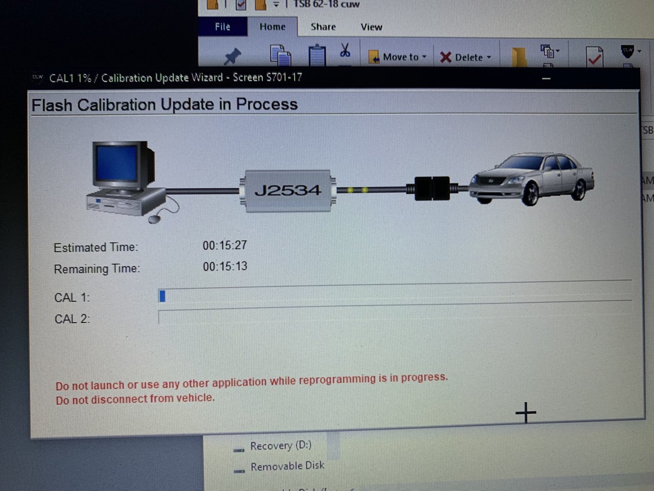

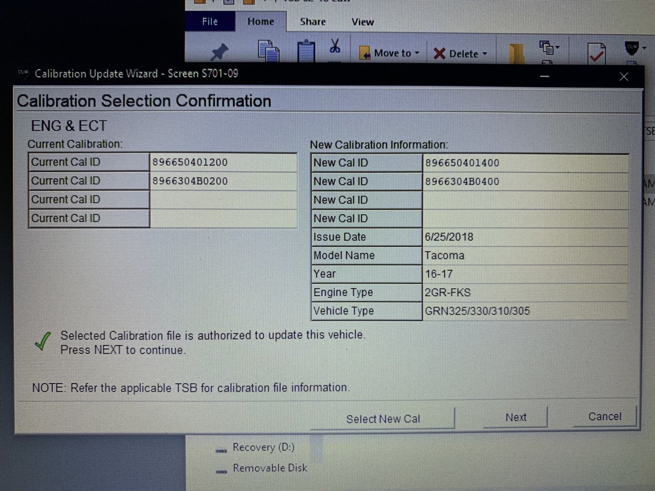

    I was gonna give it a shot tomorrow because I wanted more time on the TIS subscription. But after I got back from dinner I could not wait.
    Paid $65 for a 2 day pro subscription. Downloaded and installed the latest TS in the Host. Got it licensed.
    Had the truck already on a charger with the hood open.
    Opened the windows, Ran the power cable for the laptop out the window so the door could close.
    Made sure I had an internet connection because I was doing this by the book.
    Turned off the AC, Entune screen, dome light (even though the doors were closed).
    Plugged in the Tactrix cable. Followed the instructions for TS to confirm communication. Passed.
    Performed Health Check on power train ECUs. Got an error while communicating with server. pressed the try again button and it completed.
    Updates for both Engine and Transmission ECUs listed.
    Followed one of the Update links. This opens a list of TSBs. This is where the dealer tech goes shopping for the one that fits. I picked 0058-18. This opens the TSB PDF in your browser. For me that was MS Edge with sucks because it has it's own PDF viewer and the links inside don't work. Copied and pasted the URL into IE and it opened in Acrobat like a good boy. Now I followed the link to the CUW ECU file. Saved it to the desktop then ran it.
    The update wizard starts and it goes through the steps of confirming the key is off then the key is on then go.....
    It started updating. HOLY SHIT. It's working but it aint done yet.
    CAL 1 done.
    CAL 2 starts...... This one is a little slower.
    Update complete! Turn off key. press next......
    Turn on key. press next to confirm success........ failed.. can't talk to vehicle. GASP!!!!!! I saw this screen last time....
    Try again. turn off key... wait. Turn on key... (right here I realized when asked to turn on key for the confirmation I had only pressed the start button once and it was in the accessory mode not the On position). Whew! This time it worked.
    Ran another health check and found no updates.
    Started the truck and it fired right up.
    Confirmed on cheapo scan tool that B04 and whatever the transmission update version is got installed.
    Took it for a test drive and OMG you can leave the AT in "D" now. Gentle squeeze on the gas and it kicks down one gear like it should without any of that super delayed 'WTF? nothings happening' feeling.
    Thanks TW for making me ill and exited all at the same time.
    TL;DR. I updated to B04 myself.
