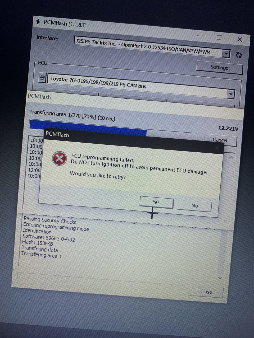

    Skip identifying just load the file and straight to flash

    Got it, trying now

    Fuck let’s hope this works.

    it will :) just continue trying.
    Also it is safe to turn the truck off and try again
    Turn the truck off completely, and do it again

    Trying now for 3rd time

    Turn the truck completely off, wait 1-2 mins, turn truck back on, try again. It will work

    Ahh. Thanks @OVTune I guess I can close out my tabs for rental cars.
    I’ll drive around on 04B02 until 1.05 comes out.
    Flashed ECU and TCU back to stock.
    I am so damn relieved.
    I followed all of the instructions for the TSB files. No clue why that didn’t work. It was working fine then bam, failure.
