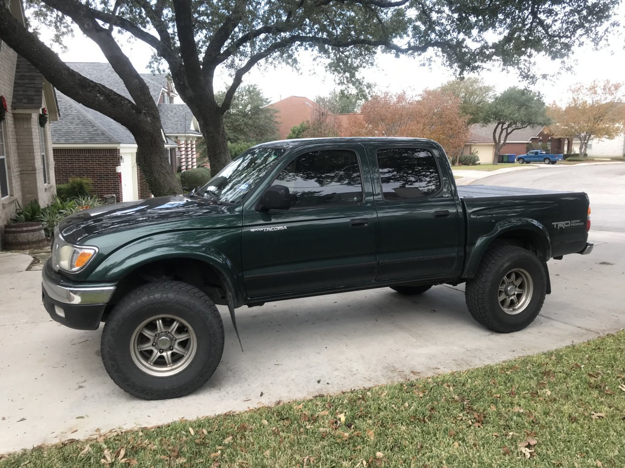

    Test fit a 8” wide wheel with 0 offset. I think you’ll like the look had it my first gen. This pic will you an idea. 2D4526B4-EA59-48FE-923B-43EEA73EF126.jpg
