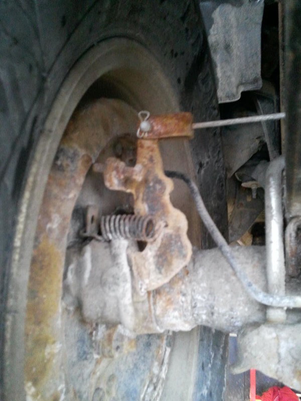

    The times mine have stuck it was because the snow melt had refrozen. Here in Colorado they have traditionally used liquid magnesium chloride as a de-icer and it makes this nasty red-brown glop that seems to coat everything. This is a mild example.
    What it did on my old truck is freeze the bell crank, which is an arm that actuated the shoes. The way Toyota used to put the rear end together made it particularly susceptible to this. On the 2nd gen the cable goes in the backing plate so I've never had an issue, but on earlier trucks this could definitely freeze up really easily and would rust like crazy.
    It's a legitimate thing for it to freeze in the locked position, so you would have to beat it with a hammer or heat it up to release your brakes. It's kind of the opposite problem as the OP is describing, you'd be stuck with the parking brake on and couldn't go anywhere. So, sure, sometimes you'd not use the parking brake to prevent that.
