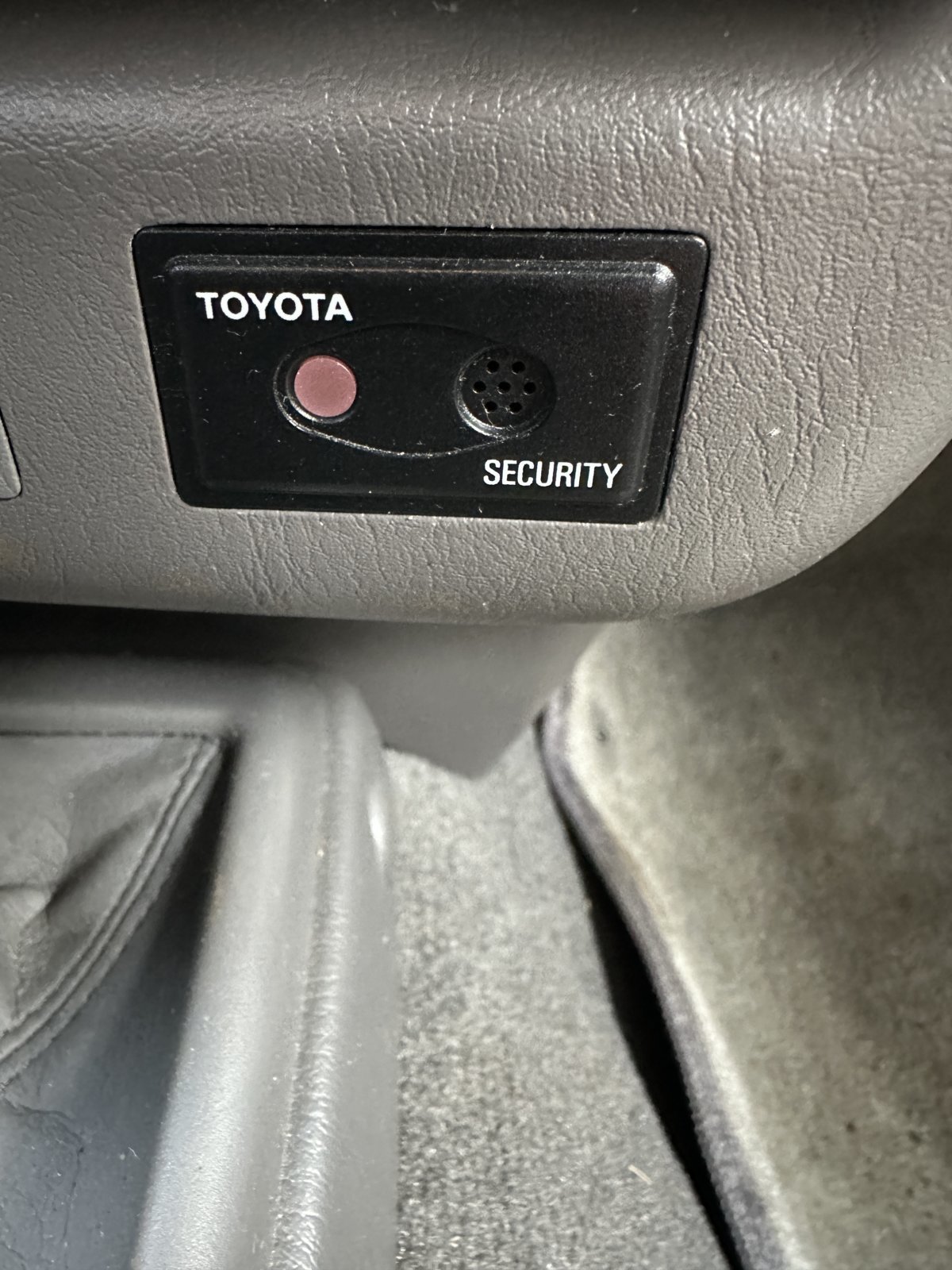

    Thanks for all the help, it turned out to be the simplest thing possible… Put the key in the ignition and turned it on, attached the battery leads, the horn honked very briefly, and the lights flashed, I guess as the security turned itself off.
    Then, to test for the phantom leak, the multimeter read 0.29 A for a few seconds followed by 0.11 A for another few seconds, followed by 0.02 A (which I think actually was 0.01 because of the miss-calibration in the multimeter).
    I read that this initial average was a Toyota initialization thing when re-installing a battery.
    Turns out I have a factory security system that I hadn’t even noticed. I can’t find it in my manual, and it never gives any indication it’s there, I’ve never had a false alarm, only this triggering resulting from the dead battery Period
