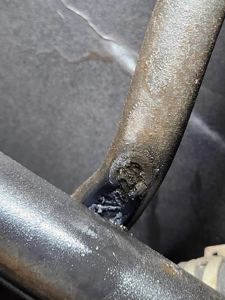

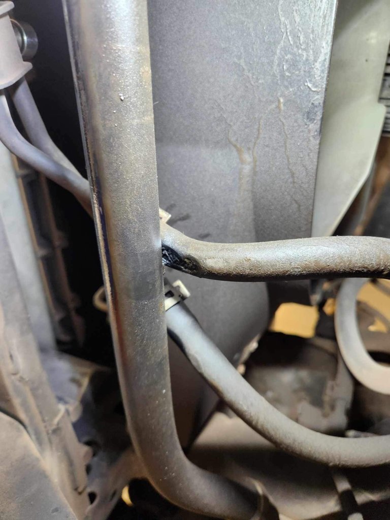

  10. Oct 19, 2024 at 1:14 AM
    #30
    Just1MoreMuffin
    Just1MoreMuffin [OP] Member
    Mar 13, 2024
    #445754
    10
    2013 Silver Tacoma TRD-Offroad
    Bilstein 5100 2020 4Runner SEMA gunmetal wheels 265/70r17 Falken Wildpeaks
    Also here’s some pictures of where the line got worn through and I lost all my fluid. Check your lines everyone!
    Schlappesepple and spitdog like this.

  12. Oct 19, 2024 at 6:27 AM
    #32
    LOLLY
    LOLLY Well-Known Member
    Oct 11, 2016
    #199547
    824
    Alfredo
    Norwalk, CA
    '05 Tacoma DCLB TRD Sport (RIP) Now '21 TRD Off-Road
    Hopefully they also figure out why it was rubbing in the first place. That also needs to be addressed
    2015WhiteOR likes this.
