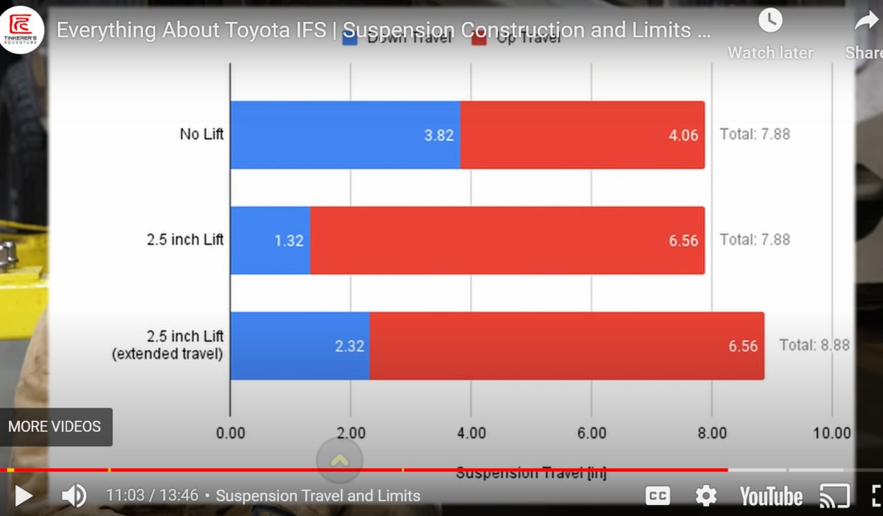

    Measure your down travel as explained in the video another posted. I believe the video provides the stock down travel for comparison.
    stock down travel is 3.8"
    If the down travel is only 2", you may be experiencing topping out, exactly what you are describing.

    @Junkhead if you're even slightly mechanically inclined, it's probably easiest to pull the coilover and measure the extended length. Or just jack up the front so the wheels are off the ground and provide the tophat to lower bolt length, like you did at ride height.
    It sounds like your ride height is too close to the full extension of the shock. This isn't your fault from install, but rather a limitation of the shock.

    this topping out can be more apparent with only 2" of down travel when you have a shock that has minimal rebound and a heavier spring. The shock just flings easily back to max length, topping out, when the suspension is unweighted after you go over a speed bump or rock.

    If you can carefully measure from the exact same spot on the top of the shock spring plate and the center of the lower shock bolt both at normal level ground ride height and then with the tire off the ground it would help.
    Record those two measurements.
    Subtract the small from the longer and then multiply the result times 2. That will tell you what your down travel is.
    You may want to measure both sides the same way for comparison and to ensure one side is not damaged.
    example for simplicity.. ride height measurement is 16", tire off the ground is 17"
    Difference of 1" x 2 (leverage ratio) = 2" of down travel.

    As the video said, one can safely add .5" of top spacer plate, effectively making the shock a long travel and adding 1" of additional down travel. 3" of light will have create problems with the front drive axles and boots, just as the video suggested.
