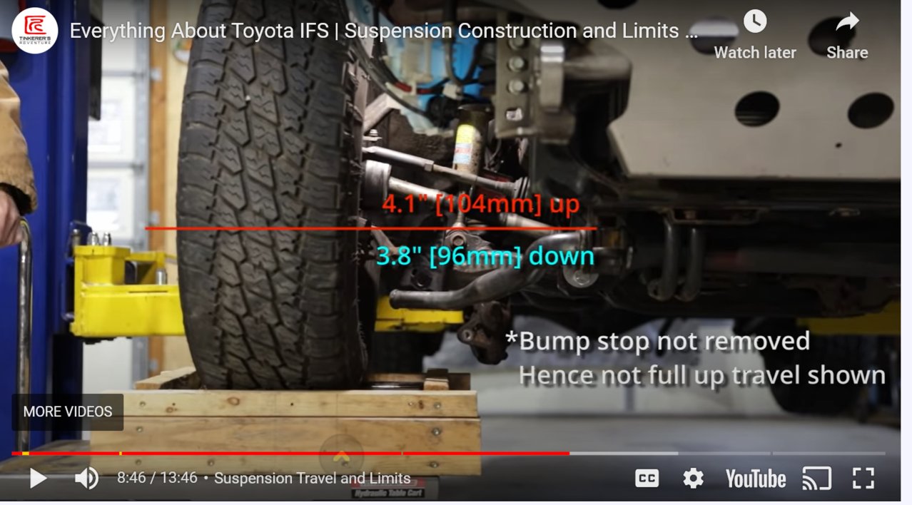

  19. Feb 27, 2023 at 5:25 PM
    #79
    Fast1
    Fast1 Well-Known Member
    Jun 24, 2009
    #18875
    1,132
    Minneapolis, MN
    2021 TRD Off-Road Access Cab
    Do you understand what down travel is?
    Here is the stock down travel and up travel. Educate yourself.
