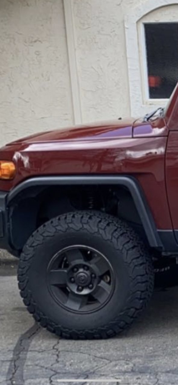

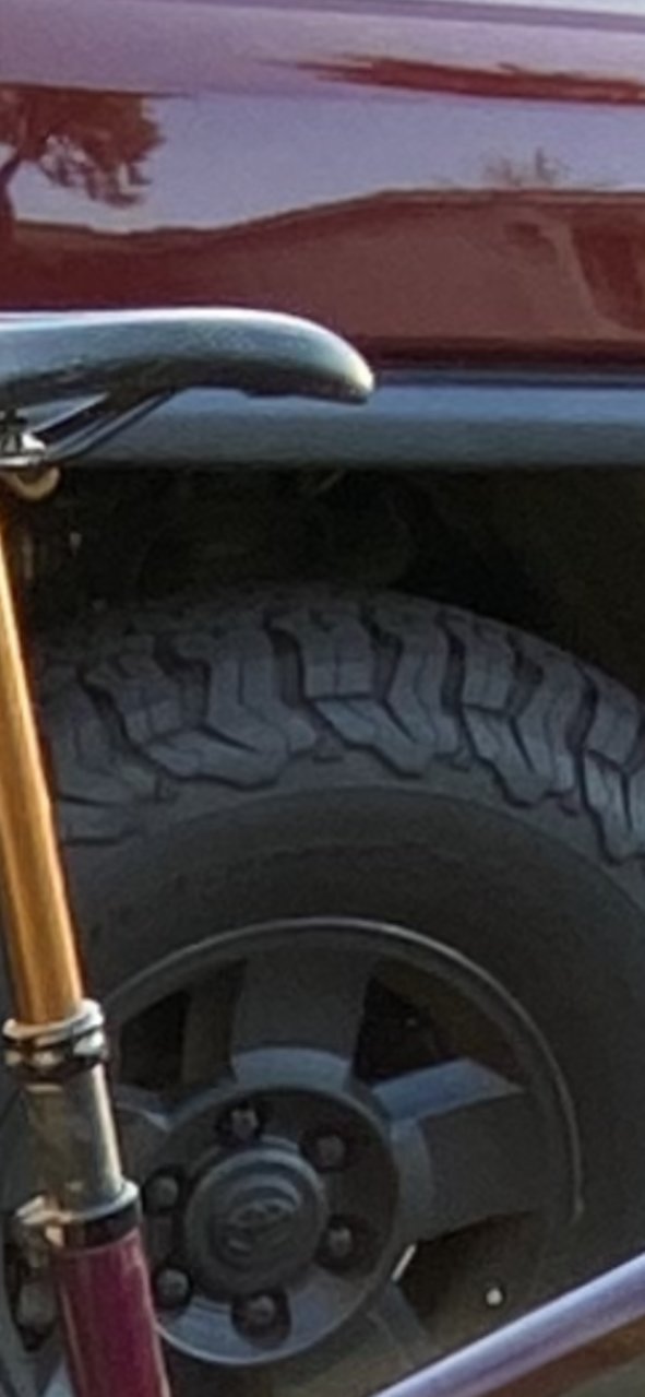

  12. Apr 7, 2023 at 10:49 AM
    #152
    05tacoalltheway
    05tacoalltheway Well-Known Member
    Sep 27, 2017
    #231359
    48
    Brian
    2010 FJC
    Yeah and the cv angles were pretty bad too.
    Here’s my best before after gap pictures.
    Unfortunately no good pictures with bigger tires before lift.
    The 885’s are advertised with 2.5-3 with 70-180lbs so not surprised I had more lift.
