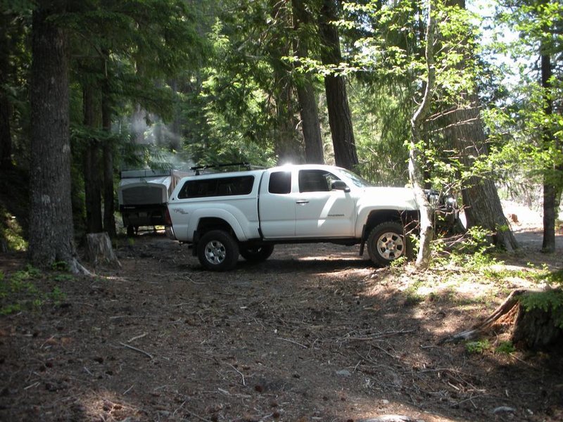

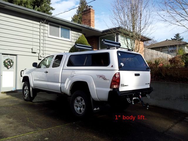

    Sure. Being "hard" on the transmission to me means...
    1. Having a Super Charger
    2. Installed 1000+ pounds of extra weight (fiberglass shell, 1/8" plate front/rear bumpers, warn winch, hi-lift jack, jack stands, extra 7gal fuel can, oversized 10plyBFG KO tires, custom OME suspension, winter recovery gear, etc)
    3. Pull a 3000 wet weight trailer camping about 2x a month in the nice weather.
    4. Load tons of gear on winter trips with roof carrier, bike racks (I'll be driving to Arizona twice this winter, 3k miles per trip)
    5. Daily driver in city stop-go traffic
    6. Old house under pretty much constant home improvement. Always hauling retaining wall bricks, floor tiling, 100s of 4x4x8 posts for fencing, etc.
    Basically "hard" to me means really using the truck on a regular basis as a truck.

    Okay, I get what you're saying. I was thinking more along the lines of accelerating. I have <100 lbs extra weight and tow hardly (anymore). Got any pics of your truck or a build thread?? Sounds like one hell of a setup!

    Thanks for your kind words. Really it's a pretty moderate setup. Suited for dirt forest roads and the beach and snow. It suits me and like all of us I love my Tacoma and want it to last and last.
