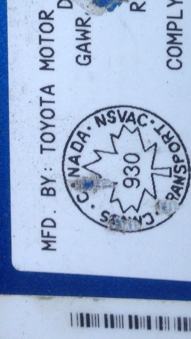

    Since it’s rusty on the West coast, I wonder if it was imported from Canada. If it was, it would have this on the VIN sticker.

    Came from Ohio.

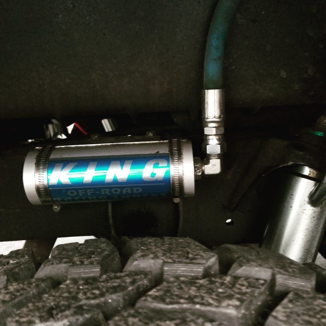

    And for anal mofo's like me it keeps your beautiful Kings and JBA UCA'S looking nice through the shitty Winter as well. I go out once a month and hose them off, wipe them down. Then blast them with Fluid Film again
