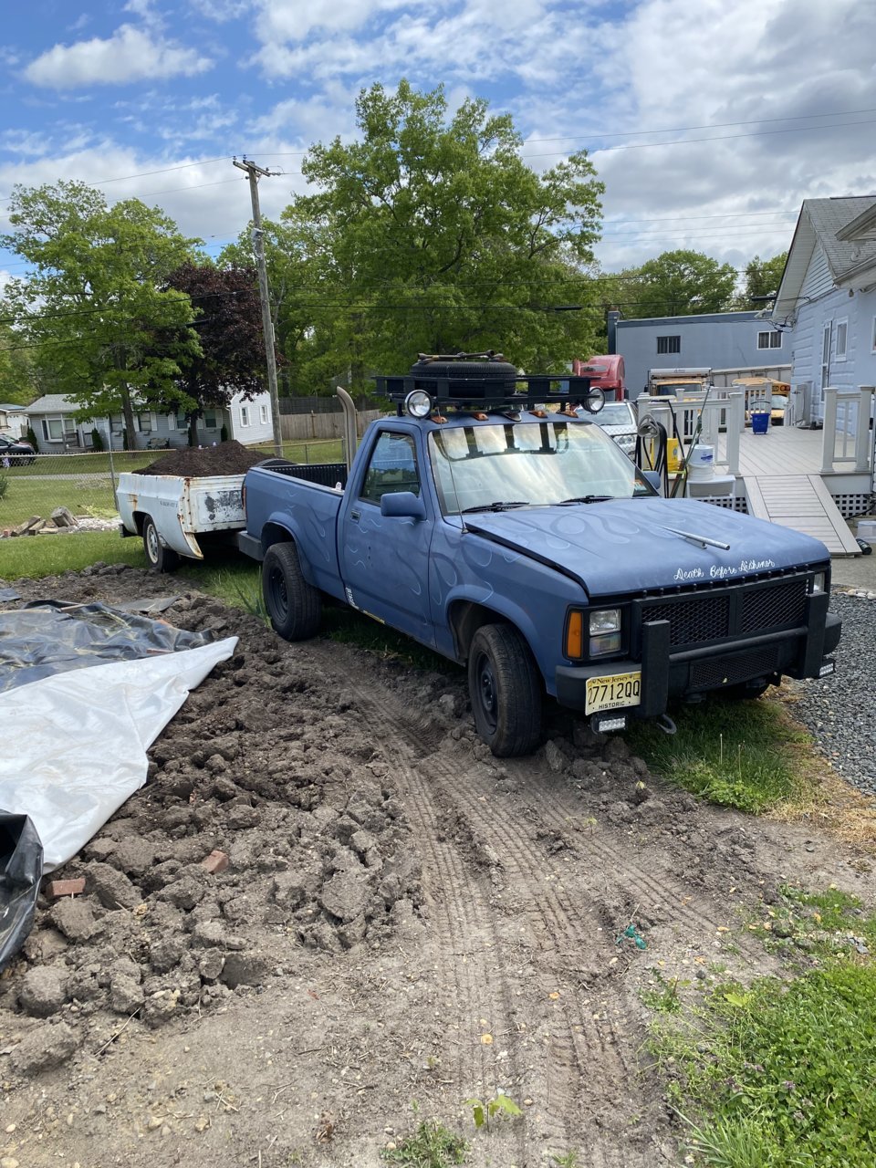

    1990 Dodge Dakota 350 Chevy engine -- Turbo 400 Trans -- One ton GM full floating 8 lug rear. (3) trans coolers with 180,000 miles on factory rebuilt trans and the fluid looks like it just came out of the jug. I service it every 35,000 miles. I am a total believer !!! My Tacoma has a tough image to follow !! Still keeping the Dodge for the really hard jobs.
