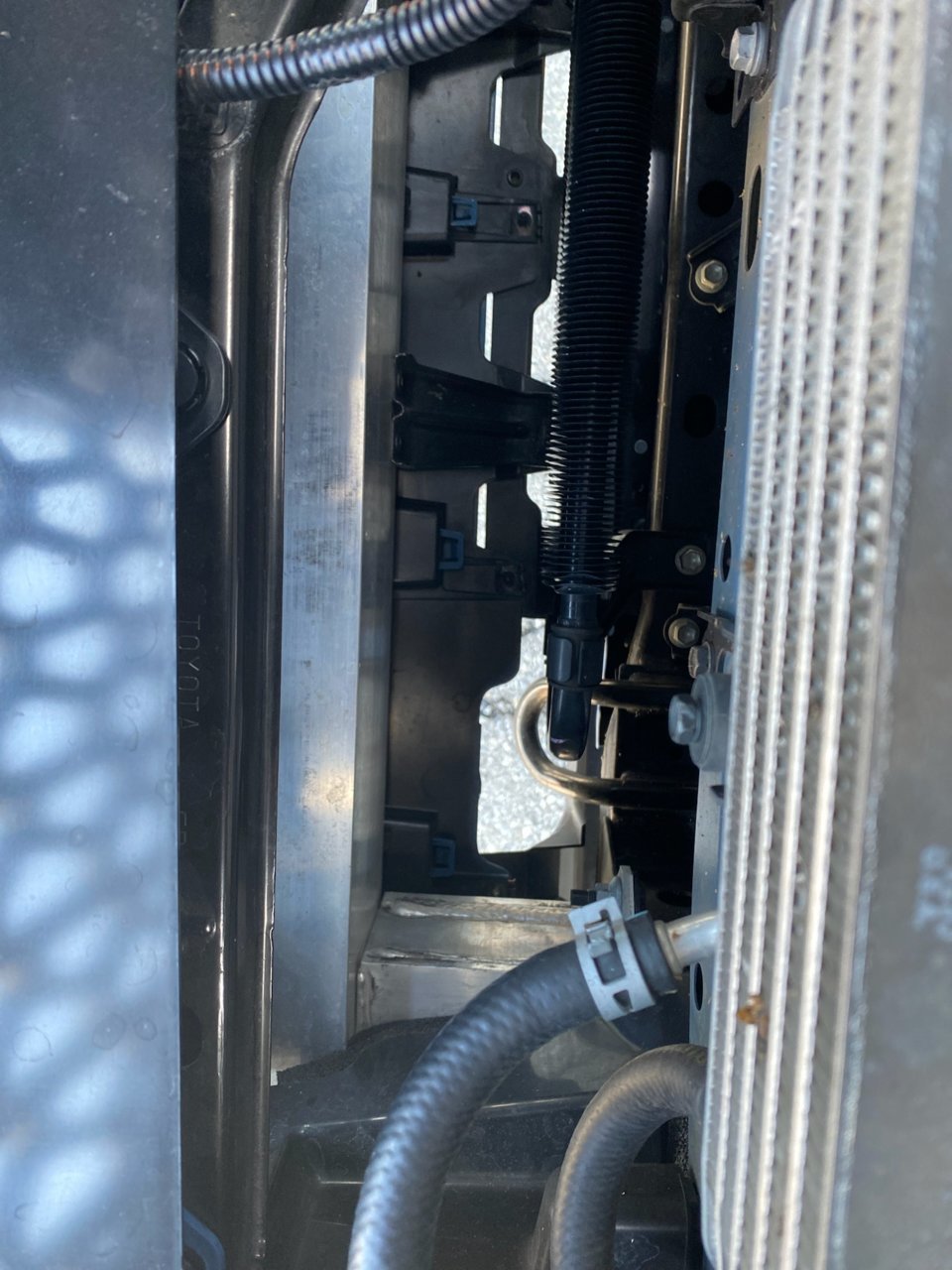

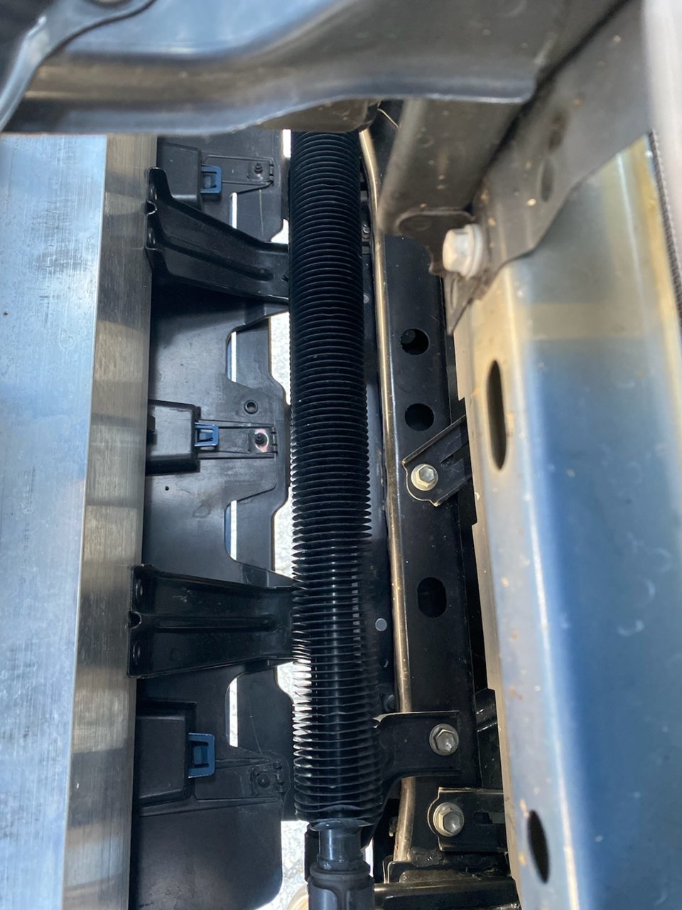

    2019 Sport with tow package do either of these pictures show an external cooler ?
  4. Oct 3, 2022 at 4:49 AM
    #64
    ernscott
    ernscott [OP] Well-Known Member
    May 5, 2021
    #364854
    368
    2021 Tacoma
    It looks to be in the second photo to the extreme right. Silver in color.
    Vmax540 likes this.
