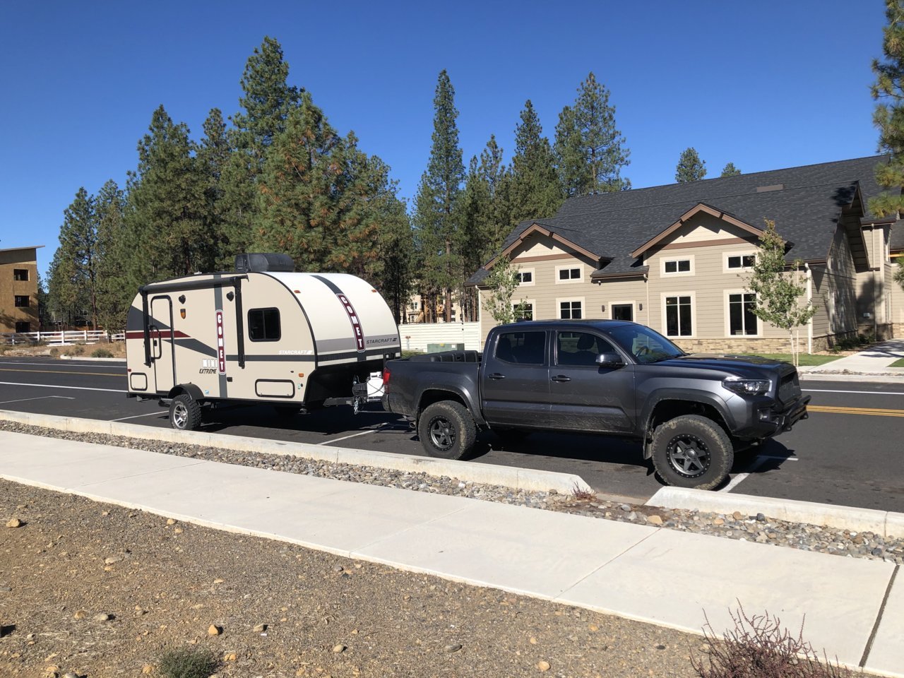

    I've got an 18' StarCraft Mini Comet Extreme (ghey name, good trailer), Rpod makes an identical model under a different name as well.
    It weighs about 3100 pounds empty, 3700 max weight. Tows great behind my 17' with 33's although I wouldn't want to tow any more. I average between 9 and 11mpg. I've towed over the steepest passes in Oregon up to 5500 feet, truck dips down all the way to 2nd gear at 5000rpms at the steepest portions to maintain 55mph, but in general 3rd gear at 4000rpm will take most hills. Flat ground is a breeze.

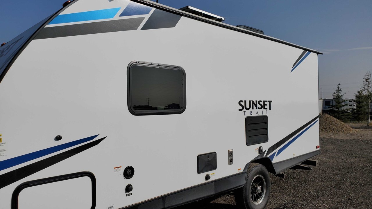

    ~4000 is a nice tow. Mines about 4400 when tanks full. No issues. Just set up with proper WD hitch and brake controller. Manual transmission here also.
    Edit. My single axle tows good, but dual axle will always tow just a bit smoother/stable. Something to consider for long run.
