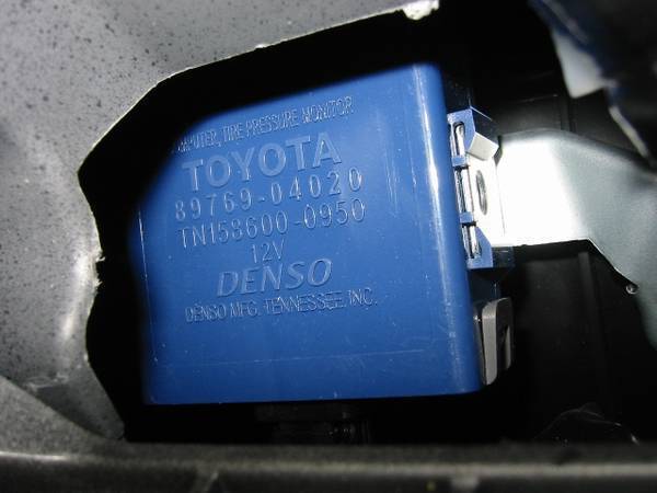

    I'm going to do some research tomorrow, Bobbb, so I can give you a part number from my 2007 TPMS 'computer'.
    I know it's just behind the stereo. I saw it yesterday when I pulled the center console apart.

    Cool, I appreciate it. Once I saw that mine was a new part number from mid-2010 on, and knowing they stopped with the spare sensor before that, I figured I was screwed. I have to go to another town in a couple days so plan on hitting up a different dealer's svc/parts depts to see what they have to say as well. Call me anal with wanting all five monitored, but I hate taking no for an answer.

    Better late than never!
    From my 2007 Tacoma with 5 TPMS sensors.

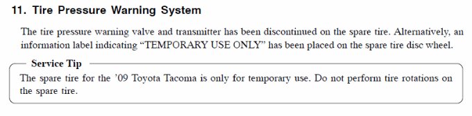

    Something else I found. In the attached PDF (2006 FSM), the 'intelligent tester' will show definitively how many TPMS ID's you can register to the computer. Of course, that means a trip to the dealership... $$
    I'd pull your stereo and compare your TPMS computer to mine.

    My 09 has one in the spare? I bought my truck on Aug of 08, but it was built in July of 08, so maybe they still were installing them on the line?... :confused:

    Sounds like you did get 'lucky' with an early 09 (or the dealer added a 5th TPMS sensor in the spare for whatever reason), because as Toyota documents, the 5th TPMS sensor was discontinued for the 2009 model year.
