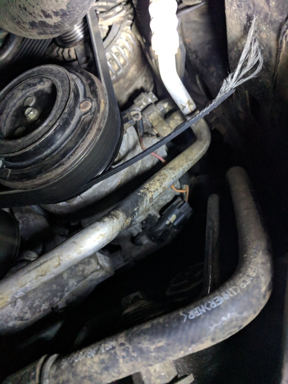

    @Torspd my truck just started to shred a brand new serpentine belt on one rib...... Any suggestions? Something not aligned correctly with pullys/idlers?
    I just happened to hear an abnormal ticking/flap when I pulled in the driveway. :Frusty:

    You got it 1 groove off on 1 or more of the pulleys. I've seen it before.

    You should be able to see if there's and exposed groove on 1 of the pulleys on the opposite side from the shreded belt.

    That happens when the edge of the belt is running off the edge of a pulley. So, which ever pulley it is, you should see an exposed groove.
    The edge of the pulley is taller than the pulley ribs and it just slices off the edge of the belt.

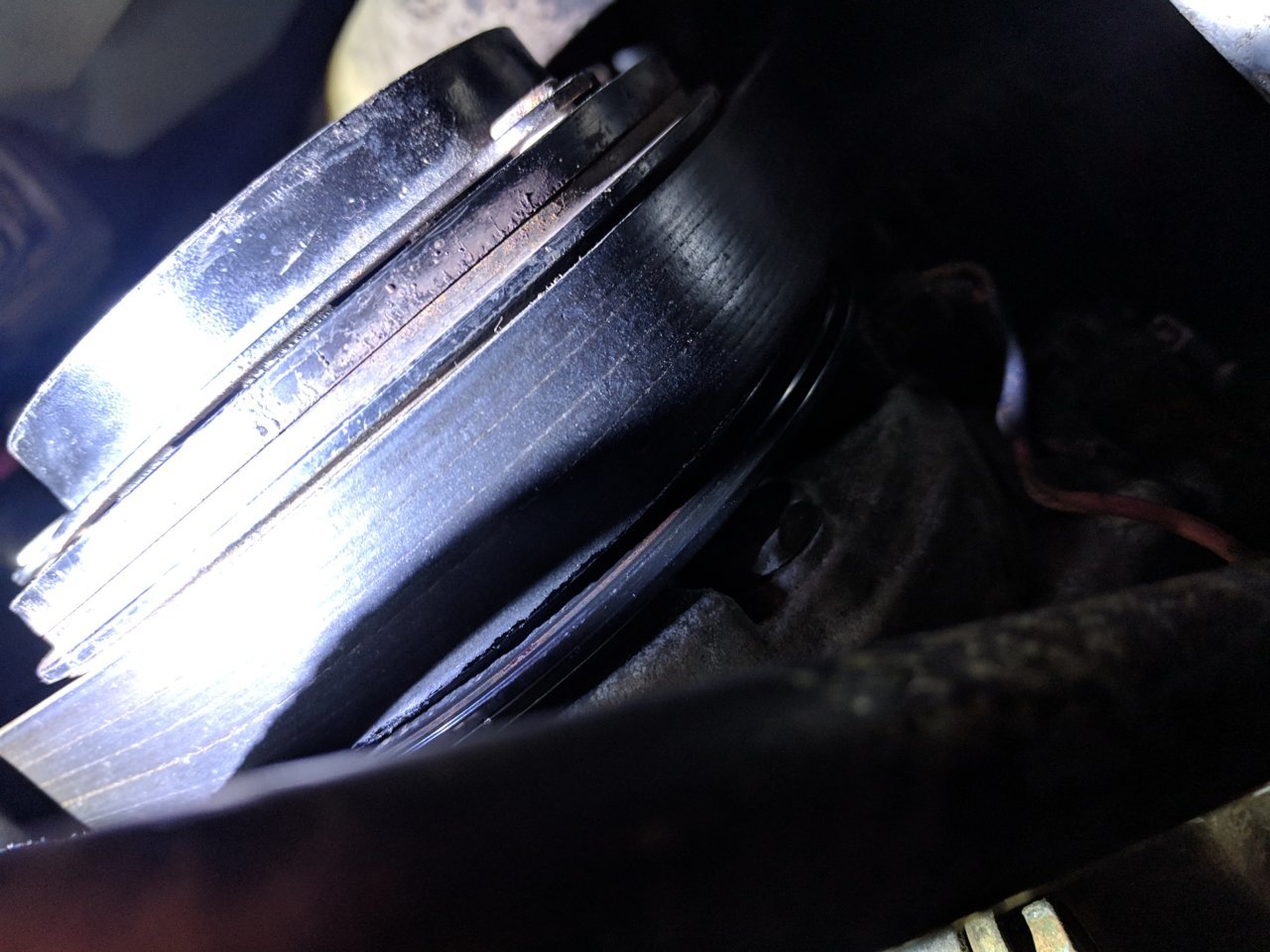

    Putting my good eye on it now. From what I can see it's possibly a c hair off on the ac pump towards the front of the truck. Just enough to cause this. The gap at the back is where the belt separated.

    I can't tell much from the pic, but I think the alignment would have to be pretty far off to shred a belt like that.
