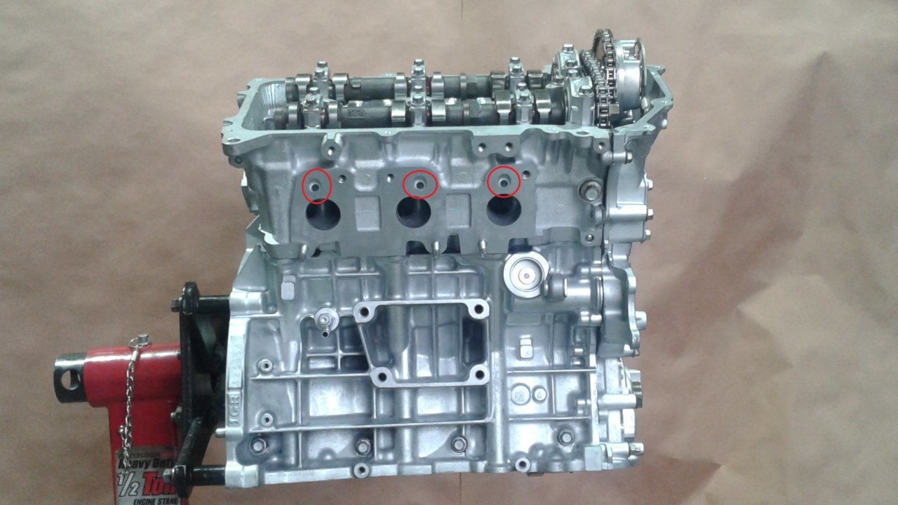

    someone with more knowledge can chime in but from what I understand the 12-15 engine is also compatible after swapping the passenger valve cover and exhaust manifold. so I would search for any 4.0 from 05-15

    You might even be able to get away with using the passenger side valve cover off the 12-15 motor, i think it just has some extra tabs for the smog pump valves to mount on to. You will have to use the 05-11 manifolds as those do not have the ports for the smog pump, or you could use the 12-15 manifolds and make a blockoff for the holes.

    Drivers side valve cover would be easy, but it does look like the heads are different 05-11/12-15. Theres small holes above the exhaust ports for EGR? My 06 headers wouldn't work. Id need factory manifolds or need to buy the 12-15 headers and block off plates.
