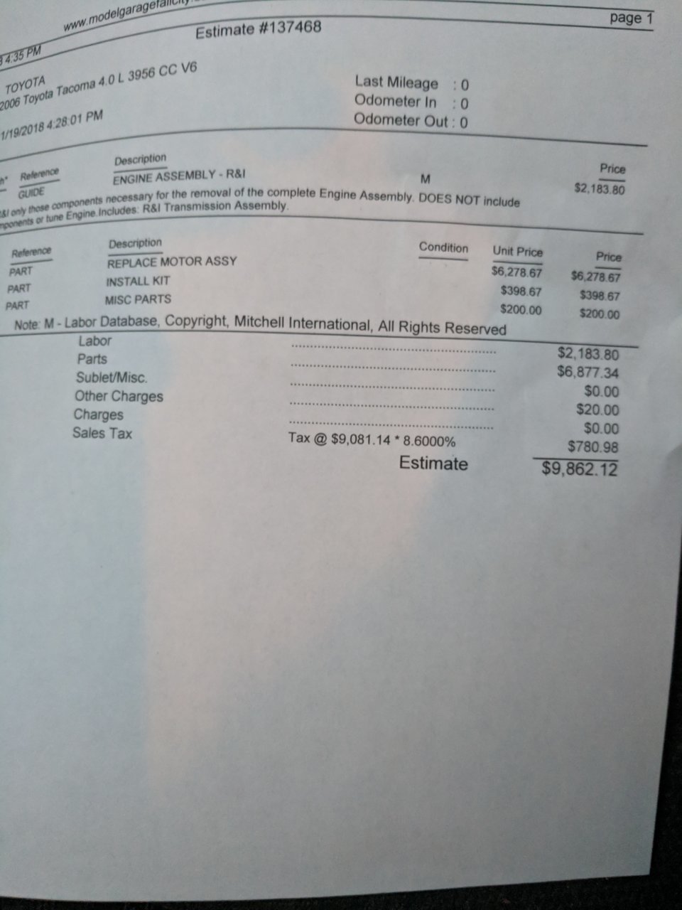

    Yeah I figured that. I’ve already been quoted 3.5ish for a reman and another 2.8 in labor. The Mitchell program estimated 27 hours for the 2.7 but then again, 27 hours seems like overkill.

    This is a quote for a reman installed out the door after tax from a shop a block away from me. $10k!!! They have an outstanding reputation and are good, but when my truck is worth slightly north of what they quoted, I'll do it myself. I'd gladly pay someone else to do this project for me, but crunching the numbers and I'm not shy, I'm in it to win it. I've got a background in heavy diesel, and have been wrenching on my own vehicles, mostly Toyota trucks, and replacing clutches, head gaskets, gear swaps etc... since I was 16, I've touched just about every moving part of vehicles I've owned besides the engine. Never dealt with an efi/modern engine swap tho. I have just about every tool at my disposal and a warm shop to do it in, and at this point I'm up to the family jewels in water with no life jacket. My boss always said if you can't find what you need around here, you don't know what you're doing. I guess I'm on the right track.

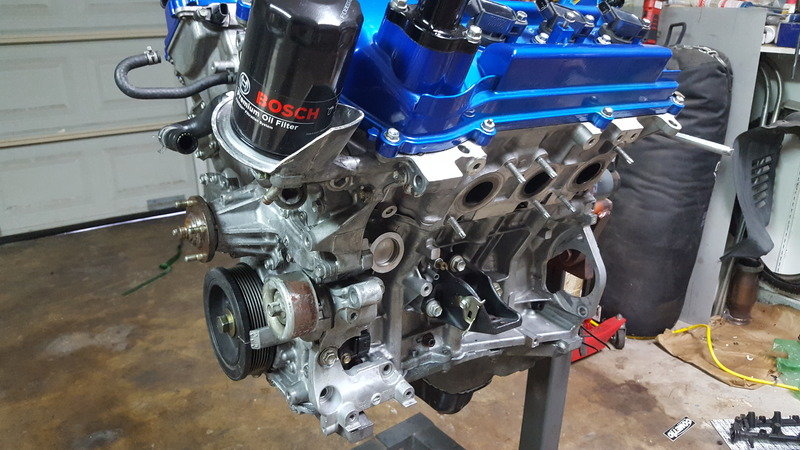

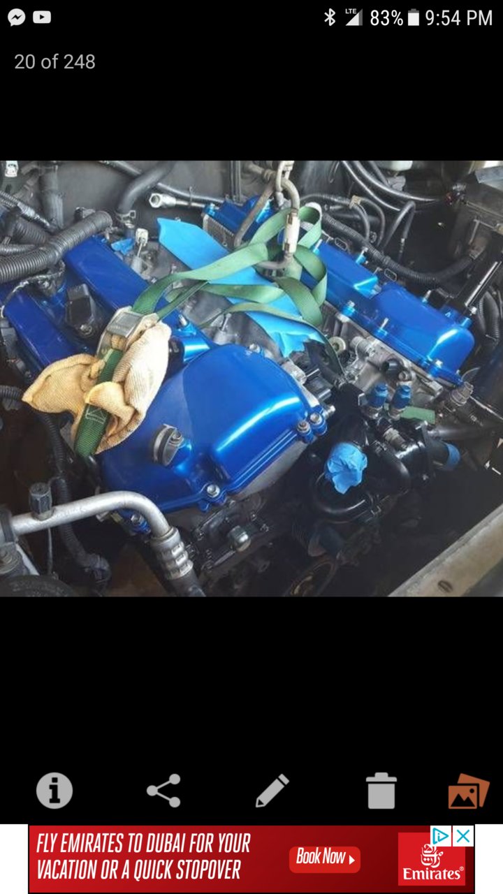

    Yep, I've got it ready to pull, just questioning where to attach the hoist? I plan on removing the engine and transmission together. Something about lifting 800# of engine and trans via chincy lift points on the head scare me. With that much lift on cast aluminum I have my doubts. Any suggestions @Torspd? Can I torch out a lift plate that uses all the studs on the exhaust ports? I've got a few ideas but don't want to drop it all on my fender or core support if I need to use some muscle on the extraction.
    I'd like to keep it simple PNP with my DTLT's. So as much as a low mileage 2015 is attractive, I wouldn't be much better off since I'd need to buy new manifolds/headers. Trying to stick with what I have on hand so 2011 seems to be the route I'm trending.

    Two 3/8 bolts will pull a 350 and transmission out....... Harbor fright is your best friend right now/

    The hole on each head. Use a rag under each strap, if you choose.
