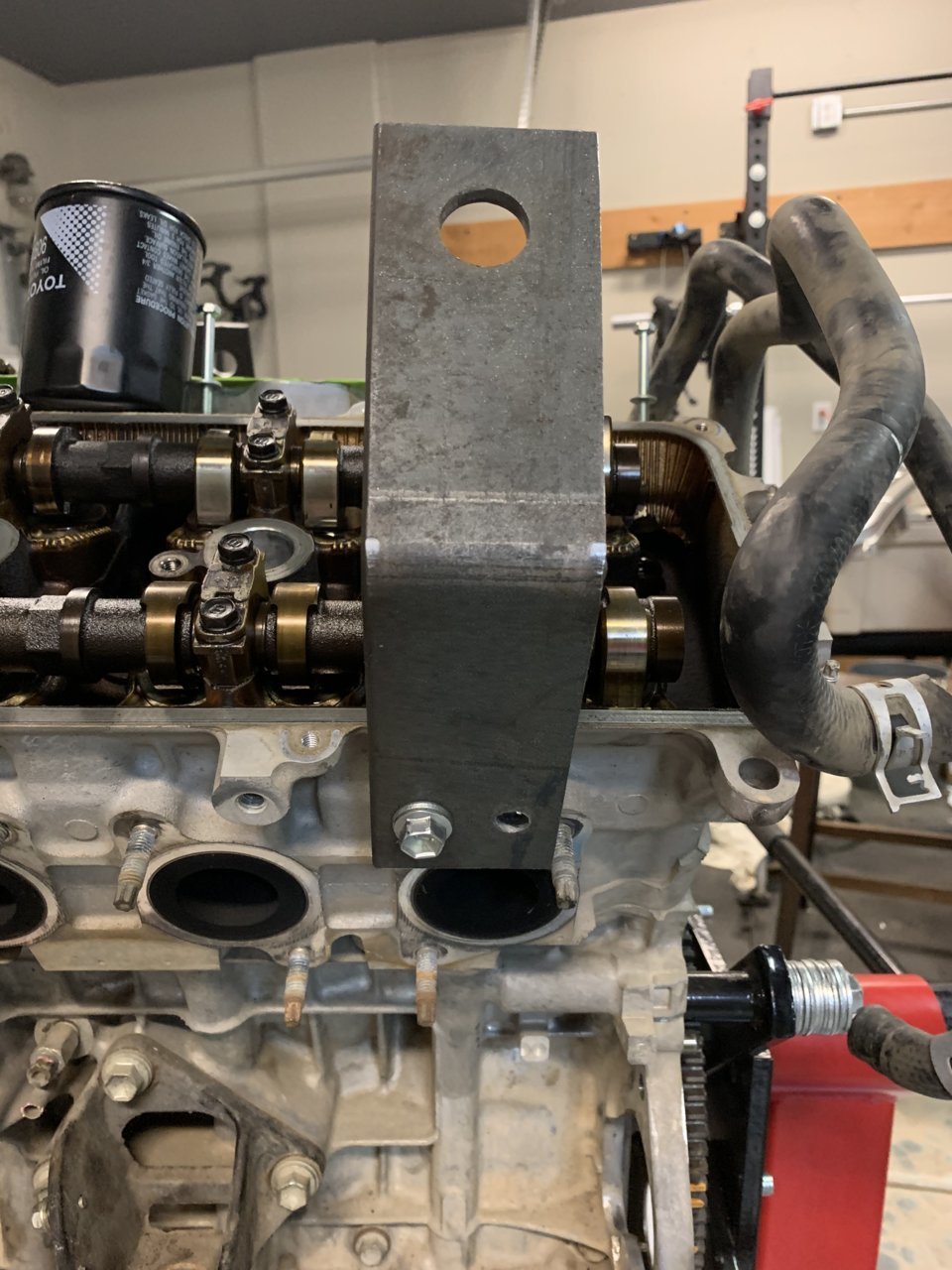

    I've got a fork lift and 3/8 chain. Will a single point of pick using the 10mm exhaust stud on each head be enough to support the wiggle and contort of the combined 800# assembly? I'd rather not ruin my core support or fenders while trying to extract a worthless/blown engine and failing transmission. If it comes down to it, I'll pluck the motor and drop the trans separatly.
    If anything I'll be able to sell the heads or other misc engine components separately providing their undamaged. :fingerscrossed:

    I just had to go through an engine replacement as well for similar, less exciting reasons. I was at 175,000. I found a spotless, absolutely gorgeous 60,000 mile Tacoma take out from New Mexico Tacoma. It was complete, pan to intake, harness, flex plate, and even oil cooler. It cost me $3,000 delivered. Found it on Fleabay.
    For the hooks, I made a set of lifting hooks out of scrap flat bar. Super simple and super effective. Just used a chain between them. Note, I could not use an engine leveler as my cherry picker was not tall enough to pull the engine over the radiator support.
    Good luck, let me know if you have any questions. I literally just got my new setup fired up today. Drove it for the first time in 8 months. So stoked.

    I wouldn’t use the exhaust studs. Use the embossed holes for the intake manifold support. Go diagonally across the engine.
