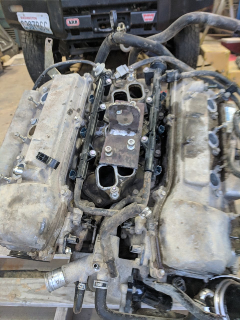

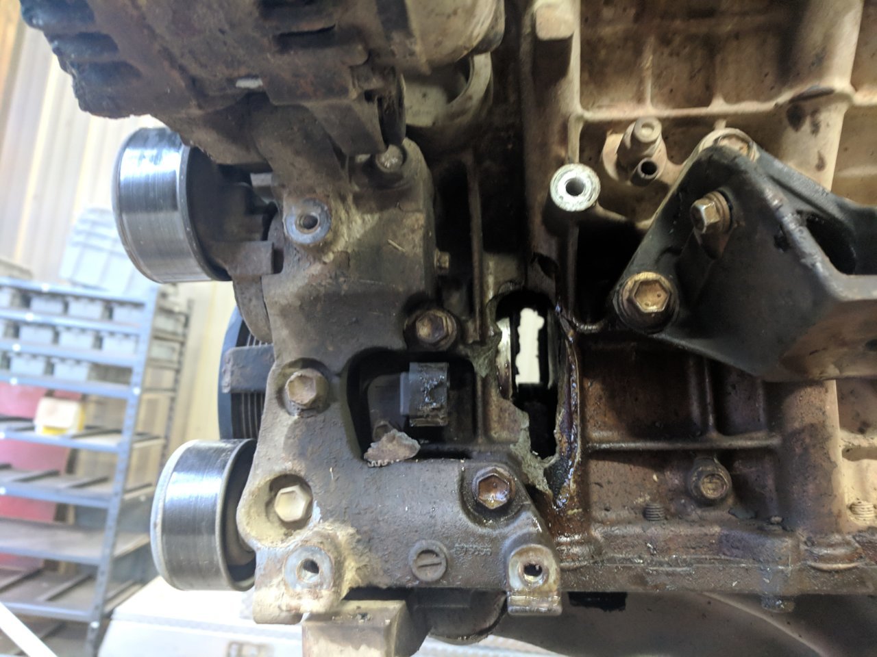

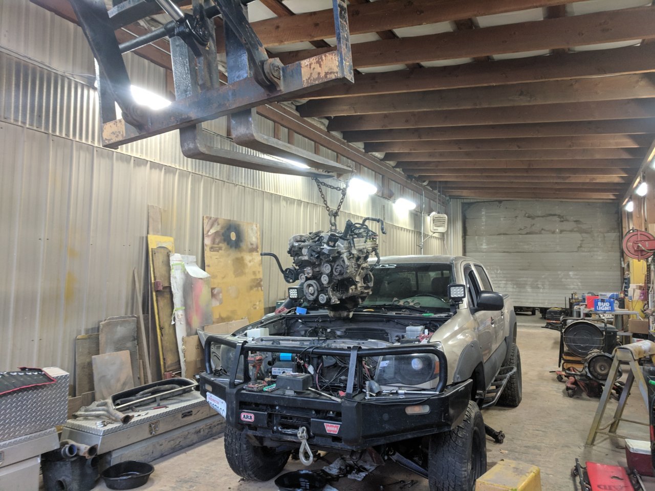

    It's out. Windowed both sides of the block.
    @JimSnell made a lift plate to use the intake.

    With the right tools and equipment at your disposal, it comes down to commitment. I don't have $6k to give a shop, but my work is cool with me doing this. No turning back now.

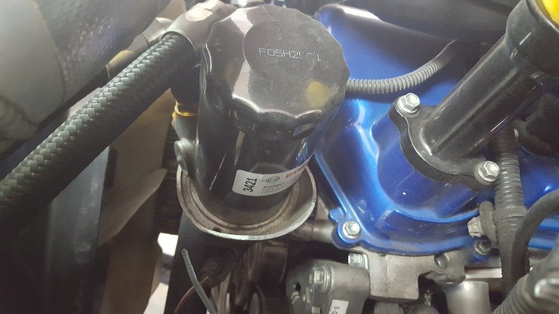

    What oil filter are you running?

    Tor, any advantage to running a larger filter?

    More oil capacity probably:notsure:

    More capacity. Should filter media lengths be the same, of same manufacturers, then the height means more surface area .
