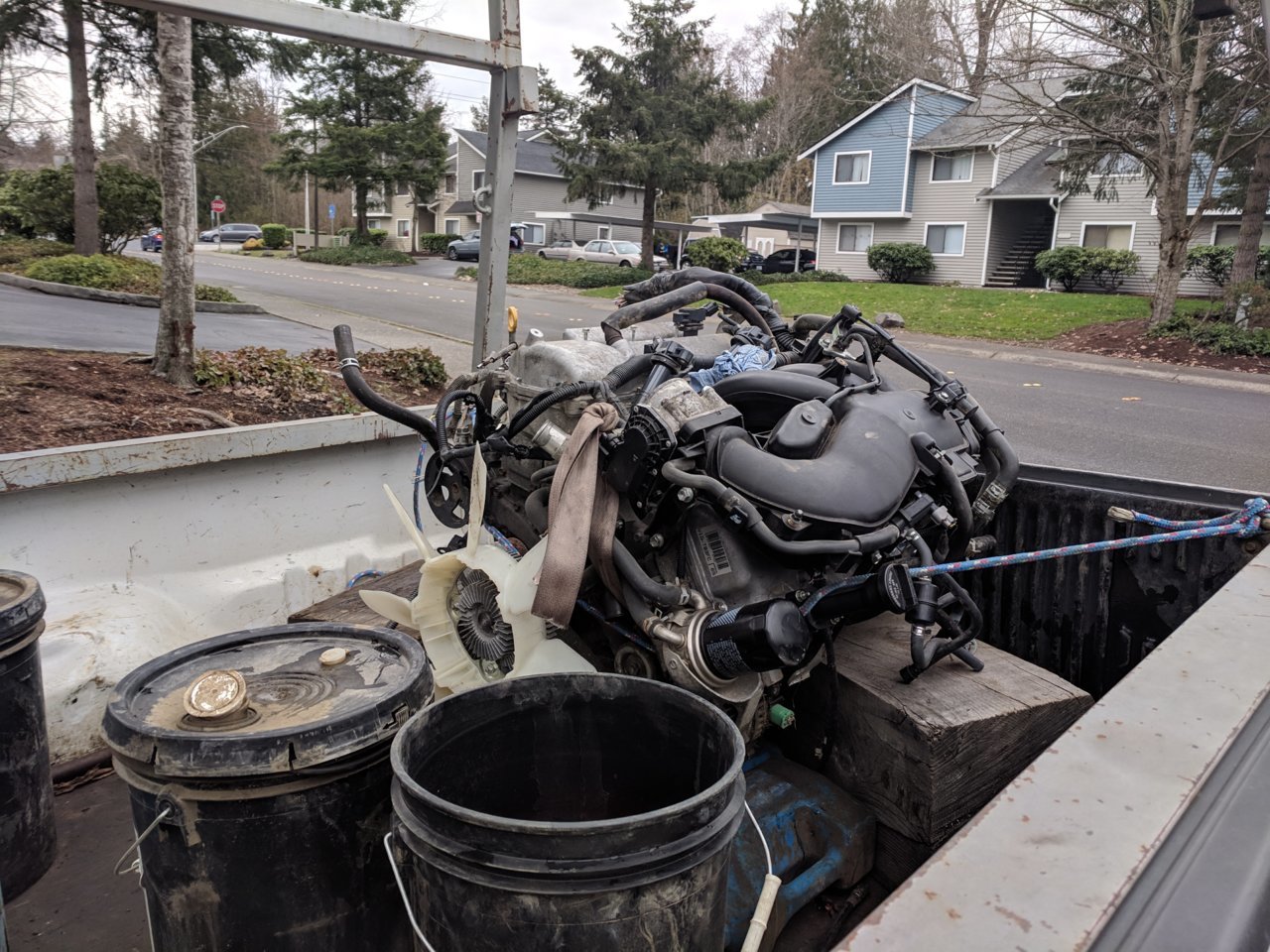

    I'm tentatively picking up a complete engine this weekend from a private party. Pictures show intake/alternator/ps pump and other bolt on accessories included. Should be a PNP solution. Story is that it's a 2008 1GRFE with 40k from a truck that had a tree fall on it. Guy doesn't have a Vin from the salvage truck for me to research background info. I'll be taking a compression tester, and a video scope to inspect the internals such as cylinders and the front cover/timing area.
    Any other suggestions on what to look for, or to observe that could confirm the sellers story of 40k miles? He actually has the engine and transmission complete and is asking $3500 for both. He said he would separate them and has agreed to my sight unseen offer of $2k for just the engine. If anything's off or doesn't look right, I'll try to negotiate the price lower or just walk if it's got issues.

    Pull a valve cover and look for sludge and burnt oil. If the engine has sat for a while, you could take a garden sprayer with a 1/4” barbed to male 1/8” npt fitting, and push oil into the oil sensor port to lube the bearings while checking for compression. Sprayer and fitting should be $12, so cheap insurance

    A starter, and a battery to crank it to test compression.
    12mm and 10mm.

    You'll be able to tell when you pull the spark plugs. If one side is Denso and the other NGK it's probably low mileage since those are likely the original plugs. They are all the same brand they've been changed since it left the factory. The specified plug replacement interval is 60k on the 1GR, so if it's still the OE mixed set 40k is plausible and the chance of being high mileage is smaller.

    New motor. 2010. Still had the ngk denso plugs and a oem filter.
