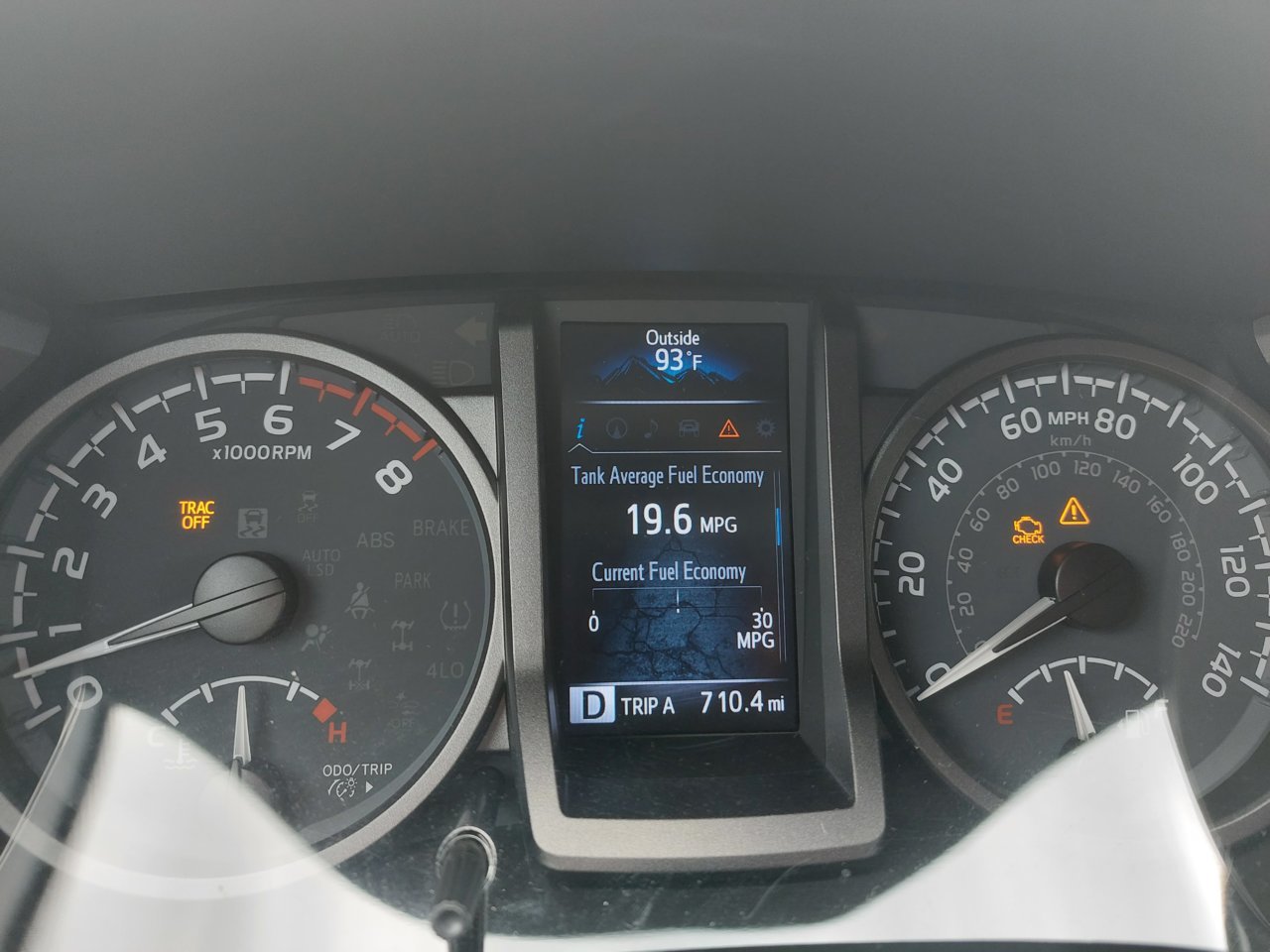

    I started to work this morning and immediately noticed my truck felt like it had a tire out of balance in the back. Felt it through the seat of my pants and not through the steering wheel.
    2020 3.5 V6 Auto. 16,000 miles right at 2 years old never a single issue All tires showing 36-37 psi. At around 1500 rpm it feels like it has a misfire or more to the point. A tire out of balance. If I mash the accelerator and let it shift down and the rpms climb to above say 2000 it immediately smooths out. So no tire issue. No dash lights other than the service reminder to rotate the tires. (oil changed at 7K & 14K). When I got to work I also notice it seemed to be idling a little rough. Filled up with gas about 10 days ago, down to about 1/2 a tank. No issues till this morning. If it keeps doing it I'll take it by the Dealer.
    Anyone else experience this or similar? Possibly a little bad gas. I did just for poo's and giggle's remove and retighten the gas cap just before I went into work. Thoughts?
    [EDIT] Check engine and traction control off lights both on now. Still on after restarting.
    [EDIT] #2 & #6 Cylinders failed compression test.
    Dealership opened a case with Toyota Corporate.
    [EDIT] Truck is repaired at the 10 day mark as promised.

  10. Jul 28, 2022 at 1:55 PM
    TRD-ED
    TRD-ED [OP] Well-Known Member
    Sep 12, 2016
    #197086
    3,315
    Lenoir NC.
    2020 Army Green TRD PRO - 2023 Genesis GV70
    Stock FOX 275/65/18 At3w 18X9 Fuel Vapor's
    Well on the way home it got worse and this popped up. But by the time I got home (11 miles) it was running almost perfect. But this didn't go away. Even after a restart.
  11. Jul 28, 2022 at 1:56 PM
    JJ Customs
    JJ Customs Supreme Leader!
    Feb 24, 2008
    #4935
    5,791
    Jay
    NV
    Sierra Denali Ultimate, 6.2
    A few additions to make me feel cool.
    Its pissed! Take it to the dealer or have it towed in on their dime. No need for you to even worry about this.
