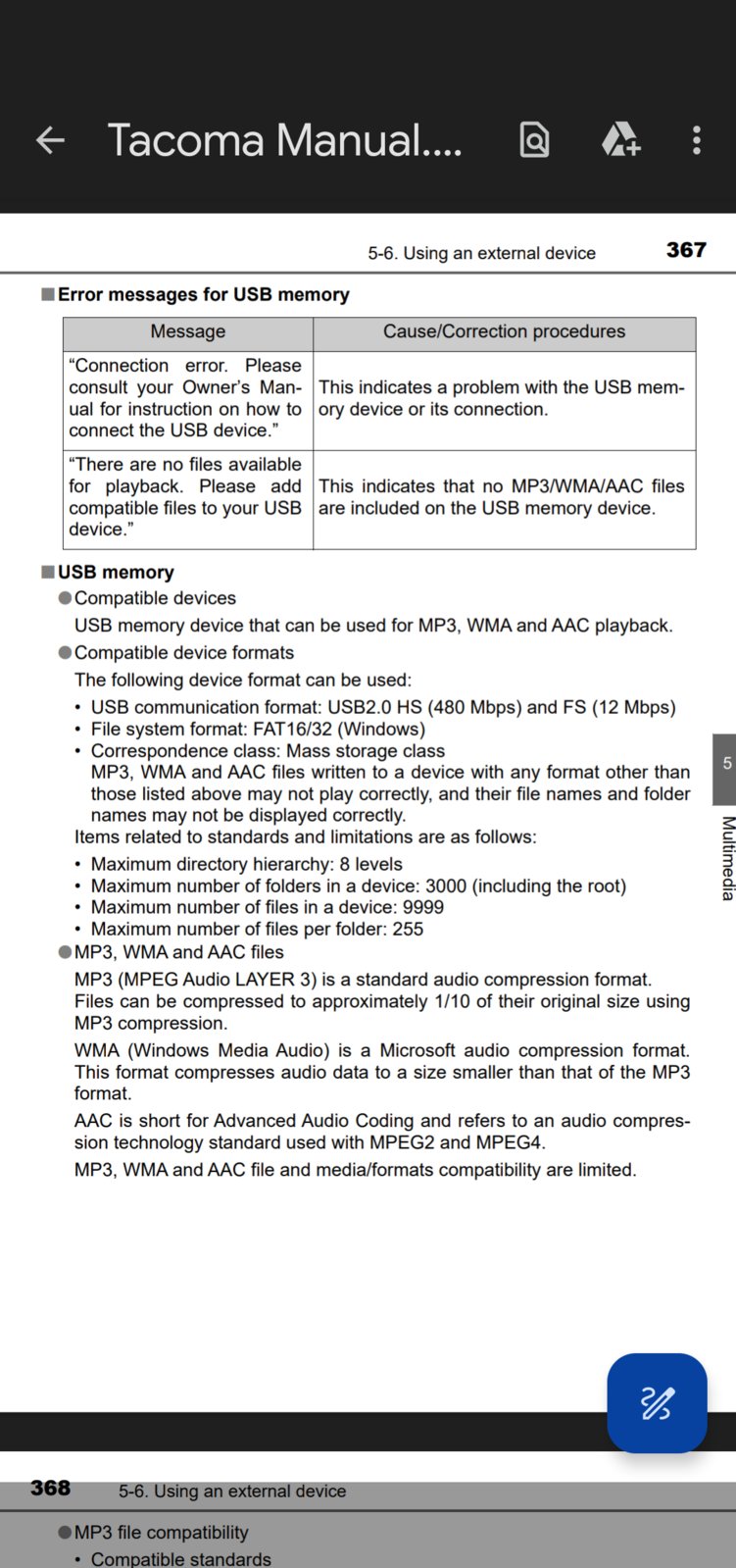

    If you have a '19 with the original HU it only supports MP3, WMA and whatever the Apple equivalent of those two is. No high resolution files like FLAC, WAV, etc.
    Edit: Apple equivalent is apparently AAC. See below.

    I actually decided to just put a song from about 5 different types and see what played, which is only MP3 and WMA files. I didn't expect it to play the FLAC, but I'm really disappointed it won't play WAV files. You'd think at this point it would play just about everything...
