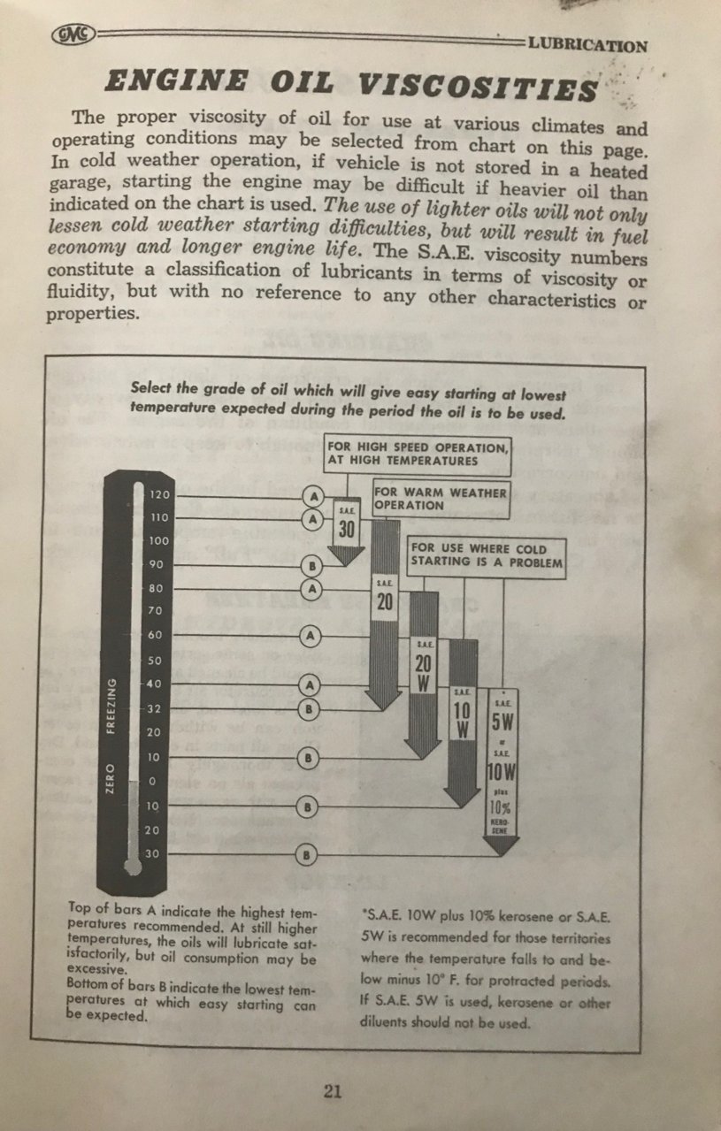

    From a 1951 GMC pick-up Owners manual. Things just have not changed that much in 70 years, kids.51 GMC oil chart.jpg
    Chuy likes this.
