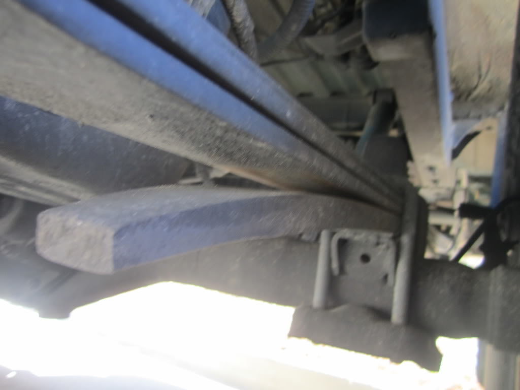

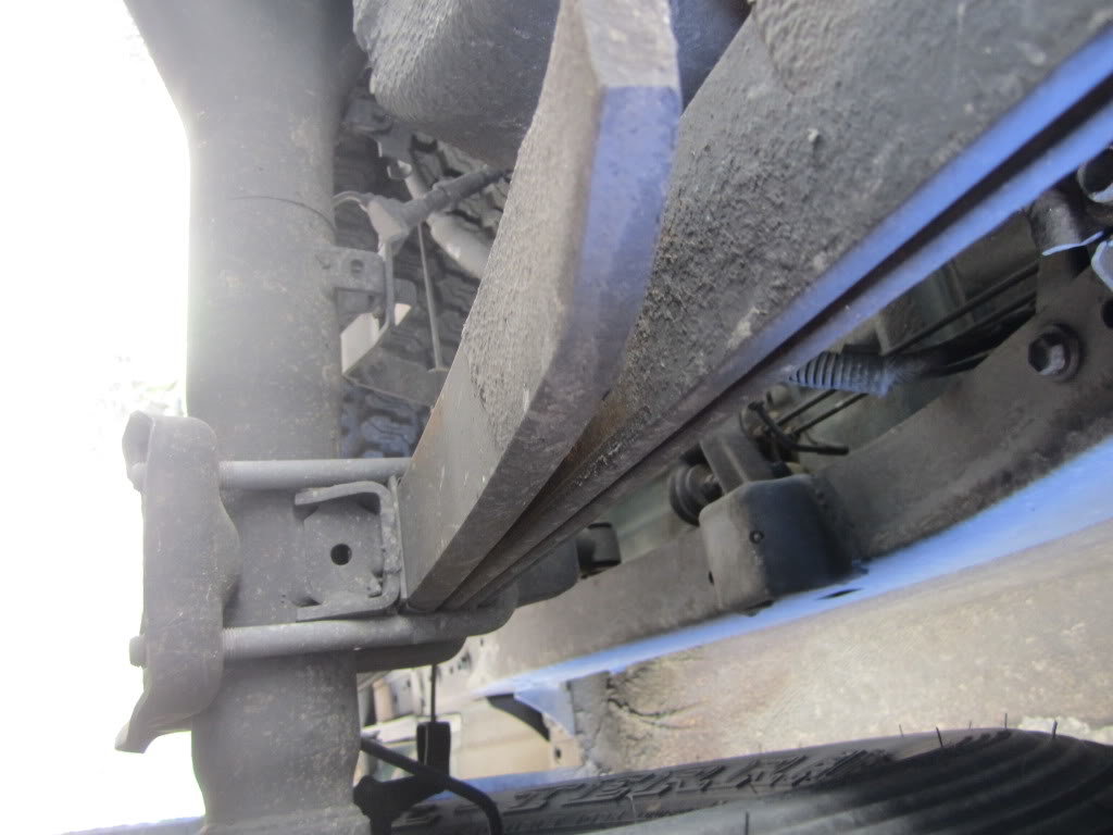

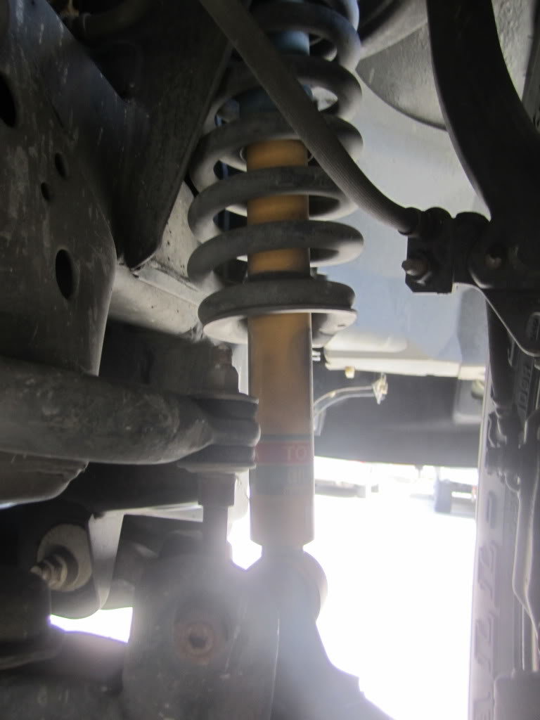

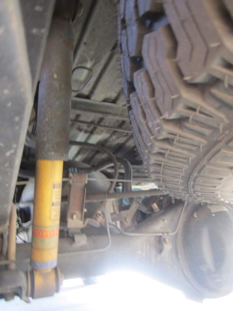

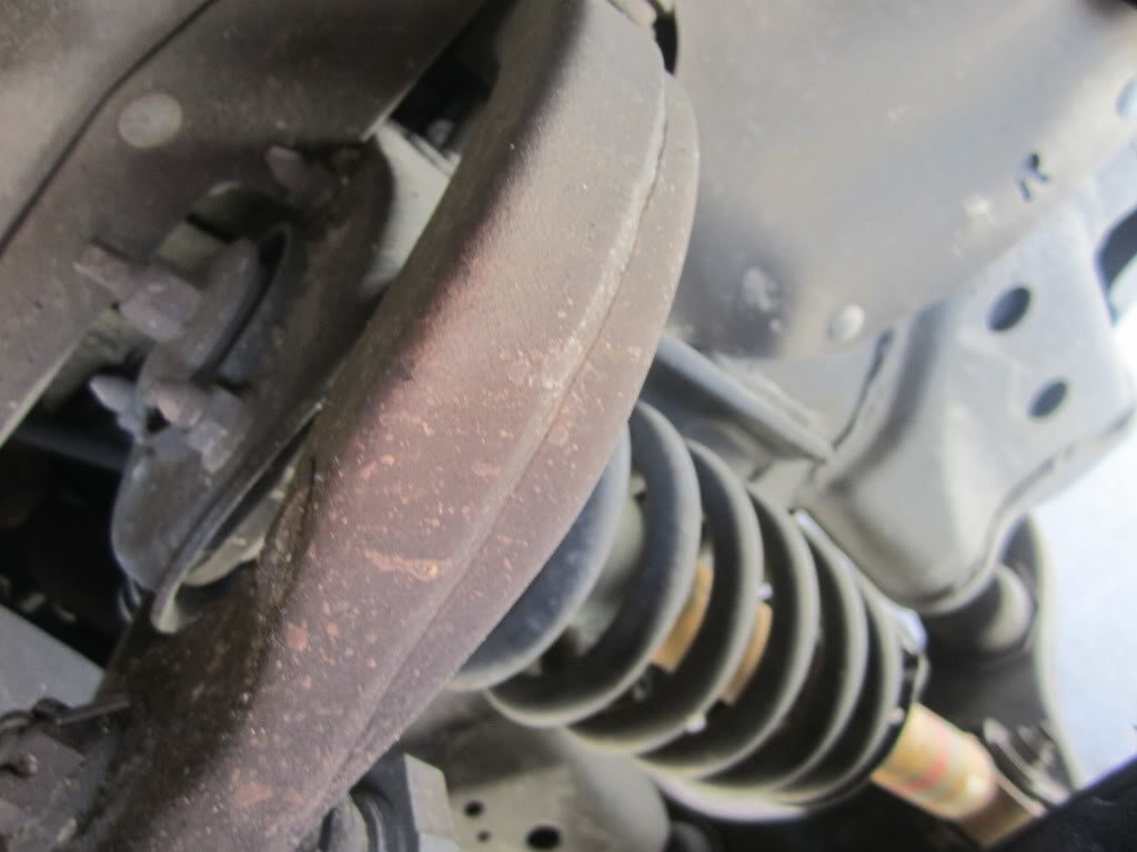

    Those are deffinatly the stock TRD shocks and your truck actually looks pretty level, Is there a Spacer on your front coils?

    Yea there shouldnt be a problem with 4 5100's you will just need to put your fronts at the 2.5 setting, and this way you can order it all through DSM where you get the kickass discount code and free shipping.
    Just look up on top of the front coils where it mounts and it should be noticable, but if there is a spacer then there is likely somethin in the rear shackle, block, AAL. I just couldnt tell from the pic you posted of the rear shock.

    yea get one of the top of the front coils and then get one of the leaf packs and shackles

    looks stock to me.
