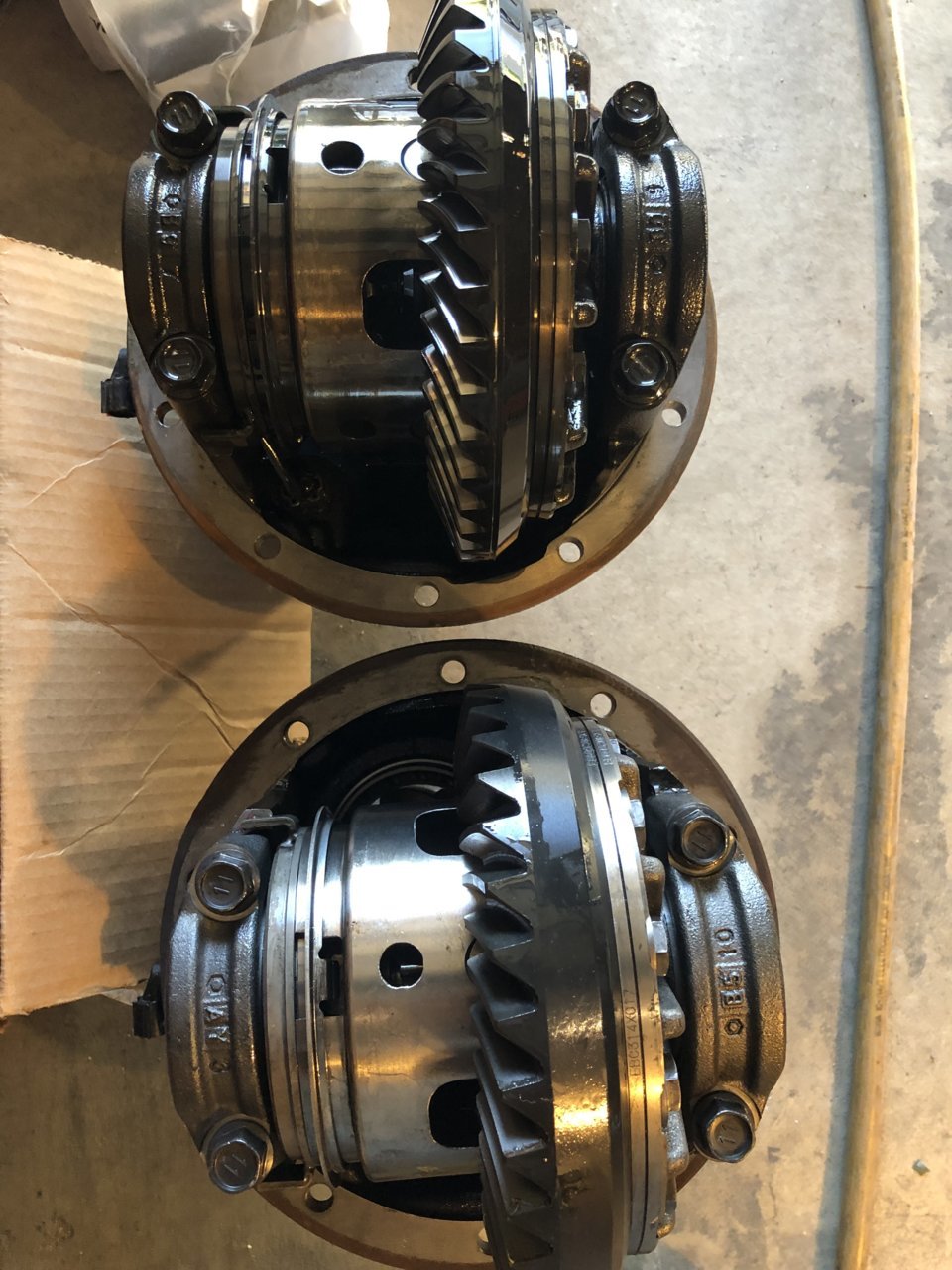

    Pretty night and day. The 5.29s are just beefy!.

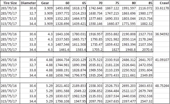

    Welp...it helped...but it made me want 4.3's lol Yeah I think 4.88s sounds like the way to go for me...This chart is 3rd gen tacoma specific right?

    Well then..I certainly dont want that? Did you see the pic above that compared OEM to 5.29s?

    True. The 8.75 is a lot bigger.
    Wixo[QUOTED][OP] likes this.

    it's a cool pic and i'd love to see more. There was definitely a little bit more going on to mine grenading than just the regear but it was a factor. To me the weakness isn't going to manifest in the ring but in the pinion. A work around is to cryo treat the gears, but it's an added cost. All of this may be moot, a lot of people have done great with 4.88s and 5.29s and there's no doubt it puts a little zip in the truck....but then there's always a turbo for that hahaha

    You wouldn’t even notice a difference with 4.3’s and the double overdrive. I ordered 4.88’s and I’ll NEVER go bigger than 33’s
