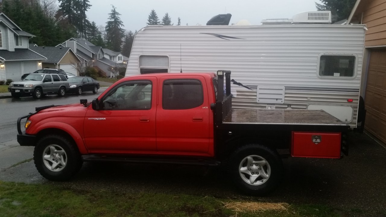

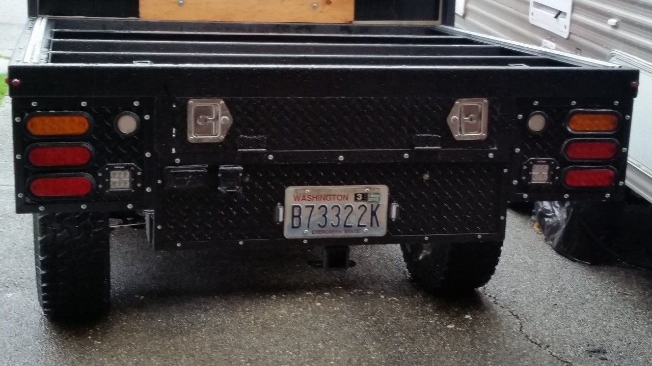

    04 DC 4x4, Flatbed, auto, teardrop tugboat.
    Flatbed, Bilstein/OME 883 lifted, ARB bumper, Warn M8000, Onboard air, Onboard water system, Lights, Lights, Lights
    Have been working on this since August 17
    It has a cabnite in the back that holds my D handle shovel, axe, and 48 inch Hi-lift, with space for several Maxtrax that have yet to be purchased (the space is currently occupied by a snow toboggan). Towards the front of the bed, between the rails is a 12 gallon water tank, RV water pump, air compressor, and an auxiliary battery, and under the cabnite in the back, above the hitch, is a 5 gallon air tank. The back wall, includes covered outlets for the water, and air, a trailer connection, as well as a remote power outlet, connected with 2 gauge wire for the ability to run an 8000 lb winch on a removable hitch tray, or jumper cables. 20171020_163534.jpg
    It is still a work in progress, I am building removable drop sides, and tailgate next.

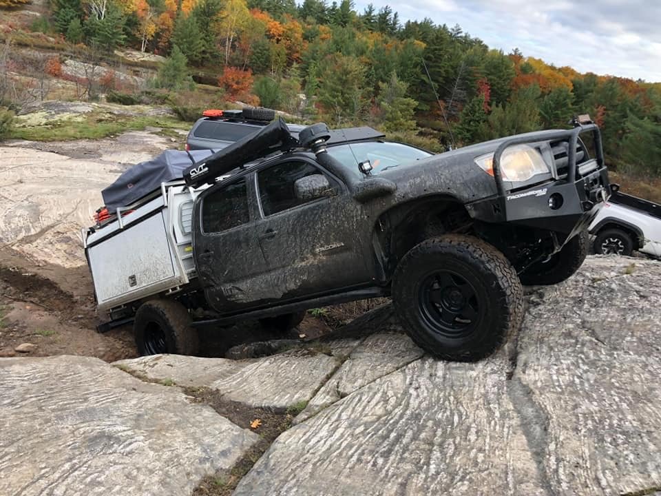

    Little more work has been done on my setup
