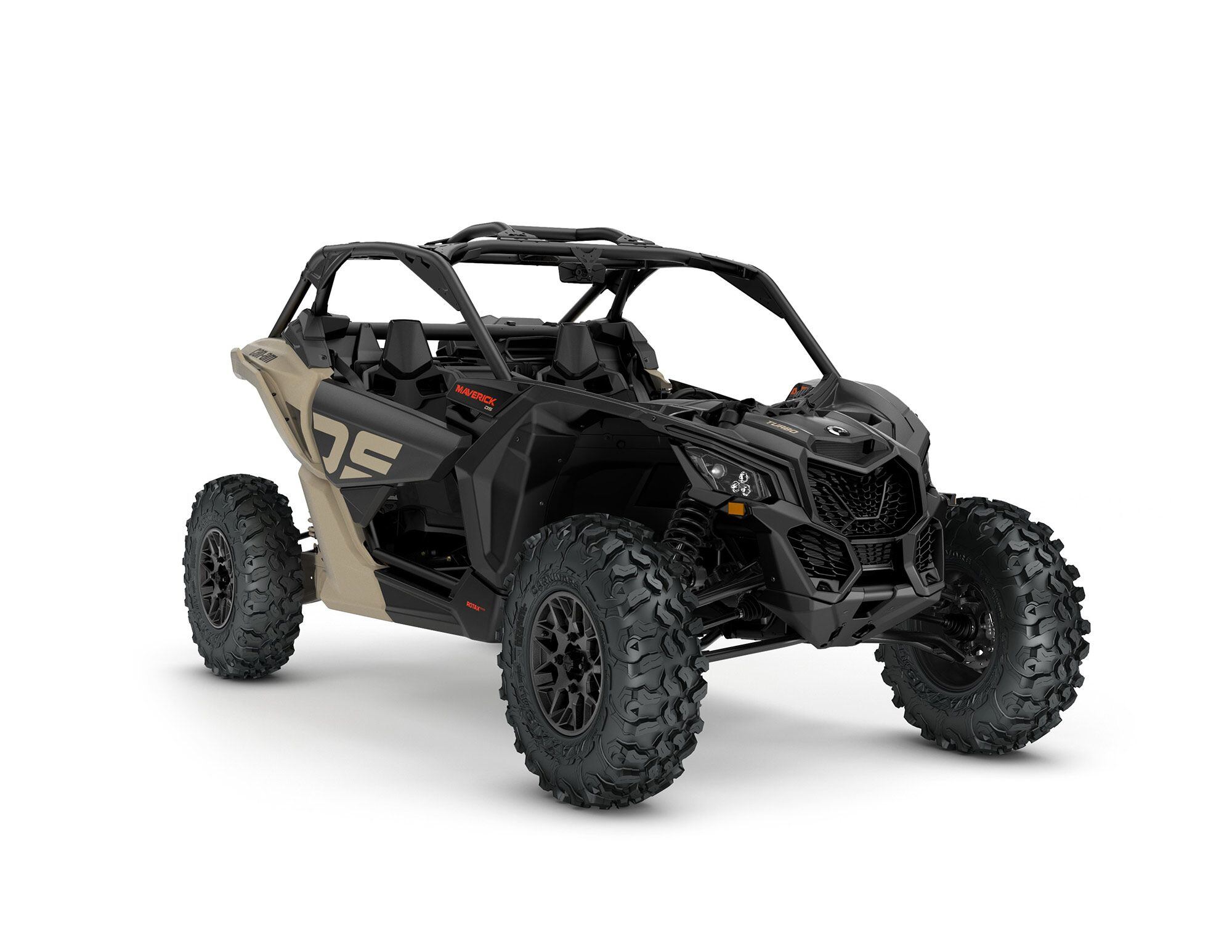

    Buy this for less cost and a whole lot less heartache. Tow it to the trails. Thrash it as you please, who cares, it isnt your daily. Tow it back home. Profit.
