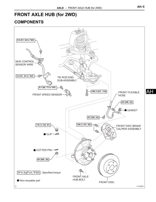

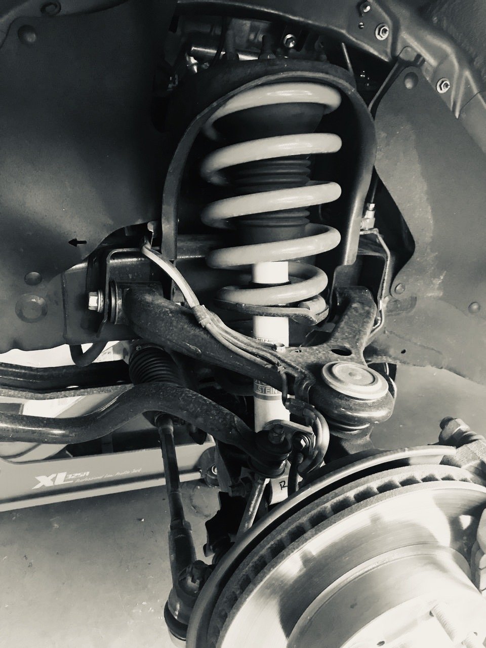

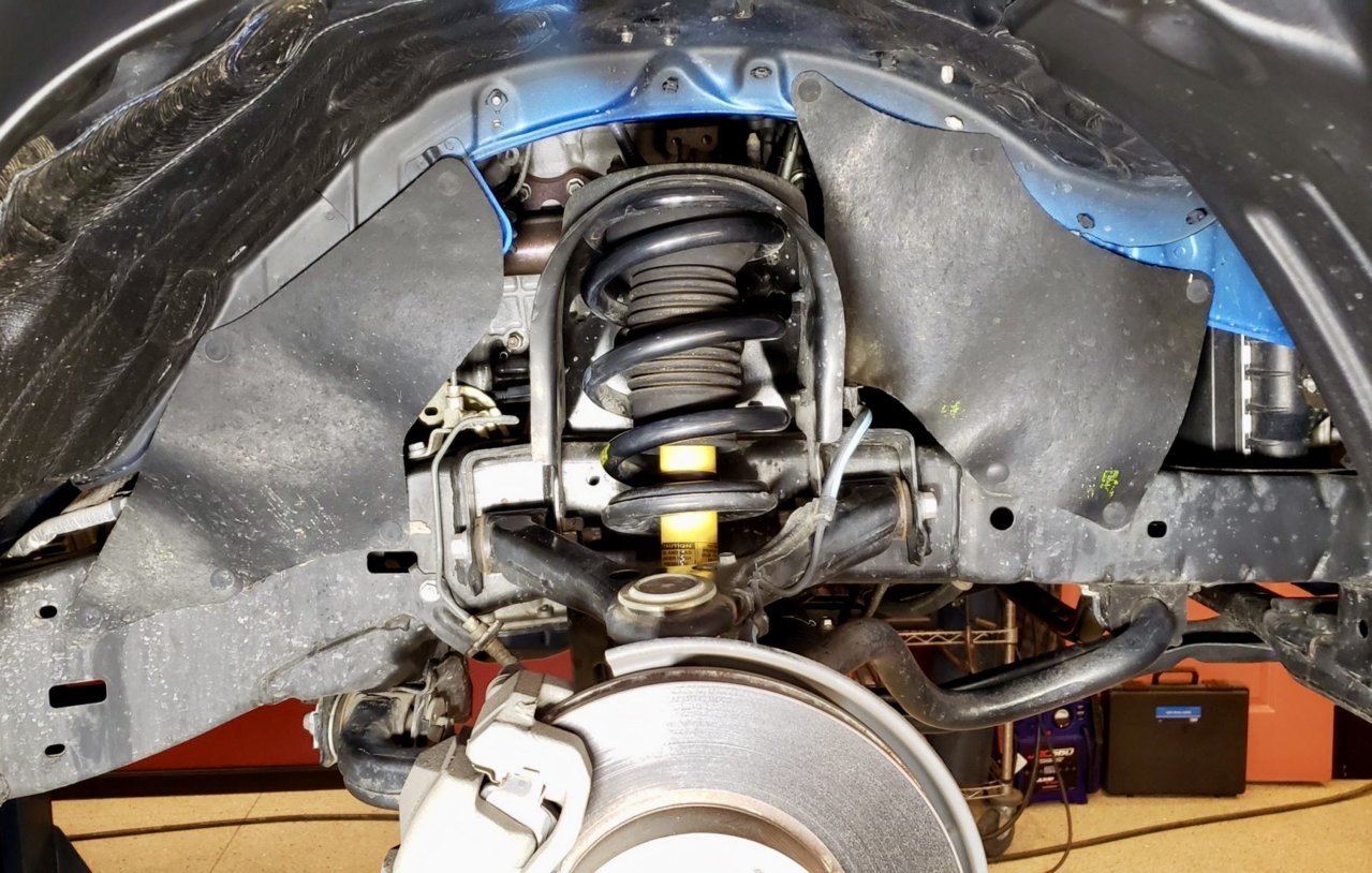

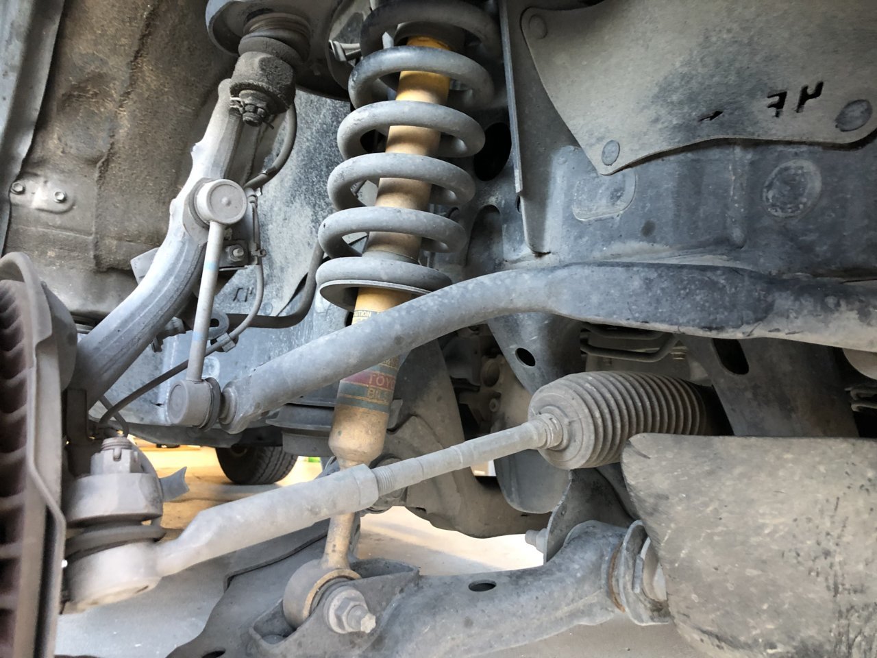

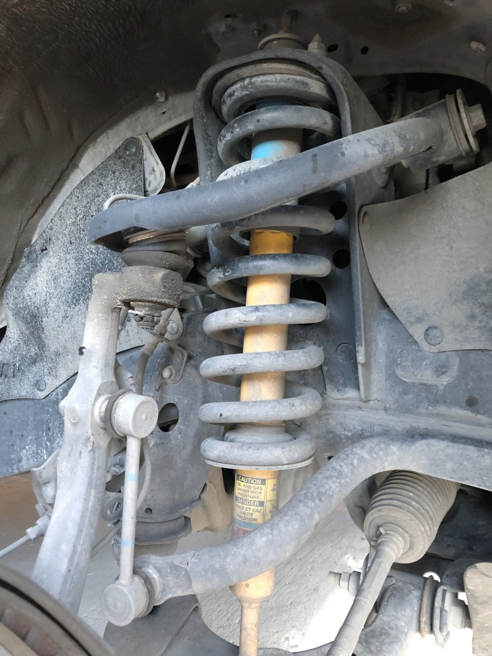

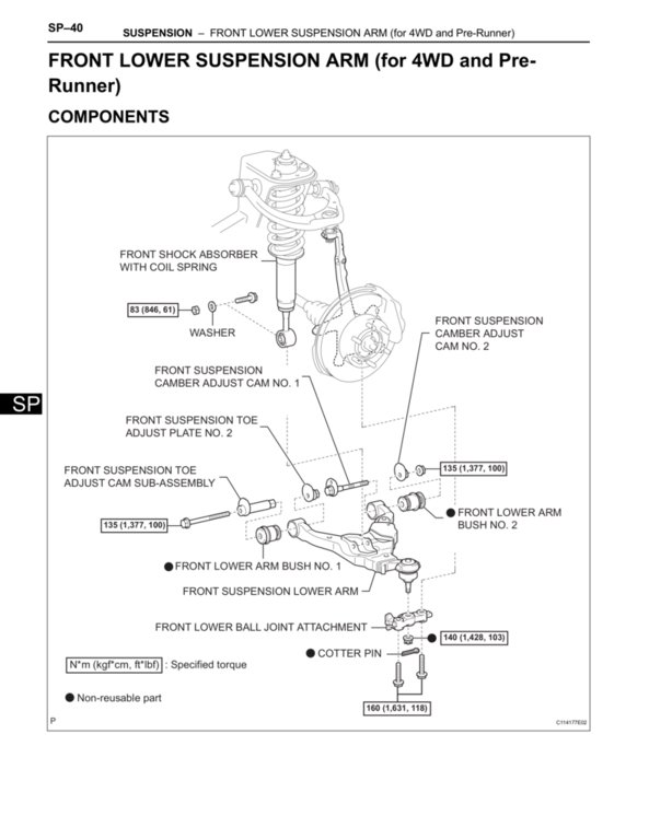

    Just incase someone else is researching the difference between the Tacoma 5 lug suspension and the 6 lug suspension, I am going to share some pictures of the front suspension.
  5. Nov 21, 2020 at 12:09 PM
    #25
    sshadow69
    sshadow69 [OP] Well-Known Member
    Nov 10, 2019
    #310360
    307
    S
    Dallas, TX
    X-Pre-Runner
    X-Runner rolling chassis swap
    There is a diagram of the front 6 lug suspension
    Here are some pictures of the 6 lug front suspension

    There is a diagram of the front 5 lug suspension

    Here are some pictures of the 5 lug front suspension

    Some of the most obvious differences are the mounting location of the upper a-arm. On the 5 lug suspension it is mounted to the frame below the shock bucket but on the 6 lug suspension it is mounted to the top of the shock bucket. This requires a long extension from the knuckle to the upper a-arm on the 6 lug suspension and a much short one on the 5 lug suspension.
    deanosaurus and Pickeledpigsfeet like this.
  10. Nov 21, 2020 at 12:21 PM
    #30
    sshadow69
    Nov 10, 2019
    #310360
    307
    S
    Dallas, TX
    X-Pre-Runner
    also notice the difference of where the rack and pinion is between these 2 different suspensions. On the 6 lug it is mounted in front of the a-arms and on the 5 lug it is mounted behind the a-arms.
    Pickeledpigsfeet likes this.
  11. Nov 21, 2020 at 12:27 PM
    #31
    sshadow69
    Nov 10, 2019
    #310360
    307
    S
    Dallas, TX
    X-Pre-Runner
    some other obvious differences are the height of the factory springs.. on the 6 lug, they are much taller and on the 5 lug much shorter just like the upper knuckles on both respective suspensions. Plus the 6 lug suspension has an extension to lengthen the factory shock for this extra height, while the 5 lug suspension doesn't.
  12. Nov 21, 2020 at 12:37 PM
    #32
    sshadow69
    Nov 10, 2019
    #310360
    307
    S
    Dallas, TX
    X-Pre-Runner
    as far as I can telling with all my research on model numbers... none of the major suspensions parts are same between the 2 different suspensions... so you can not just swap out parts to lower a 6 lug suspension and maintain the correct geometry... for this reason, I am going down the avenue of doing a full rolling chassis frame swap on my Tacoma to get me that lower stance of the X-Runner and get me that truck that Toyota never built. Hopefully, this information is useful to others that maybe considering this.

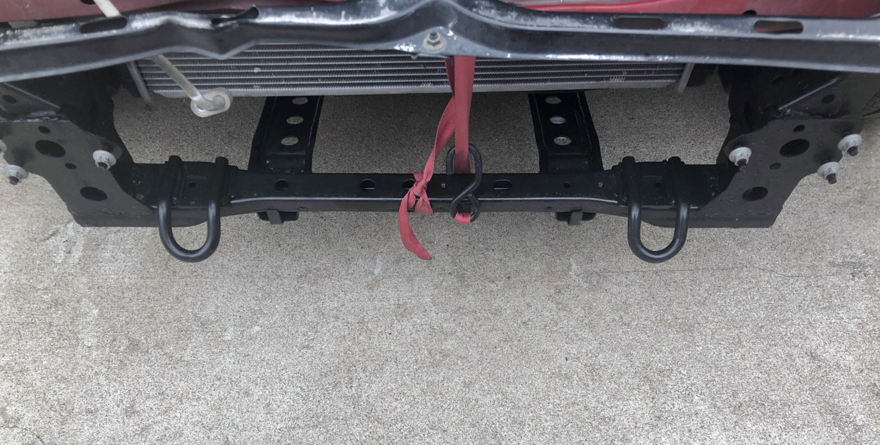

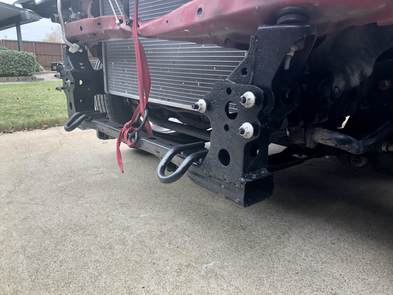

    Next step of this swap is complete. I just got the donor X-Runner back from the frame shop and the small bend in the front frame cross bar is completely replaced. They cut it off the old one and welded back on a Toyota replacement along with left and right end plates. Then they checked the whole frame to make sure it is within factory specs. I wanted this done before I move on.
