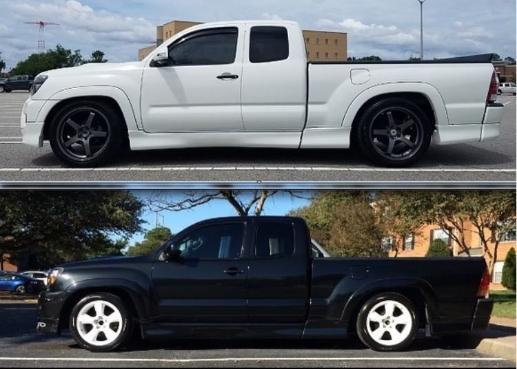

    Where did you get the front springs from? How do you like the composite rear leaves? Sound very similar in lowering height as the Tundra Racing kit at 1.5 front 2.00 rear. What made you go the way you did?

    I bought my suspension parts from XII Performance a few years ago. They slowly faded away and shut down maybe almost 2 years ago just selling off what they had left in stock. I'm not really into slammed vehicles so I just lowered about 2" to close the wheel gap then when I got tires and wheels I closed the gap some more and ended up getting higher off the ground..... If I parked next to another X-Runner I will be the same height if not higher. The composite leafs are great not only lighter but handle better than OEM. There used to be 2" steel drop leafs, but I missed the group buy.

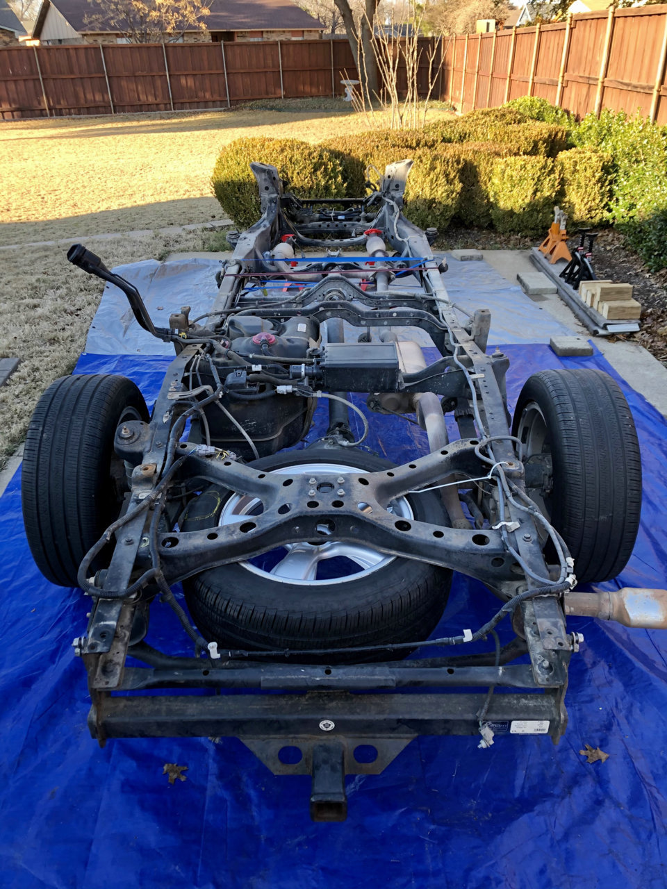

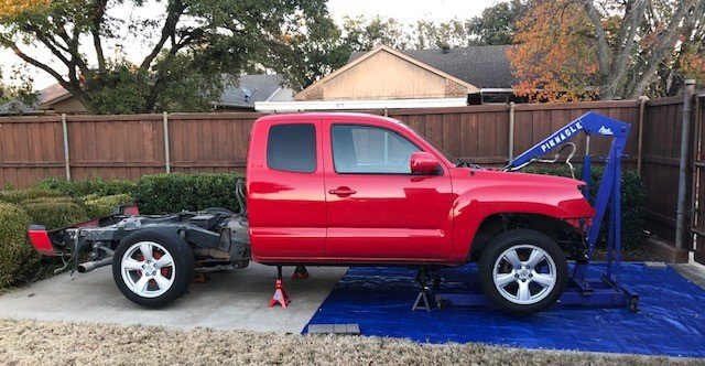

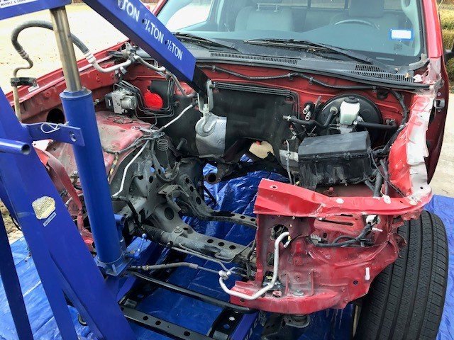

    The project is coming along slowly. Removed the engine and transmission this weekend, also removed the bed.14568723564552585.jpg 9736444783.jpg

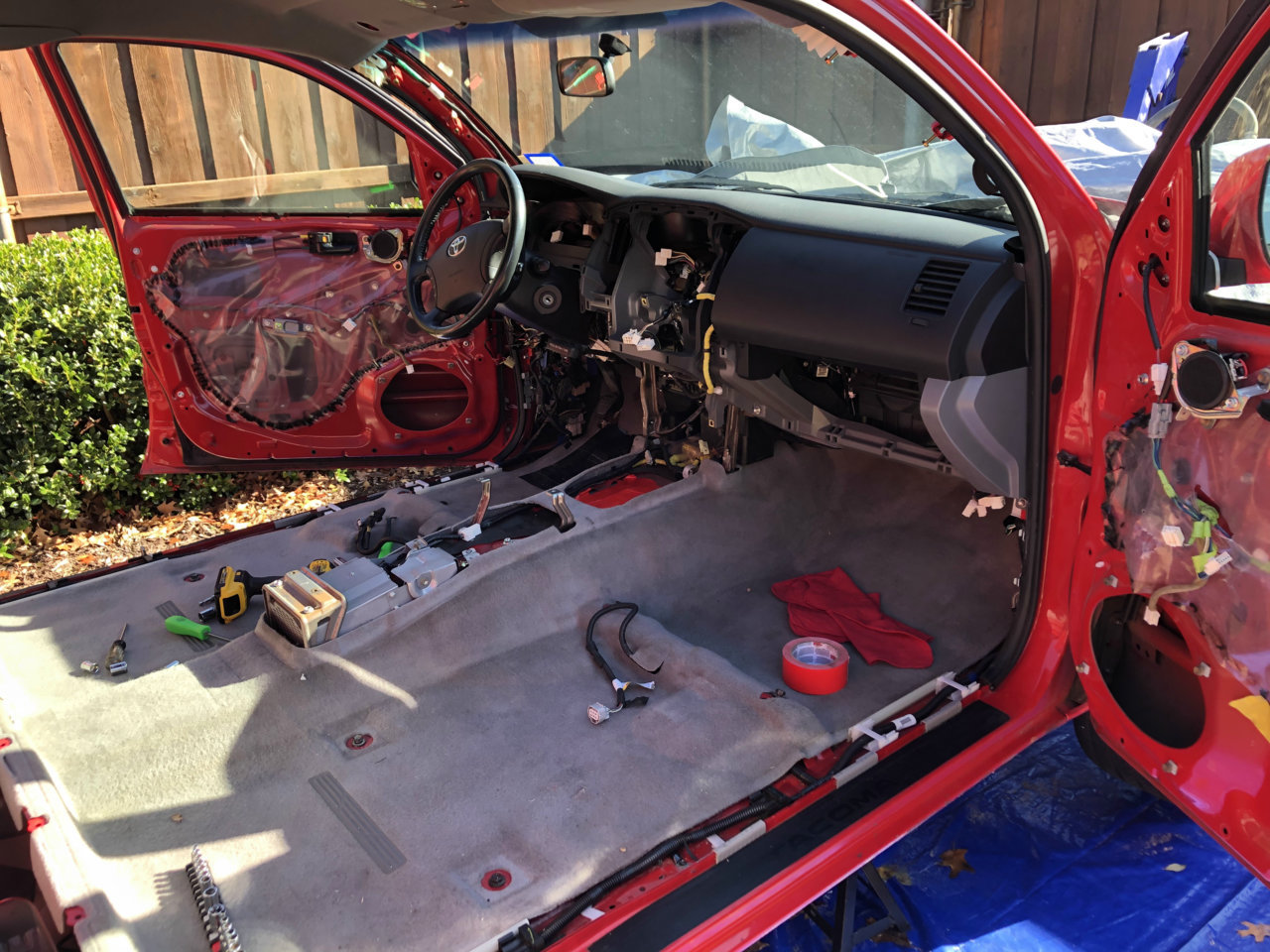

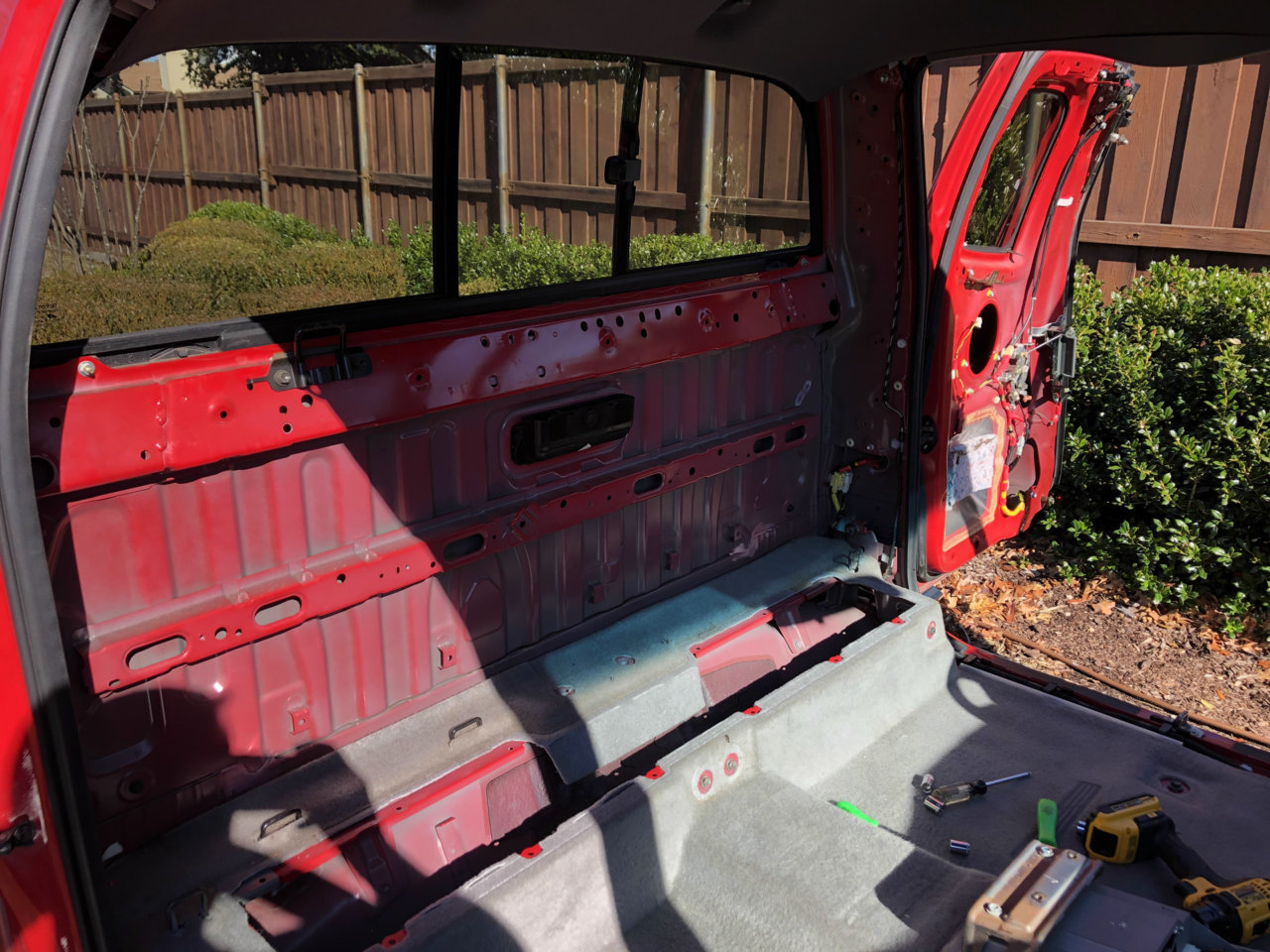

    Had time to work on the project, today. Stripped lots of the interior to lighten the load, so that we can pull the cab off the rolling chassis. I think I disconnected everything that would prevent this lift from happening. Hopefully if all goes well, we may be able to remove the cab from the chassis next weekend. The project is creeping along.

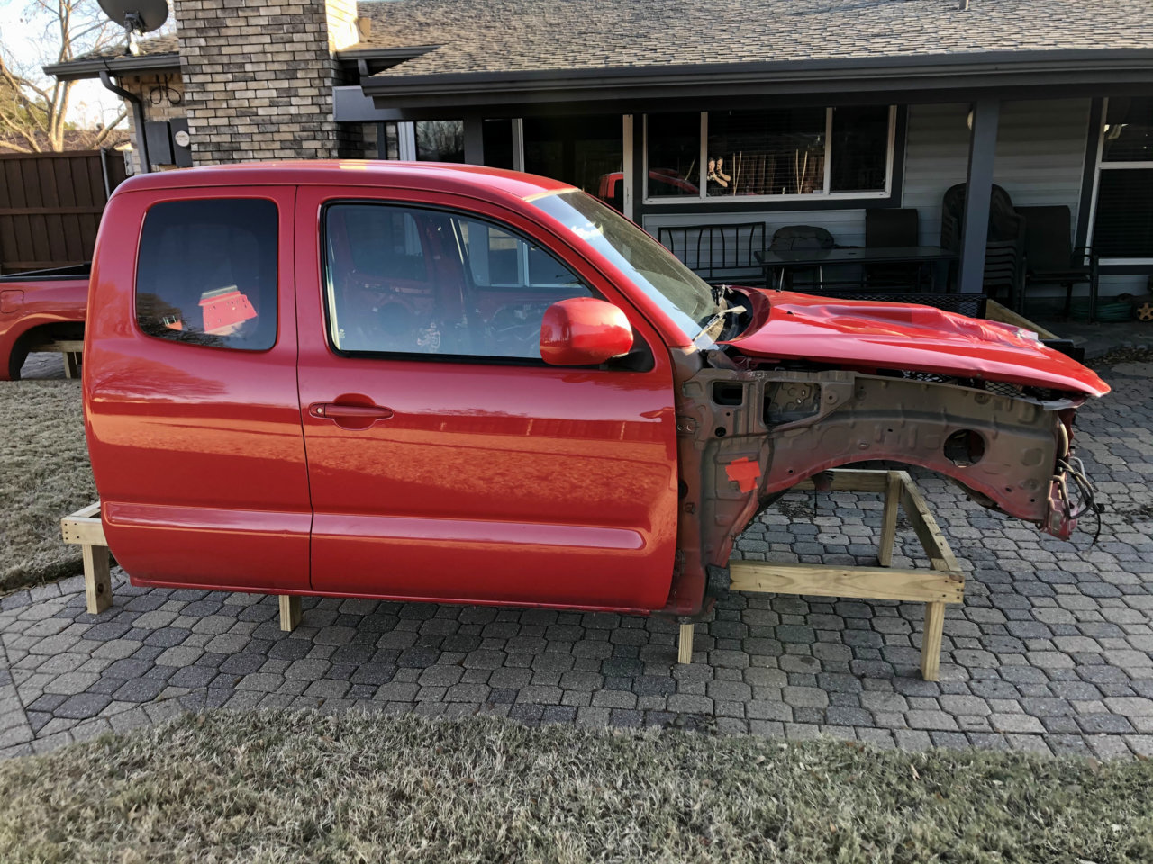

    It thought I was going to pull the cab off the chassis next weekend but my great friends pushed me into knocking it out in this great weather this weekend. It took 6 of us to lift the cab with most of the interior stripped out and the driver and passenger front doors pulled off. We lifted the cab off the chassis and carried it about 30 feet to place it on a wood platform that I built with the same dimensions as the frame (for the most part).

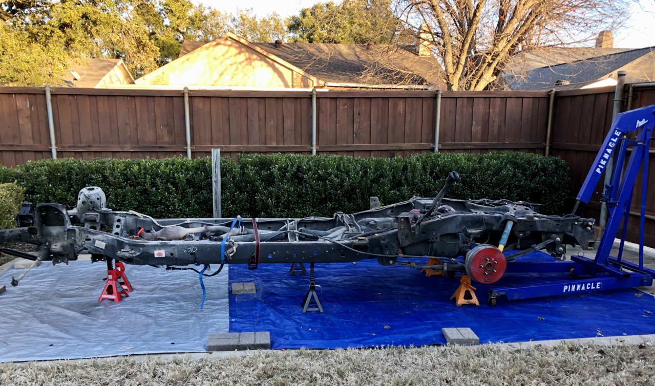

    Thanks for the positive words. It is a big project. I was able to get more stripped off the X-runner frame today ... except for the gas tank. I should be able to knock that out tomorrow. Once I get that done, I am going to start prepping the frame for the POR15 coating. Then I can start rebuilding the frame for the swap.EAE6C4B8-E355-4B7B-9937-76AB8E4FDF6B.jpg

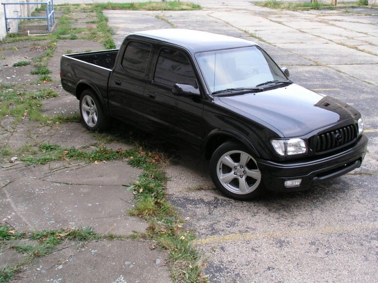

    JasonLee
    JasonLee Hello? I'm a truck.
    May 9, 2014
    #129454
    12,307
    Jason
    Q322+3C Denver, Colorado
    15 TRD OffRoad
    TRD Supercharger and more.
  15. Jan 8, 2021 at 6:22 PM
    #55
    Empty_Lord
    Empty_Lord Toyotaholic
    Mar 13, 2016
    #181186
    28,298
    Dan
    Northwest Indiana/Chicagoland
    That actually looks better than I would of guessed
    JasonLee[QUOTED] likes this.
  16. Jan 8, 2021 at 7:49 PM
    #56
    JasonLee
    May 9, 2014
    #129454
    12,307
    Jason
    15 TRD OffRoad
    Just needs a rag top and some graphics on the sides under the clearcoat.

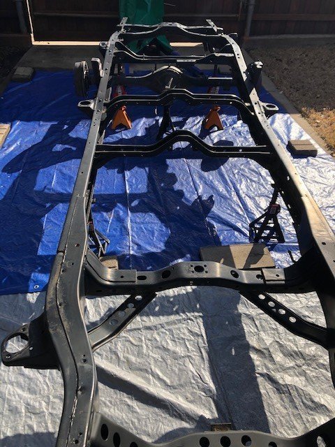

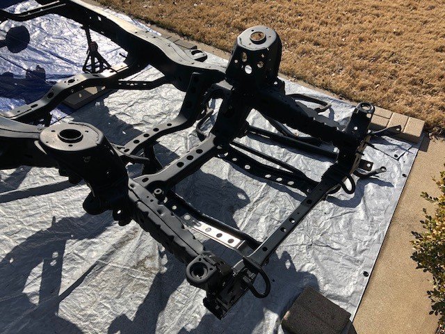

    The X-Runner frame right before it left to the powder coat. A little bit of surface rust (not bad for a 2006 chassis) but that will be all gone with the media blasting.
