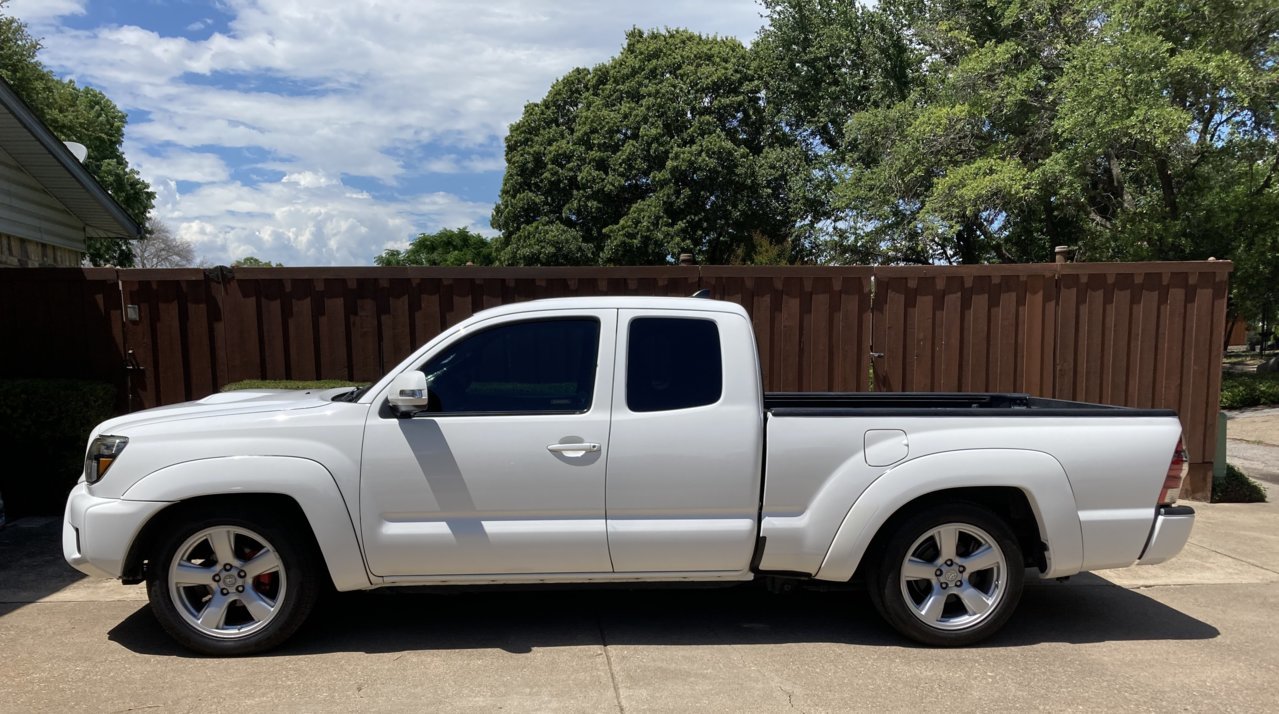

    I have been pretty busy trying to get finically caught up on the frame swap but wanted to drop a current pic of the truck.IMG_0324.jpg

    I always liked the look of the x-runners when they came out. Looks great!

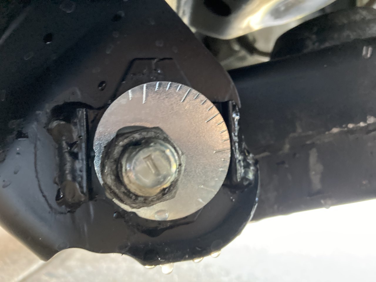

    Ran into a weird alignment problem having too much negative camber only on one side of the truck. I installed SOS performance F-1.5" / R-2" lowering kit and went to get it aligned. They told me that one side way maxed out and they couldn't get rid of the negative camber and that was all they could do. I went thru the front end and tighten everything and basically re-did the lowering install. I took the truck to another alignment shop and was told the same thing. I didn't know what to do... so I just happen to take my truck to Texas Track Works to talk about other options and if there was anything that they could do for me to help out the 1 degree more negative camber only on one side. They put my truck on the rack and within seconds knew what my problem was.... the synkro washer of the camber bolt was on top of the tab. There are metal tabs on the left and right of the cam washers to keep them in a certain area.. somehow my tabs got bent back only on one side of the truck and the camber washer slid and was on top of these tabs. I could not believe that the other 2 alignment shops didn't tell me about this, especially since they knew there was too much negative camber only on one side. Texas Track Works was able to weld my tabs back and make them strong than factory. They also replaced my camber bolts and new synkro washers. Then they did and alignment for me and everything is great and within specs again for a lowered truck. This process took a few months but I am glad I got it fixed. Apparently, this is a common thing that can happen to Tacomas. There are some pictures of the tabs after they were fixed. I wish I would have taken a picture before it was fixed.

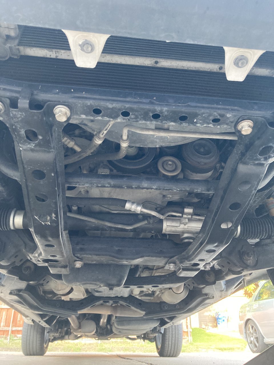

    You may notice the aluminum spacers lifting the steering rack up. While at Texas Track Works I gave them a few different size aluminum spacers to decrease the mild bump steer I was getting because I lowered the truck. When they had it on the alignment rack, they were able to measure the angle of the outer tie rod end and figure the correct spacing for me with the SOS 1.5-inch drop in the front and 1.5-inch All-Star solid aluminum blocks in the rear. They use a 1 1/2 O.D x 1/2 I.D aluminum spacer 1/4 inch tall and a 1 1/2 O.D x 1/2 I.D aluminum spacer 3/8 inch tall on each side for a total of 5/8 lift on each side of the rack... turns out this is the max that you can do without clearance problems. I bought them the spacers from Keyser Manufacturing for around $25 shipped (shipping was more than the spacers). I also had to get slightly longer bolts ( M12 - 1.25 x 140mm ) to get this all to fit. As far as I can tell this did away with my mild dump steer, very pleased.

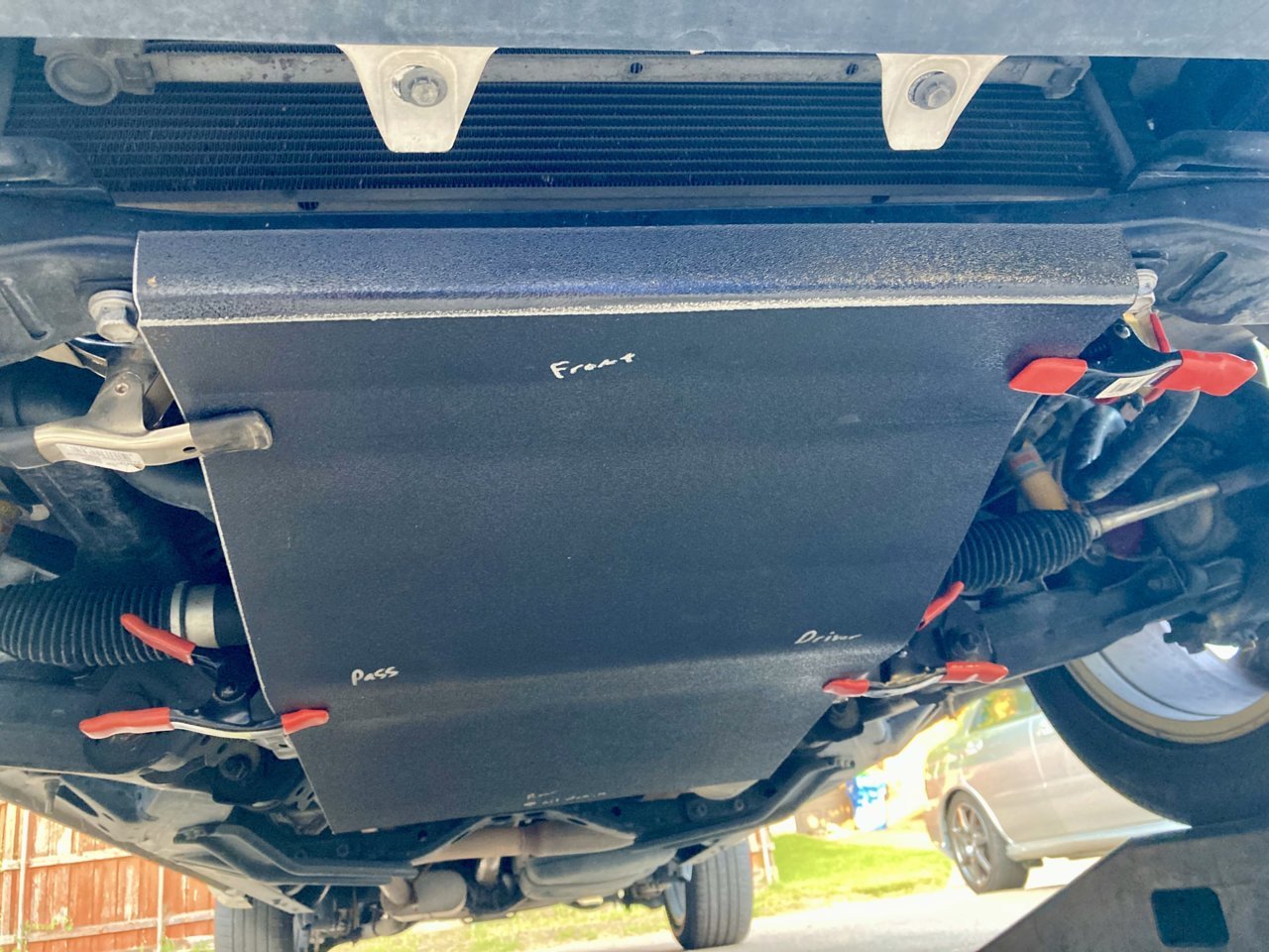

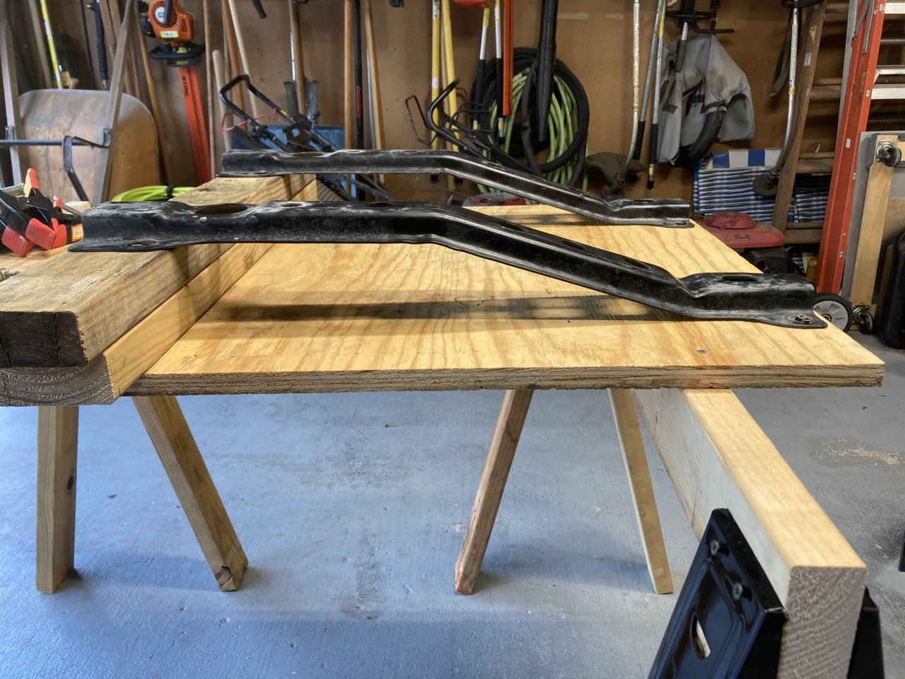

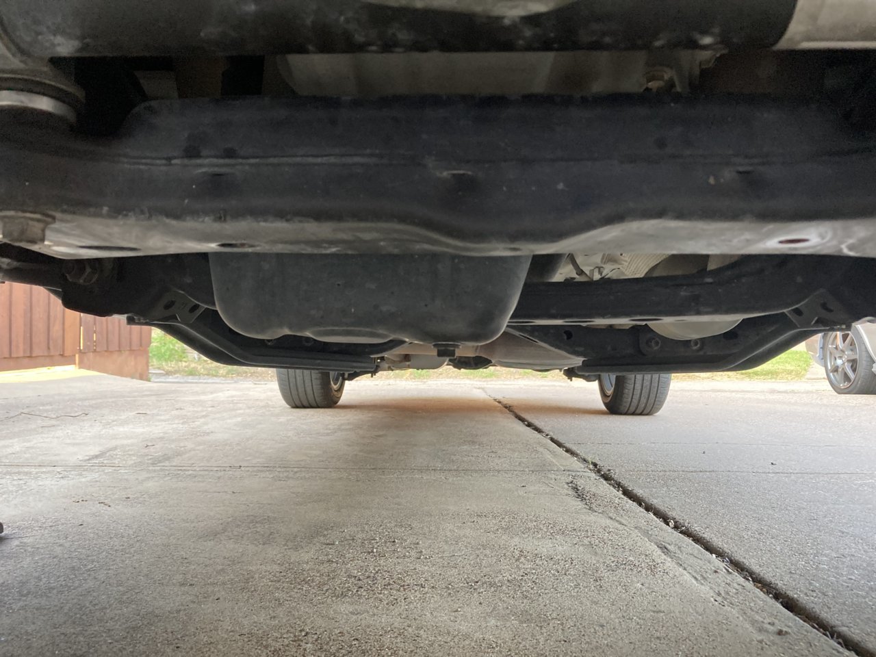

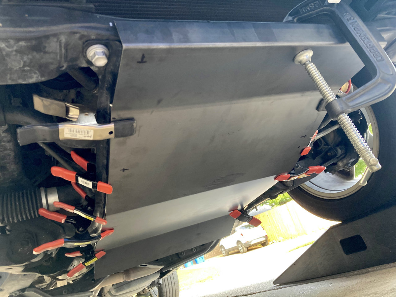

    The next thing that I have done to the truck is create a custom belly pan (skid plate) because I was having trouble finding one for this X-Runner frame. Keep in mind, that I have the 4.0L automatic mounted to this X-Runner frame and my oil pan hangs lower than the standard manual X-Runner. This was really worrying me about hitting something in the road and damaging stuff. IMG_0298.jpgIMG_0300.jpg

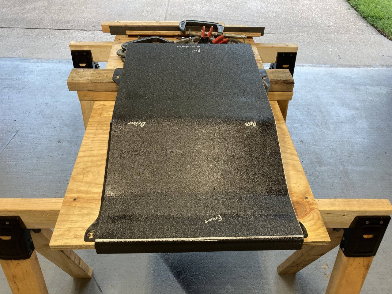

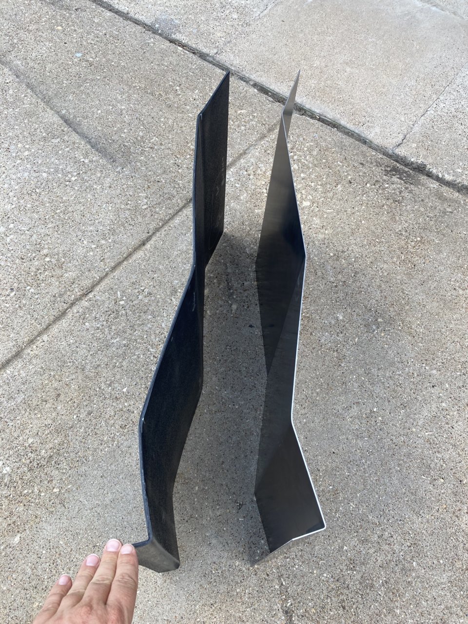

    Not to bore everyone but I bought a sheet of ABS plastic and spent time heating it and bending it to the shape that I wanted it. I did this so I would have a template to take to a metal guy and have him put the breakers in the correct spots and at the right angles.IMG_0292.jpg IMG_0293.jpg IMG_0303.jpg

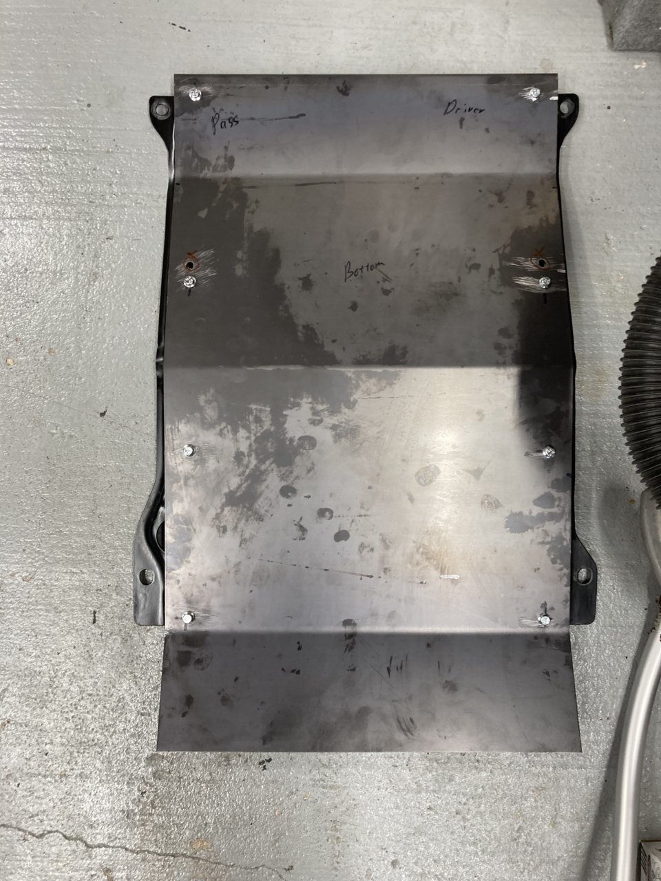

    My metal guy was too busy at the time, so I took my template to a place that sells metal and has some large break machines. They were able to put the beakers into the 14 gauge steel plate that I bought from them.IMG_0370.jpg IMG_0373.jpg

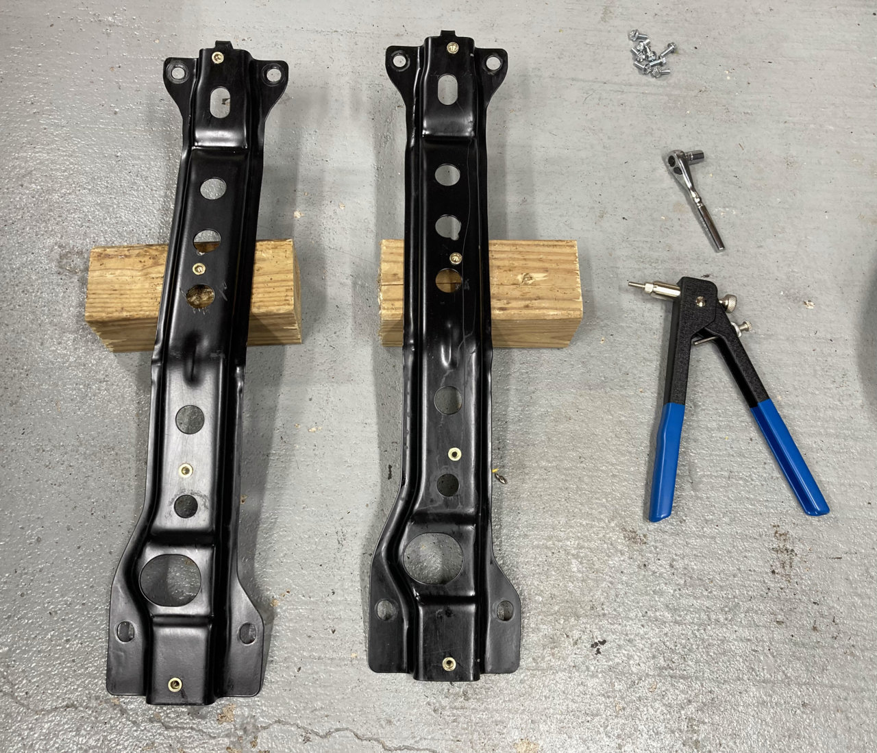

    Then I used clamps to hold the metal into place and drill my pilot holds for where I wanted the screws to go. I drilled the X-Runner braces with smaller holes to fit the M6 threaded hand rivets that I used to thread the bolts into and hold the belly pan into place. I used 4 threaded rivets per side. So when I need to remove the belly pan... I just have to remove a total of 8 bolts.IMG_0376.jpg IMG_0378.jpg
