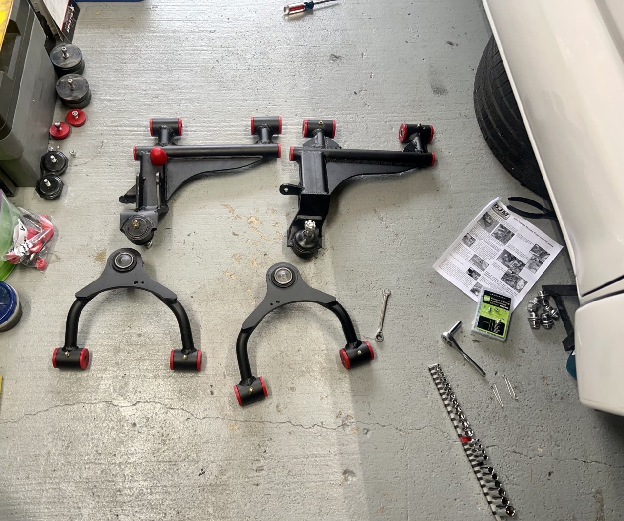

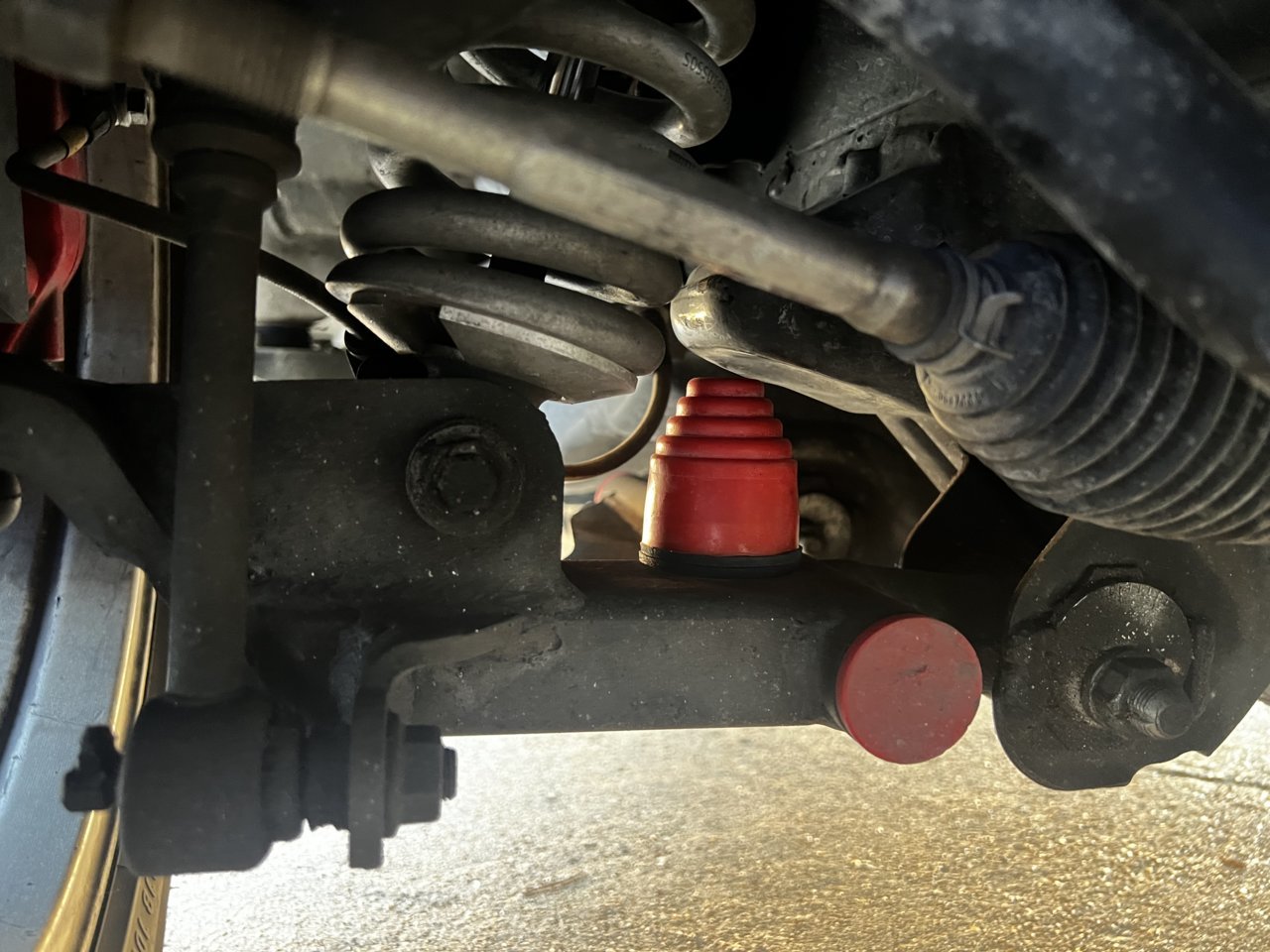

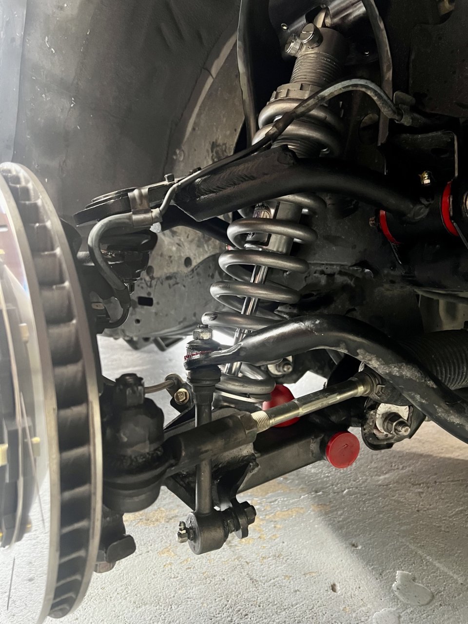

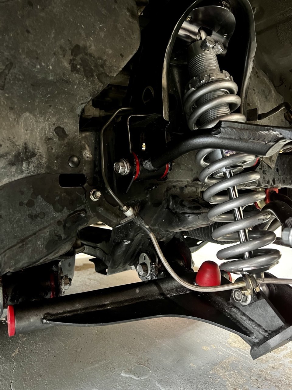

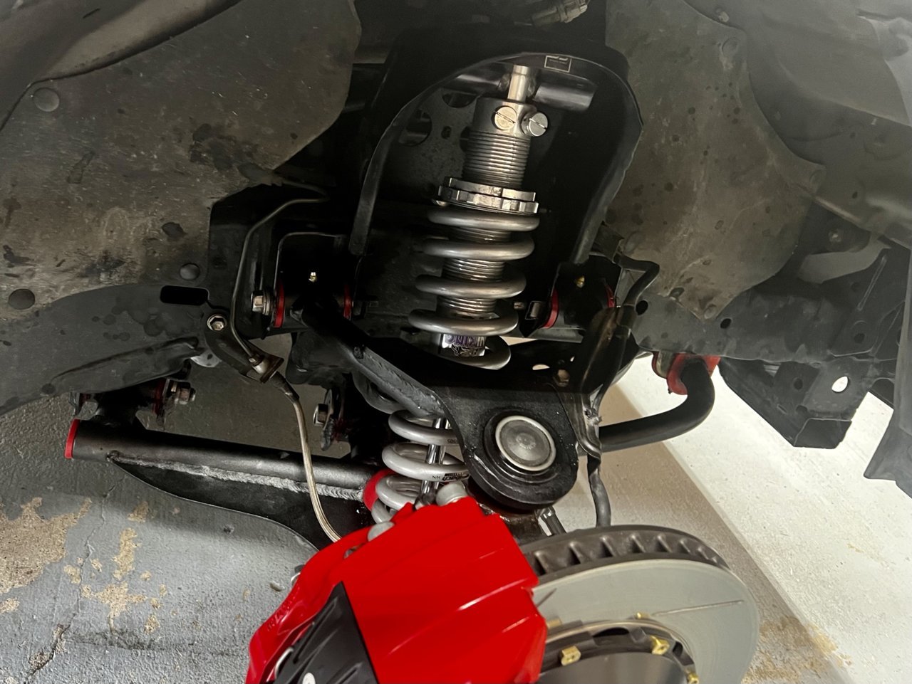

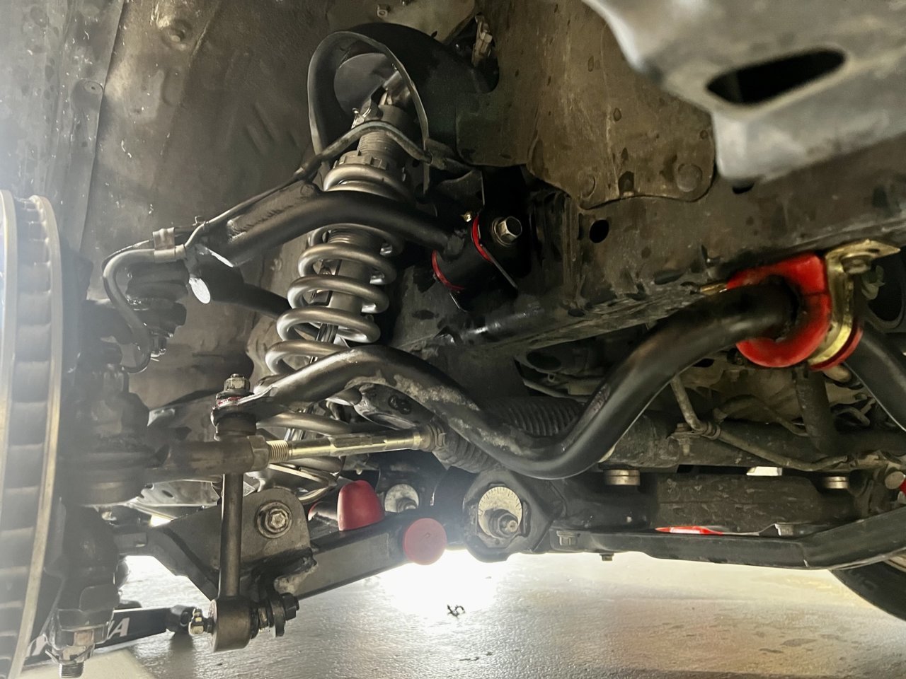

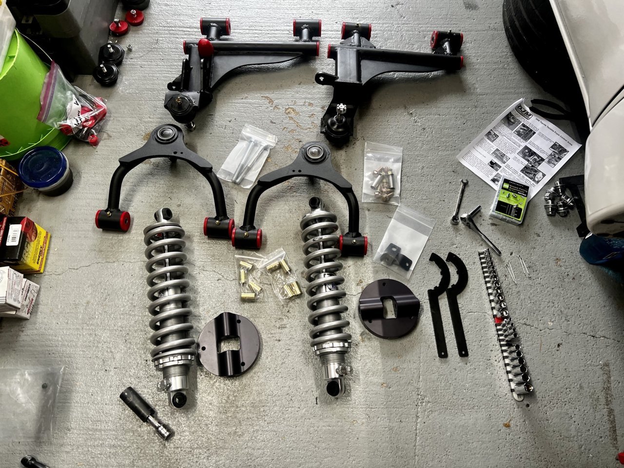

    I had the SOS Performance 5 Lug 1.5-inch front lowering kit on the Tacoma but wanted the truck a little bit lower but not DJM kit 3 inches lowered (DJM2816-3/3)… somewhere between plus I would like to soften the ride up a bit since it is a daily driver. So, I am using the DJM upper and lower control arms to drop the truck 3 inches and keep it closer to alignment specs but using the coilovers to raise the truck about ¾ of an inch and soften the ride by using a 550-pound rated spring instead of the factory X-Runner 650 lbs/in with a length of 8.00 inches rated spring (per my research online). This should put me at about 2 ¼ inches lower than factory X-Runner height but I have the ability to fine tune my adjustment of height as needed and the ability to control the shock damping per the double adjustability of the Viking C210 Warrior coilovers (eye/poly to eye/poly)(sold individually). Ride Height 13 3/4 to 15 inches. Compressed height 11.47 inches. Extended Height 17.22 inches. Stroke at 5.75 inches. My target ride height from shock bolt to shock bolt is 15 inches. I also purchased the Viking 7995-102 which comes with 2 thrust bearings, 4 stainless steel washers and a set of spanner wrenches (for a pair of coilovers). I also purchased the Viking 7904-101 which comes with the spring cap, spring nut, lock nut, and washer (per side). I am using the Eibach Spring 2.50 inch I.D 1200.250.05505 which is 550-pound rated spring (12 inch long spring and 2.50 inner diameter). I am using the Strictly Street coilover mounts to bolt everything to the factory location without doing any modification or drilling. These adaptors are about 5 1/4 in diameter and the shock opening in the center is about 1 1/4 inch wide. The Viking Coilovers fit perfect in the Strictly Street mounts with no play but the DJM lower control arms are 1 1/2 wide where the shock goes into place and the Viking C210 shock eye/poly is 1 1/4 wide, so I had to use a washer on either side of the Viking the shocks to make them fit snug the the top.

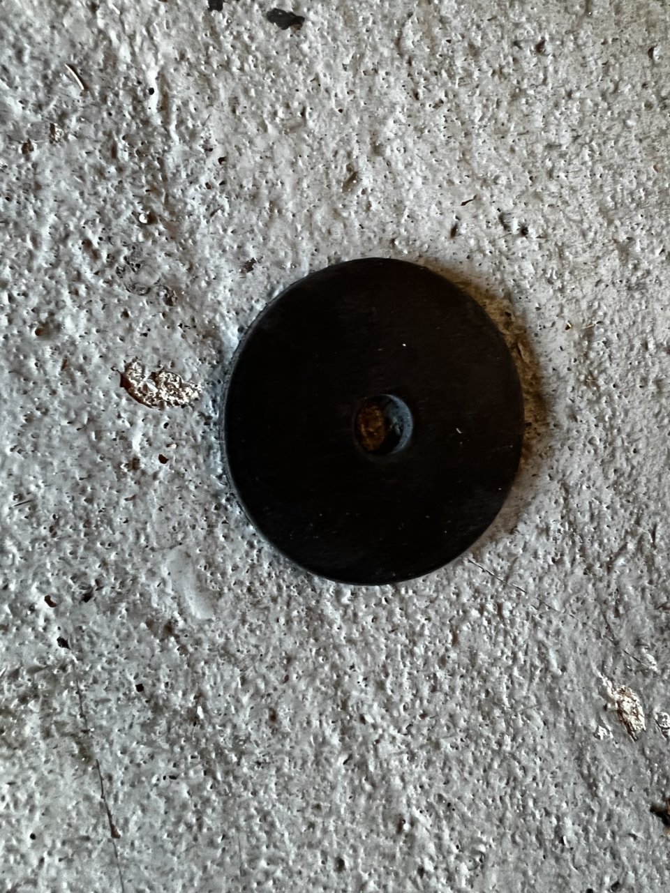

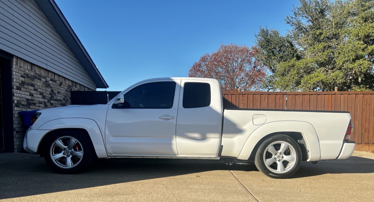

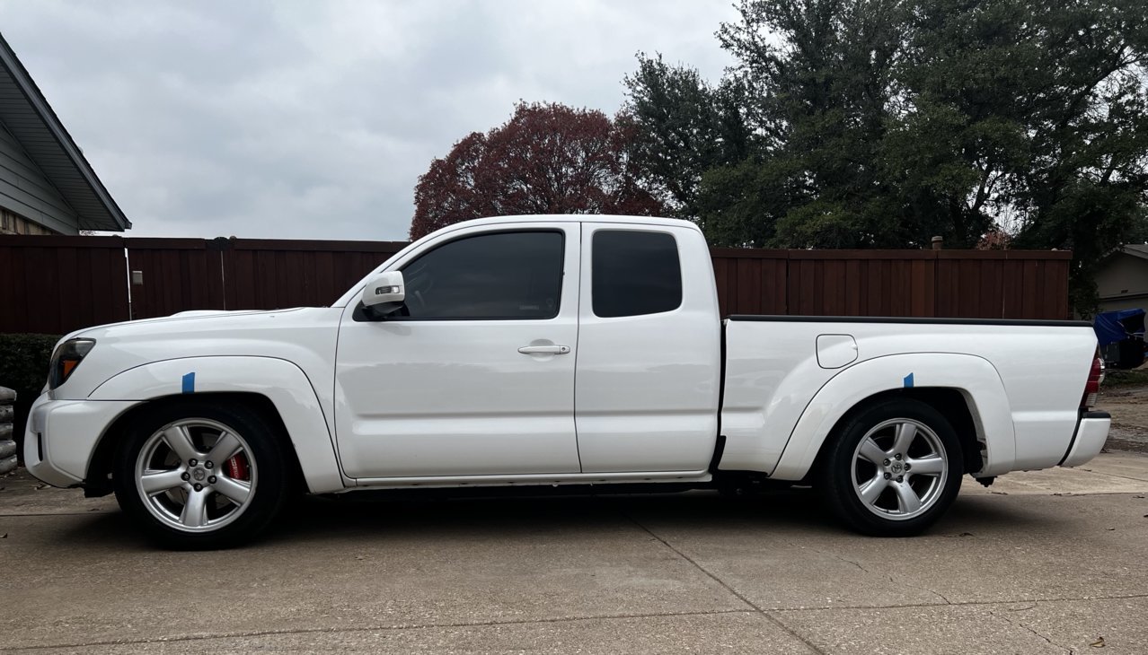

    This is a picture of the truck with the SOS Performance 5 Lug 1.5-inch front lowering kit before the coilovers go on. I have the blue tape as reference points of measurement before changing anything. I also have a few reference points from the Tacoma’s frame so that I can use these to adjust the coilovers to my target height of 2 ¼ inches lower than factory X-runner height.

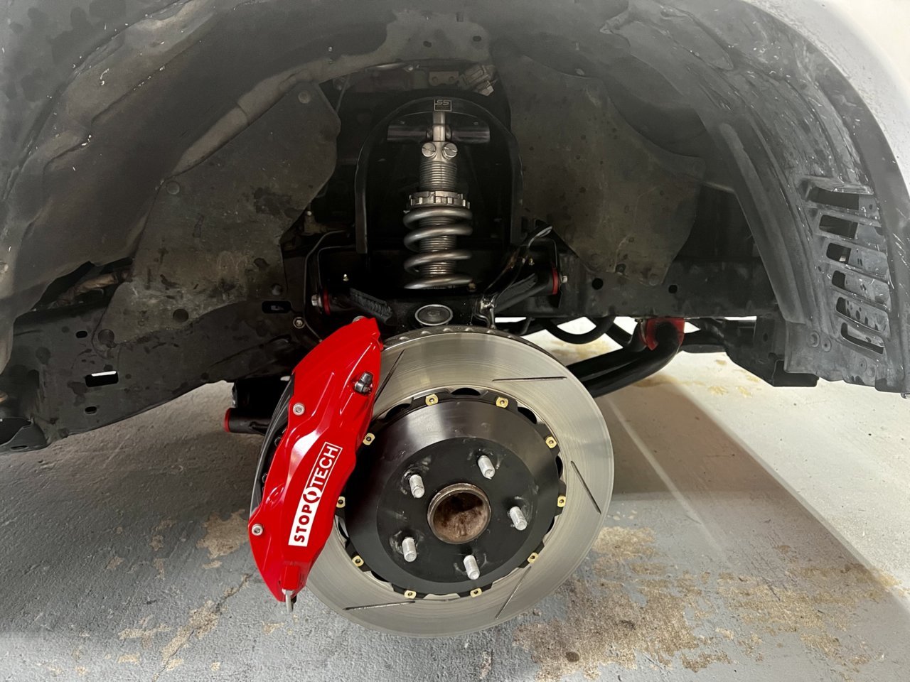

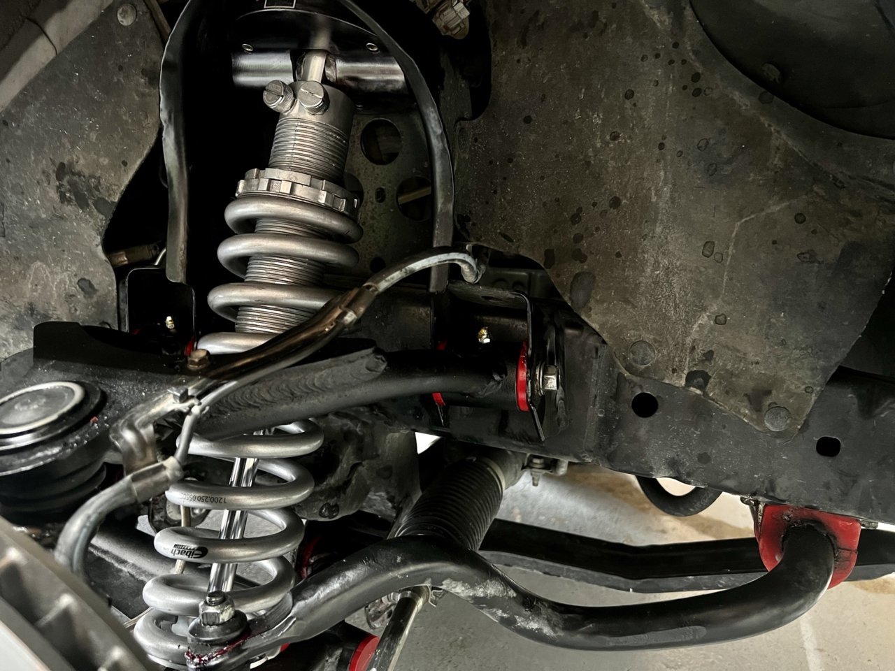

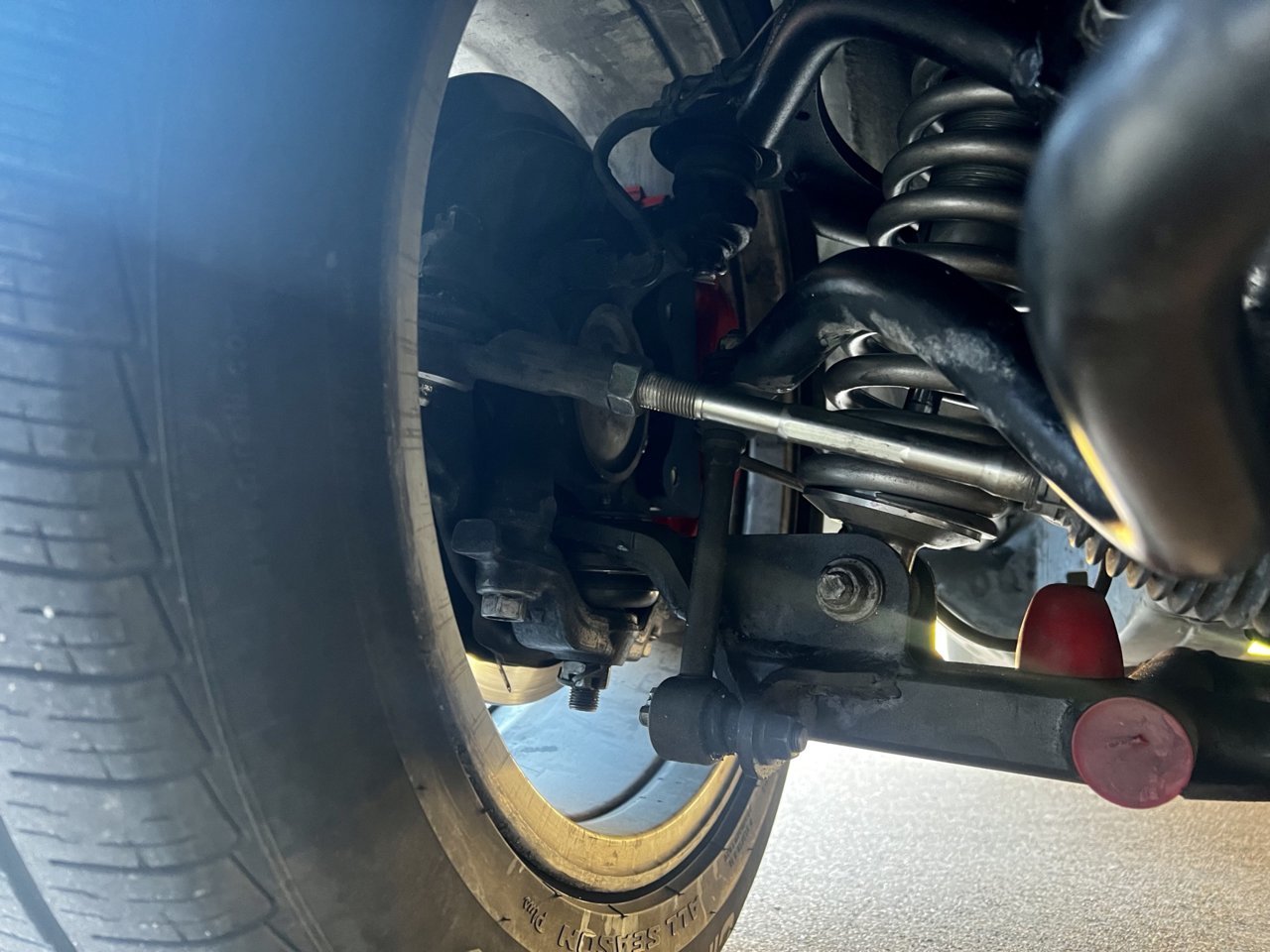

    Getting started… you can see in the background the SOS Performance 5 Lug 1.5-inch front lowering kit which is an adaptor that is added to the factory X-Runner shock perch to low the spring which lowers the truck 1.5-inches.

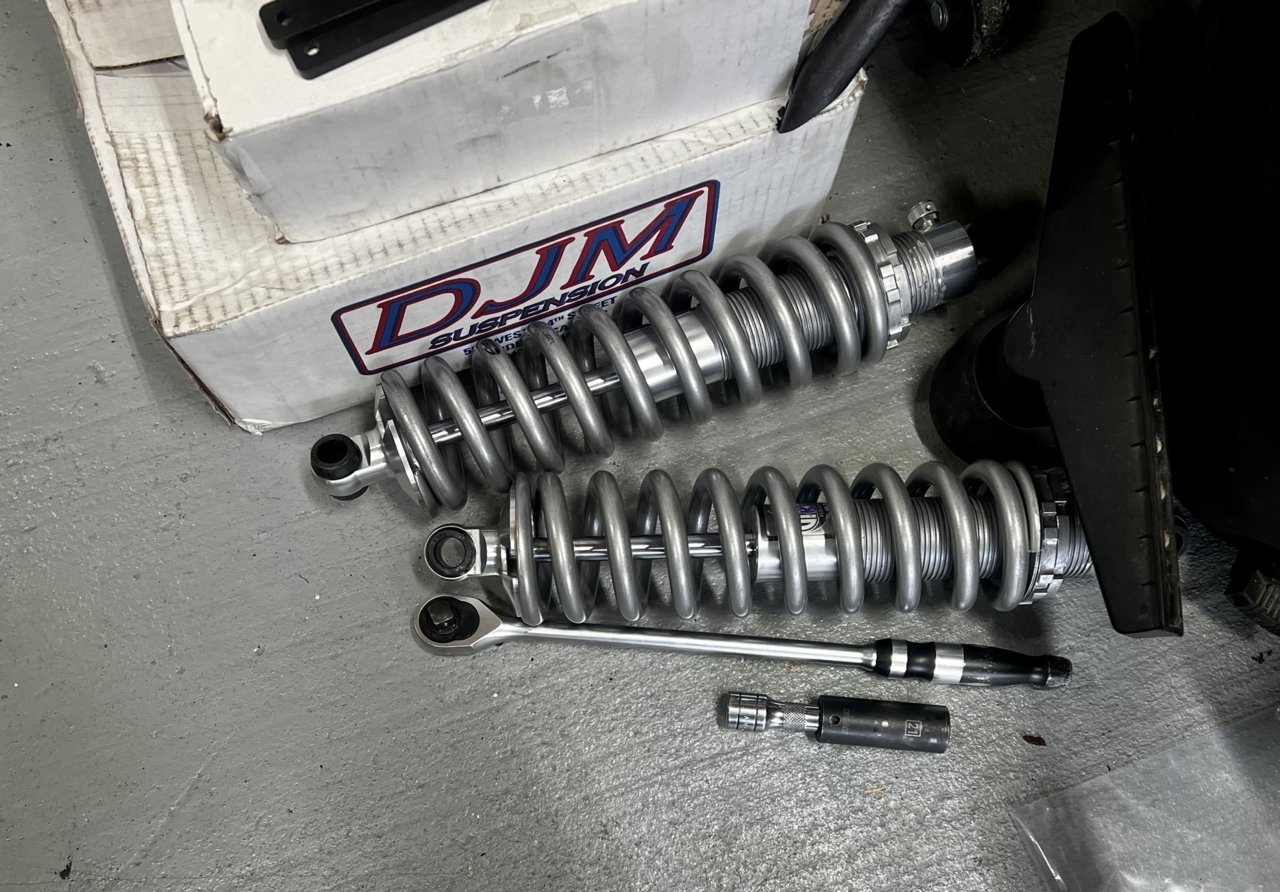

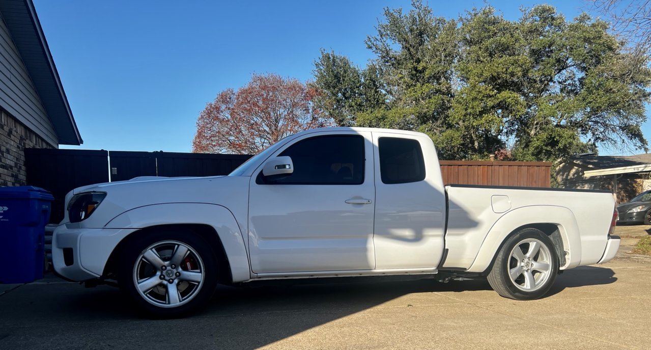

    I went to Texas Track Works to get the alignment done and everything went smoothly. The front end didn't give them any problems doing my alignment. Sweet.

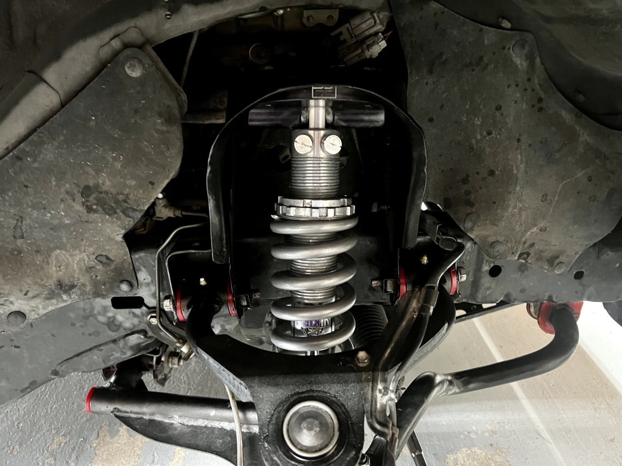

    I have been playing around with the 2 way adjustable Viking shocks to find my favor setting. It is pretty easy to do. On the front end, I just jack up the front end and reach in-between the top of the tire and the fender well to adjust the knobs. Then lower it back down and drive it for a day or two before trying another setting. Currently, my favorite setting is 3 clicks on compression and 7 clicks on rebound on the front and 2 clicks on compression and 5 clicks on rebound for the rear.
    Update on adjustable shock setting.. I have been currently running C3 R8 for the front and C2 R7 for the rear. I think this is a much better setting for me after many miles and many adjustments over the year plus time that they have been on my truck. I think I was getting too much spring bounce in the previous setting and needed to stiffen up the shock more to control the spring and it rides much smoother now.

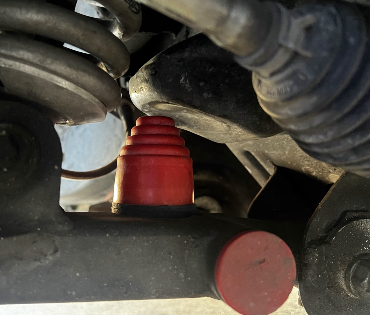

    I am happy with the height right now. I like the look of the stance but my front tires do rub on the top of the wheel wells a little bit on extreme bumps or angles (a few times a week) with the DJM provided bump stops on the lower a-arms. I think I am getting too much travel on the a-arms in these cases and need more bump stop height to stop this. I don't want too much bump stop height where I am bottoming out all the time or sitting on the bump stop to prevent this travel. I have tried about a dozen or so different bump stops and combinations with spacers. DJM's lower a-arm uses a 3/8 stud for their bump stop, so finding other bump stops to fit this thread without modification is pretty easy from what I have found. Right now, my favor setup is an Energy Suspension 9.9101G bump stop which is 2 1/8 inch diameter and 2 inch in height with 2 rubber 1/8 inch washers ... so total height is 2 1/4 inch. This does go on pretty tight if the suspension is hanging while the frame is jacked and tire removed but you have to spin the coilover spring to the right spot for the bump stop to thread into the lower a-arm. As far as I can tell right now.. this gives me enough travel but stops or slows the reflection of the suspension down enough to prove the rubbing. Still testing but happy so far.IMG_1564.jpg IMG_1571.jpg IMG_1569.jpg IMG_1570.jpg
