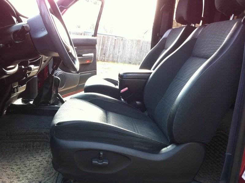

    Sorry 'bout the delay. The seats are Hyper-Auto i think (which went out of business or something) racing buckets that cost $300 for the pair. For install, all I did was drill out the rivets on my stock seats, bolt them back in and welded flat iron to them to make the brackets. Then all ya gotta do is bolt on the sliders that came with the seats. Fairly easy install, and well worth it! Next project is to install the 01-04 center console! ;)
    Try ebay... they've got tons!

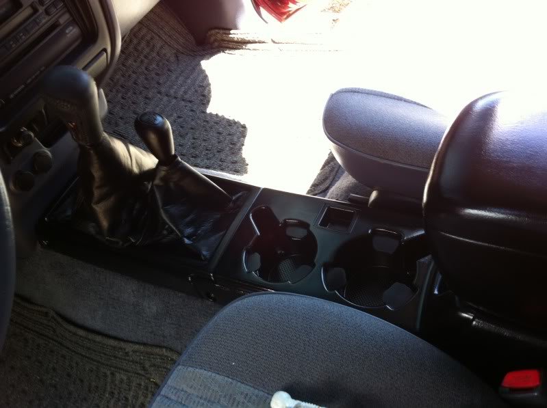

    meh... I have little issue with my lousy sq. cup holders...
    But curious... did you paint that console black ?
    How long will it stay looking like it does ?
    what color was original ? gray ?
    years back I tried vinyl painting a car interior...
    looked great ! for about a month...
    until it got marred up a little...
    then it began to look like shit.
    so do they sell tougher vinyl paint now a days ?
    or did you use something else ? flex additive ?

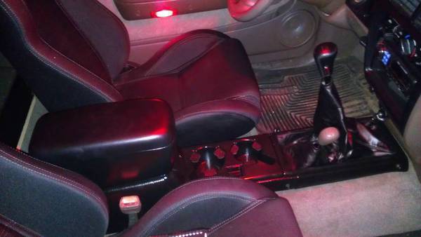

    Yes. I dyed the vinyl part of the console and primed/painted the plastic components
    It still looks like the day I painted/dyed it. And that was spring. I'd imagine it will look brand new for a couple of years before needing touch up.
    I used Duplicolor vinyl/fabric dye for the vinyl. And Rustoleum Ultra primer and paint for the plastic. I used a Duplicolor prep wipe for both prior to painting/priming/dyeing.

    I DID IT!!! Used paint and dye on 01 center console! No more square cup holders!!! :woot: :woot:
    Thanks again, Madjik_Man!
