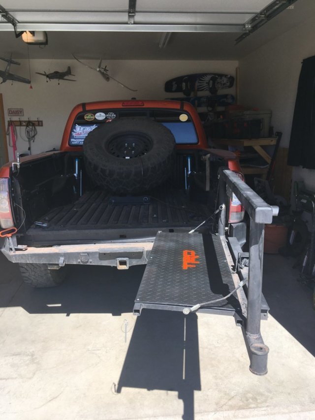

    The tire hinges up to gain access to more storage under the front of it.

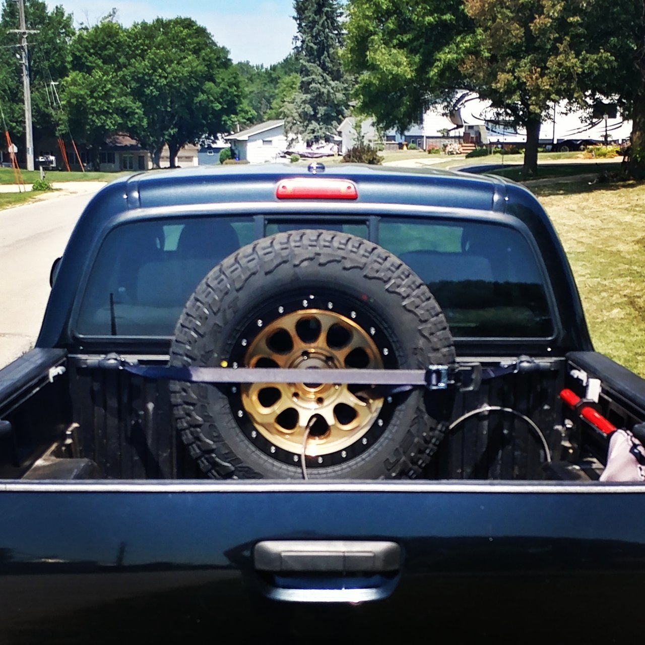

    #174488
    251
    Eric
    Iowa
    2009 TRD Sport, Free & Clear
    2" lift, SCS Ray 10, Falken Wildpeak's

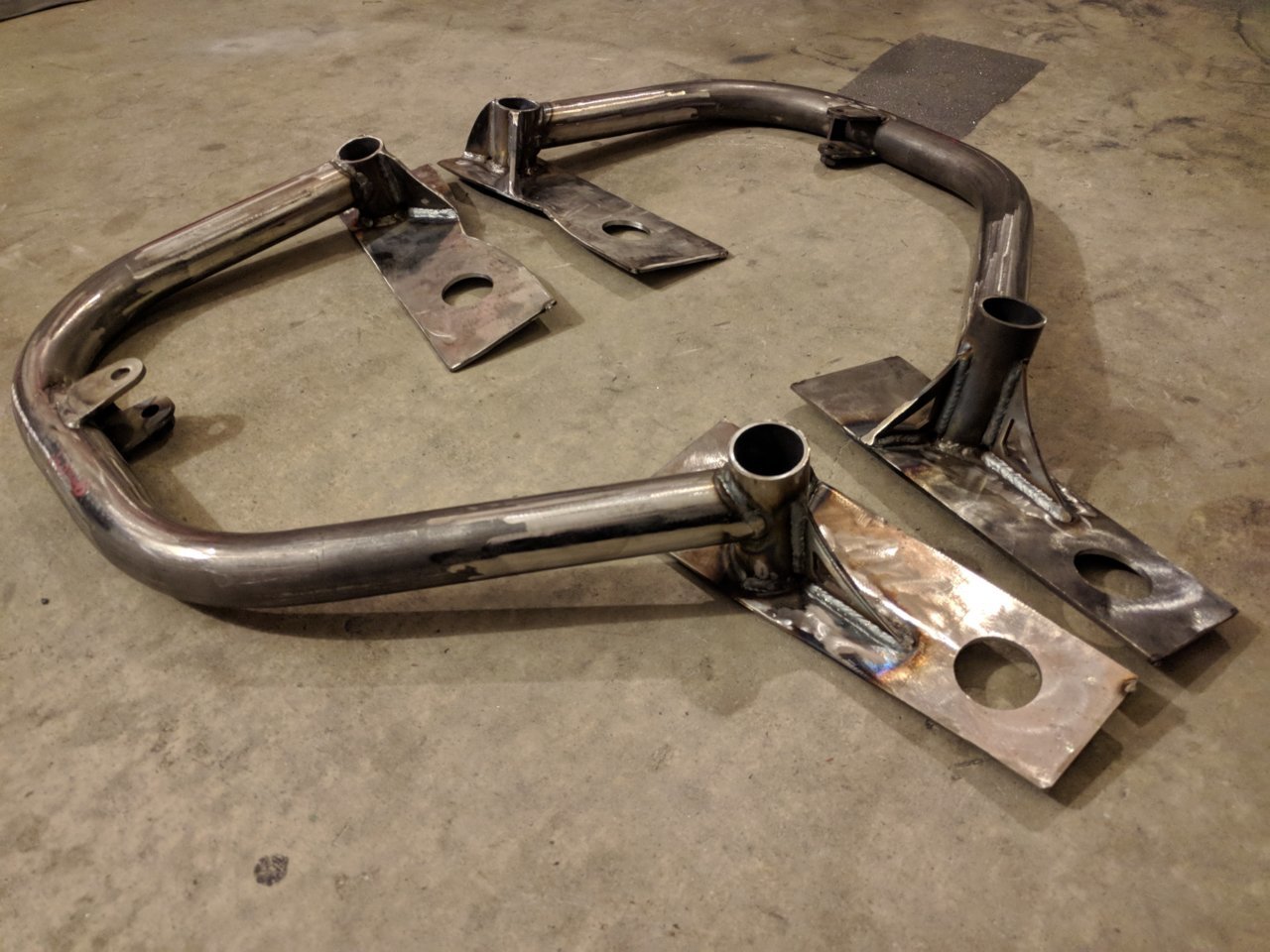

    what I have:
    it's not fabbed perfectly, but it was a trial run for a buddy and I got it for material cost lol. freed up lots of bed space vs. having it lay flat in the bed. this is a 35 btw.
